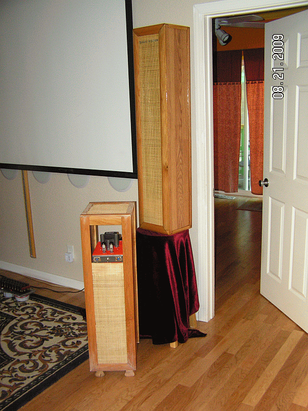

Meanwhile, making wooden body, to match speakers. The same palm tree grill, the same hardwood look...

I don't like this hole. May be it is a good idea to cover it by painted Lexan with small windows in front of indicators?
