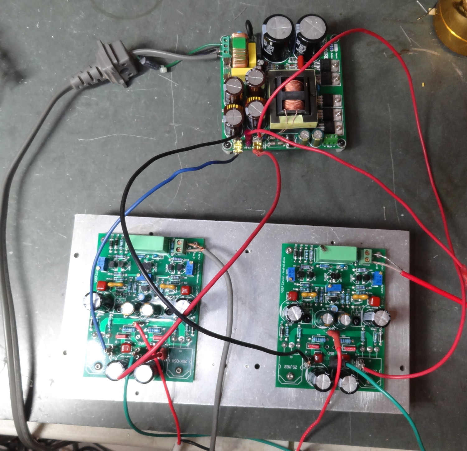

Hi Guys,
It is alive and well! My parts finally arrived so I was able to complete it. I brought it up on the Variac through a light bulb limiter and was able to set the VAS to 160mV across R14 and then set the bias to 160mA through an ammeter on the rails. Once everything was set and looking good I hooked up the SMPS to make sure everything would still be happy. All looked good so I hooked up some test speakers and played some music through it. Once satisfied I hooked it up to my main A/B setup so I could compare it to Pete's VSSA. Absolutely identical to the ear. I had two other people listen and neither could hear any difference. I'd say the SMPS is a keeper. Oh, did I mention how killer the VSSA sounds. :D
A pic attached, Don't mind the rats nest. That will get tidied up later. Right now I'm enjoying listening to it. :D
Blessings, Terry

Setting the VAS is the most time consuming. I used three multimeters. One set as an ammeter on the rail, another across R14 and the other on the output. I used two screwdrivers and watched the two voltmeters. It felt like driving a slip-turn. :)
I just turned down the bias to 120mA. The heatsink I have the two boards mounted got too hot with it at 160mA. I can't really hear any difference with it set cooler. I'm going to let it play most of the day today so the caps can set in. Another keeper. The Ovation nx is next. Another CFA. ;)
It's hard to see in the picture. You provided two places to attach ground. I used the one between the two rail lugs. If you look closely you can see a green wire attaching there. Those green wires go to a star ground out of the picture where the speaker grounds attach as well as the ground from the SMPS. I just use a group of spade connectors as a star for my testing. Once in a case they will all return to a bolt with a bridge ground loop breaker to the earth ground.
