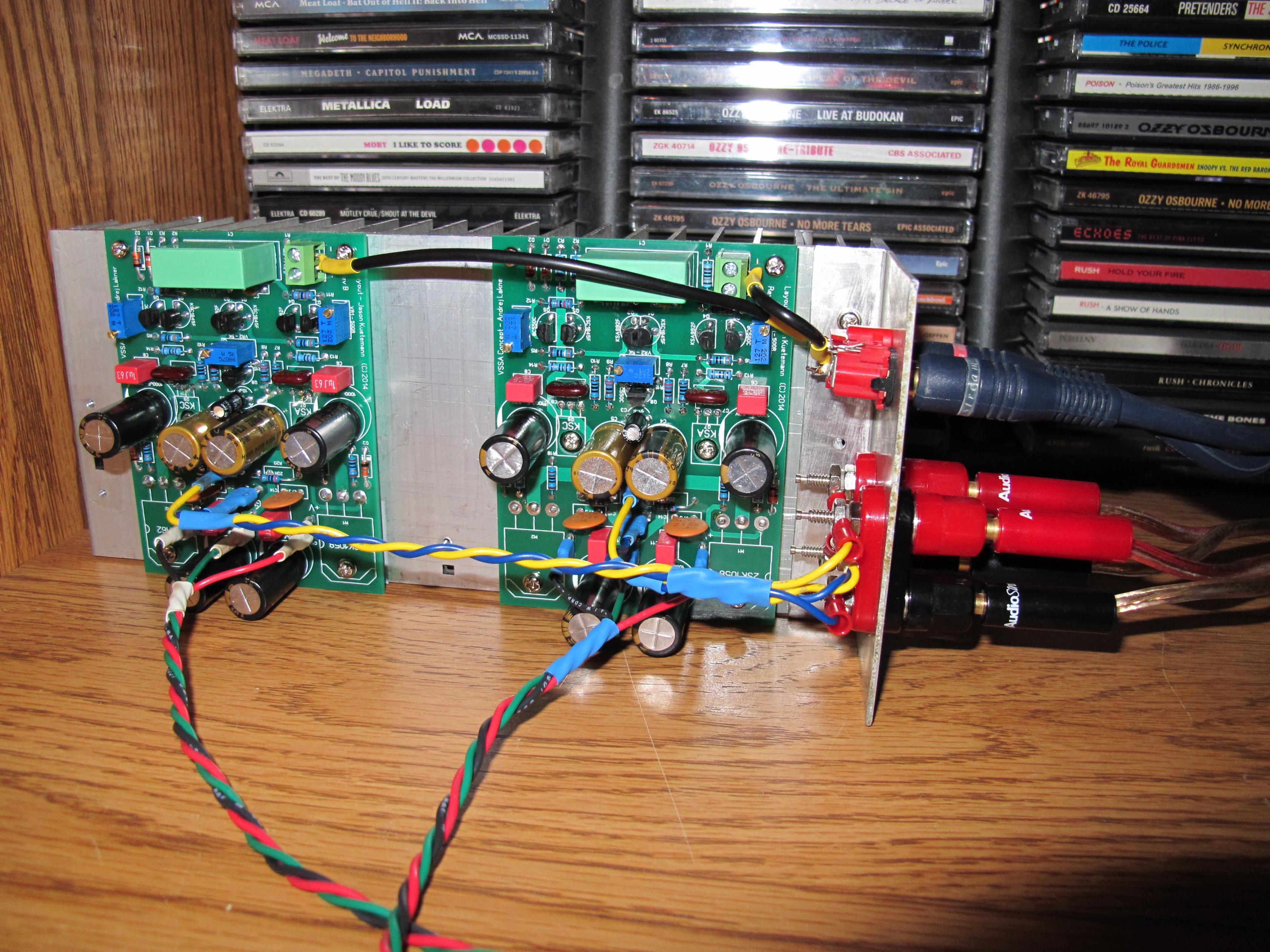

OK folks, I just had a truly proper listen to my latest version of the VSSA and am quite pleased with it. I'd suggest that no one get stressed about the 2Q CCS, it sounds just fine. If a 1Q+LED CCS is truly superior then that can be left for a future revision. A pic attached of the stereo 'test rig'. It is just running on a CRC supply, not pictured.
For those with these boards my recommendation is just to build them to the published schematic that goes with this variant to ensure they work first shot. If you so desire, tweak them later. Hope to hear of a few more reaching their marks soon.

Looks good Jason. I'm just waiting on some caps and trimmers and mine will be done. Mounted them on a heatsink today. Looking forward to the listening test. In honor of this build I listened to both VSSA's today, yours and Pete's. They are virtuously identical in sound. They are both powered by identical power supplies. I'm planning to power this with a Connex SMPS to see if I can hear a difference. Can't wait.

How did you find working with these boards? They seem to solder up nice and don't seem overly tight to me. I'll assume you got everything lined up fairly easily. Just looking even for some basic feedback on ease of construction for now.
I think they are nice. The only thing I thought might be better would be larger solder pads for the FASTON connectors. Why is your input cap so big? Most of the other versions used a smallish electro.
Good feedback. The size of cap is a holdover from caps I had on hand and I just stayed with that size. I should make for alternative spacings to accommodate different capacitor choices. I'm sure there is nothing wrong with an electrolytic, but I seem to migrate towards film.

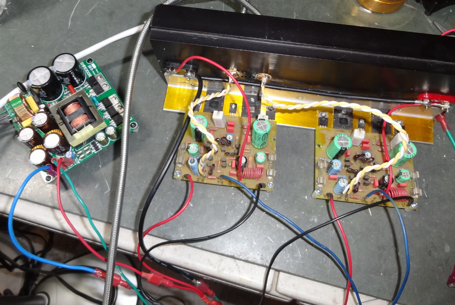

My parts didn't come today so I took some time to play around with the SMPS. I hooked it up to an old Symasym I had laying around. Wow, it sounds stellar. I even A/B'd it against my other Symasym as well as the two VSSA's I have completed. I could not hear a difference. I'm not sure how it measures but it is very, very nice. The SMPS is 4" x 4" x 2" and weighs 9oz. I have a feeling there are going to be more of these in my future amps. I may even retrofit a few of the ones I have. For $70 shipped, you can't build a conventional PSU.

Hi Terry
Can you tell me more about this particular SMPS? Is it one from Connexelectronic? I'm considering one to power a high power version of the TGM8 I'm about to build.
Very cool Terry. I decided to put one on order myself. I opted for an SMPS500R with +/-45V rails. Good to hear a good review for the PSU and there is no beating the price either.
