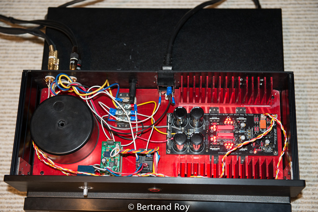

Hi Jason,
Thank you so much for taking the time to explain that! My lightbulb dimmer is now a notch up!
Thank you also for taking the time to check into a new order and colours. I put in a picture of my DCB1. I also anodized the aluminium. In my opinion, red and black look great. I'm having an Optix cover made tonight at a friend's. He has a home laser CNC...
Thanks again.
Bertrand

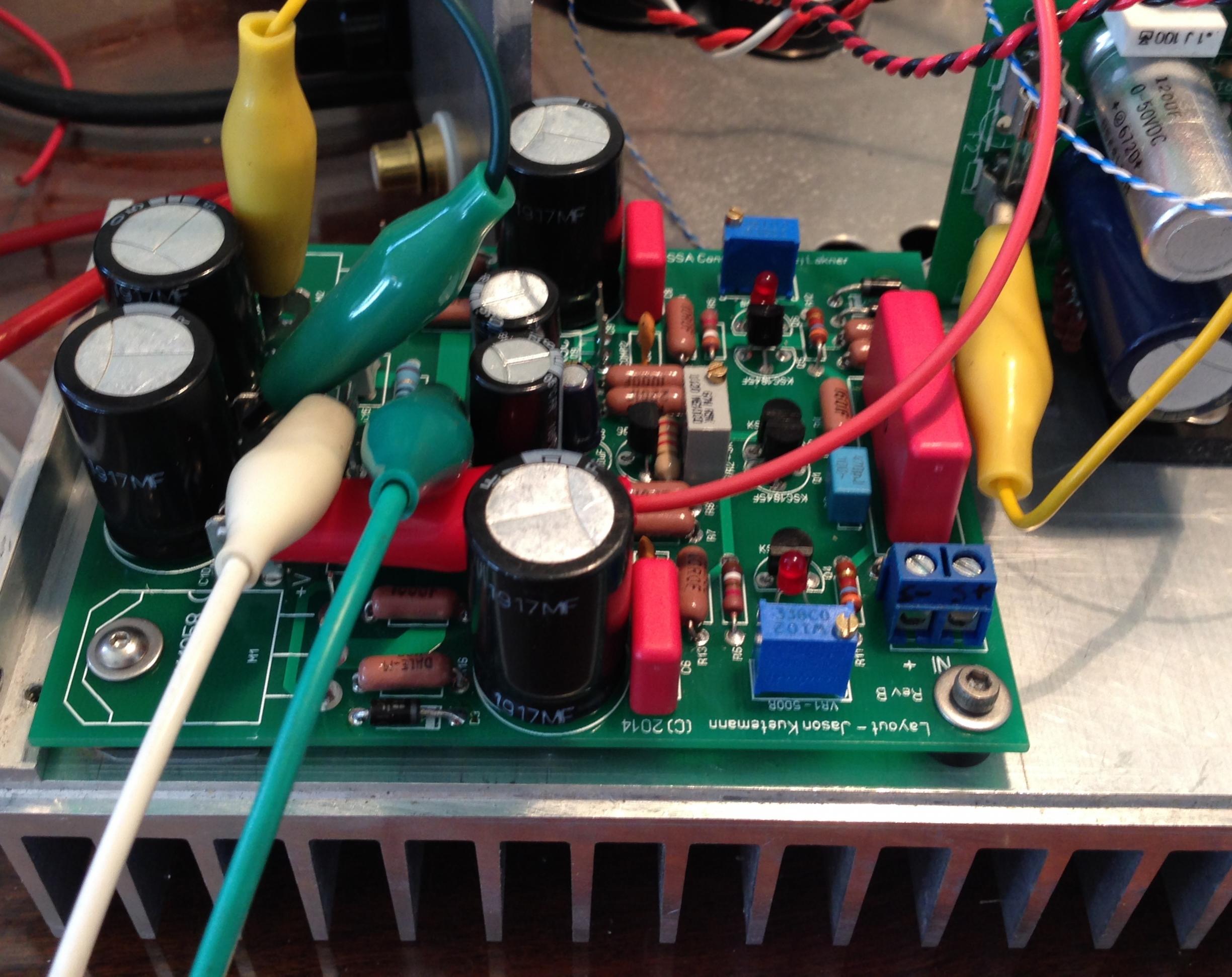

Got the boards assembled and one mounted and adjusted. I substituted a standard red LED for Q3,6 (MV50640). Solders right into the PCB, across the emitter/collector position for Q3,4. For the LED, a standard red is best, as it has the lowest dynamic resistance for LEDs, of about 4R. The LED drops about 1.8v, so VR1,3 should be 1k. I used 3.6k for R11,12 to get about 9mA current in the LEDs for a 36V supply. This current level gets the LED well into its linear impedance range.
Took me a bit to get all the bias levels lined up and offset within the low single digit mV range. Offset wanders a bit within that range during warm-up, but bias is quite stable.
Nice work Jason.
Thanks for the feedback. Though it wasn't intentionally set up for alternative CCS arrangements it is nice to see how easily is can be adapted without hacking up the board.
I'll be curious to get you listening impressions once you have them hooked up.
