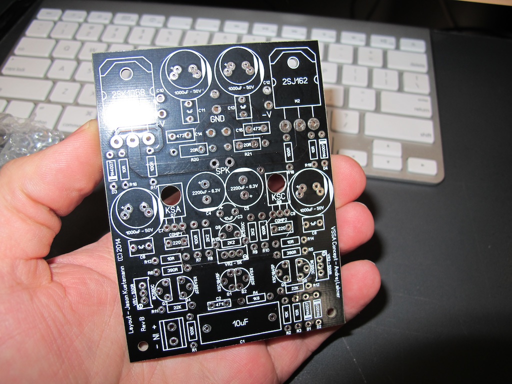

By special request...
No changes to the layout, just ordered in black solder mask and 2oz copper. Cost ended up somewhat higher with these options, just high enough for the Canadian government to want to wet their beaks too with duty 🙁.
Pretty slick looking too me though 😎.
I should mention that these are essentially spoken for unless the prospective buyers back out or reduce quantity requested. That said should I do a proper group buy on the existing design? Any opinions?

I wouldn't mind if it were wider ... well, don't mind me 😛
I actually chose the dimensions because I was being cheap with presensitized boards - I could do a stereo pair on one 6"x4" board - and just stuck with that. The narrow board has the advantage of being able to go multi-channel on one heat sink, which was another consideration. Future plans will hopefully keep the same overall dimensions but will move some parts around.

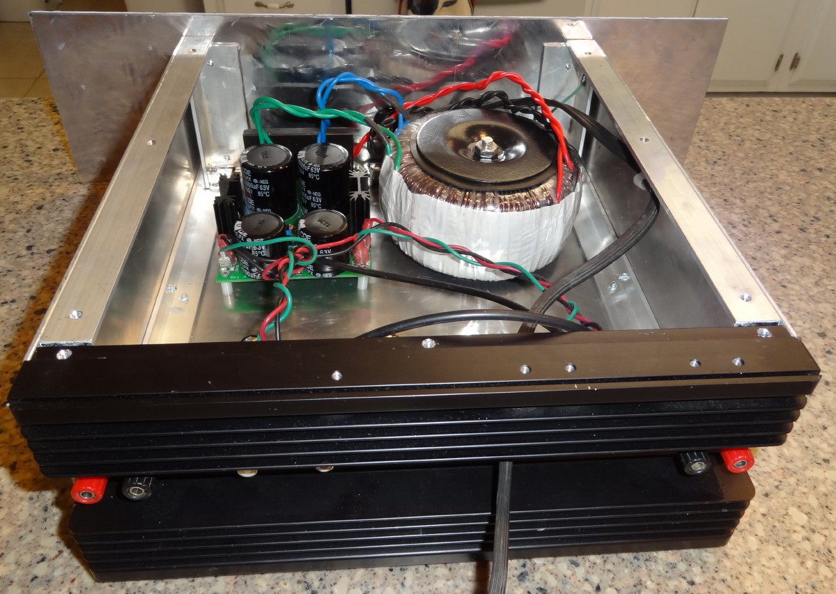

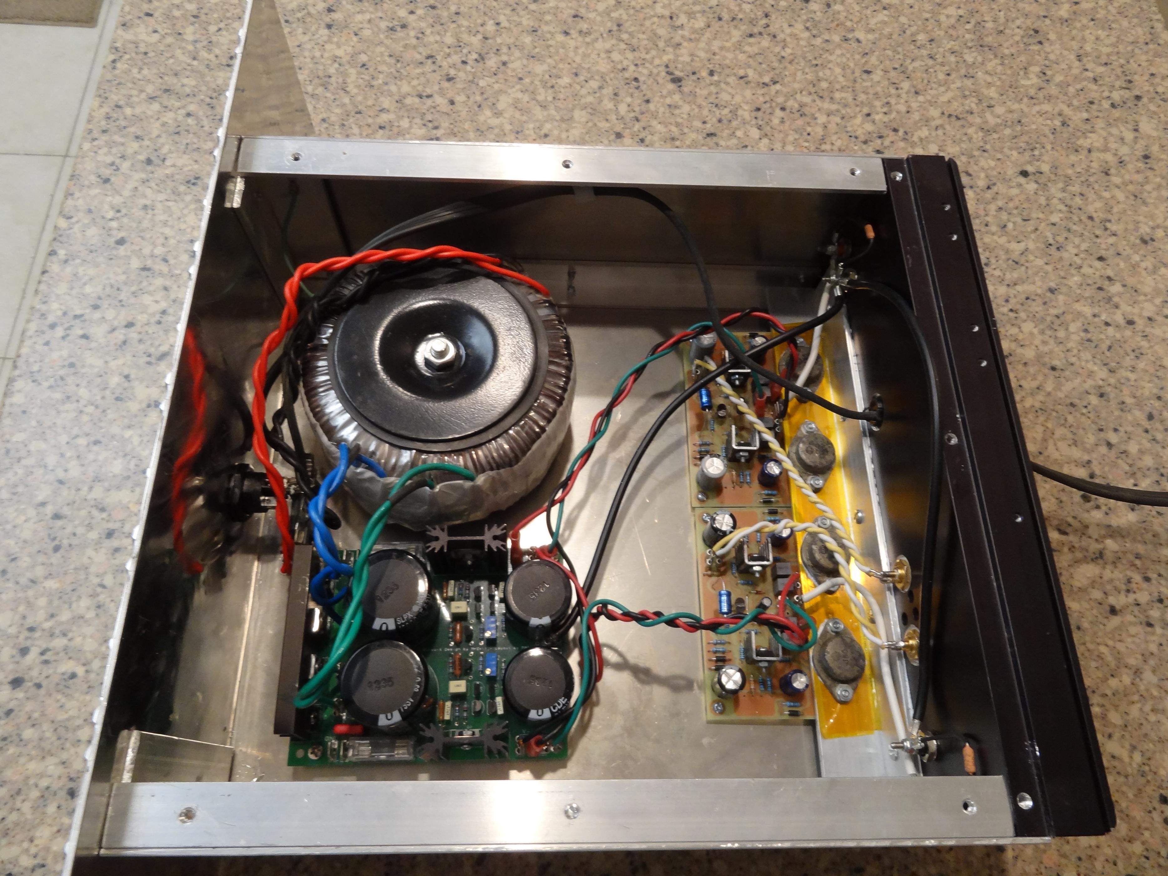

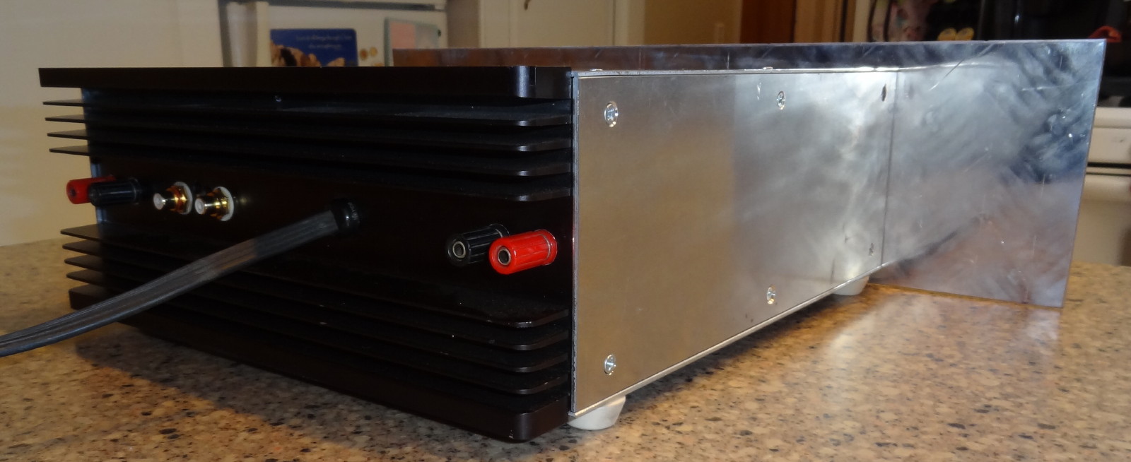

On My first VSSA, Jason's TO-3 design, I mounted both boards on one heatsink that is 4 1/2' x 11" with 1" fins running horizontally and it does just fine. I'm not saying this is the best orientation, just letting you know that these amps don't run all that hot. BTW that amp may still be my favorite of the 4 VSSA I've built.
