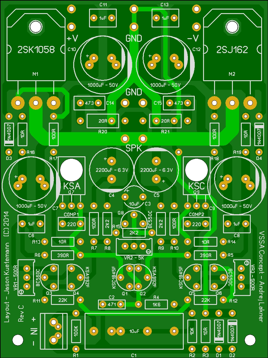

Sneek Peek

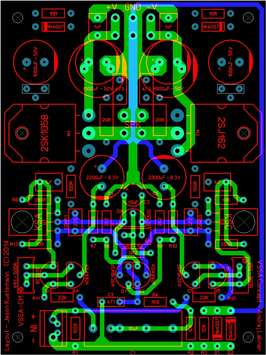

Just a snapshot to give an idea of where I'm headed. Nowhere near complete and the mark-up is a mess, so don't hang me out on the house keeping, but any general comments at this point?
Looking to move the MOSFETs up a little for better heat sink utilization and make room for a low current CM on-board to feed the front end and the VAS. Also added extra pitches for input capacitor and input connector choices. Relocated the power connections and will have room for terminal blocks or spades.
Generally I'm looking to make things more generic and adaptable. It won't be everything to everyone, but I'm sure gonna try to make it so 😀.

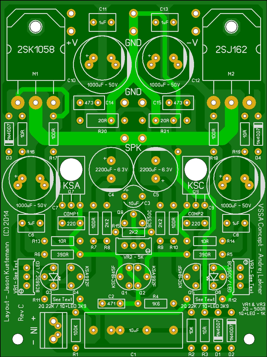

A revision 'C' for the current circuit...
Folks,
Without making any changes to the current circuit I'd like to post a possible revision to the board. Same dimensions, just added / modified the following:
Input connector pitch options added - 0.100" (2.5mm) and 0.200" (5mm).
Input capacitor pitch options added - 0.200" (5mm), 0.300" (7.5mm), 0.600" (15mm) and 0.900" (22.5mm).
Moved main PSU decoupling inward and spade connectors outward for accessibility. Minor changes to trace routing in a couple of places, nothing significant.

Hey J ....
From the 'dark side" , your layout looks superb.
The circuit is (almost ) fine....
"the cat" says 2 Q CCS's are too thermally responsive . Correct.
With a "blameless' and it's TWO 2Q CCS's (LTP and VAS) ....
they cancel each other out.
With the VSSA topology ... nothing offsets the 2Q CCS's thermal curve.
That is why I "backed off" on the 2Q and went back to the LED CCS.
Thermal simulation confirmed my suspicions .
The Hawksford VAS offset the 2Q ...to a point , but not enough.
There is another way to PSRR "heaven".
red LED CCS + R/C at the VAS Re !!
Decouple the VAS Re with 220u/33R and 90db+ PSRR you will have...
(as yoda says) 😀.
PS - for the CCS's ... run one with a fixed R , the other with a smaller R + the trimmer... one less trimmer.
OS

Thanks much for the input 'Uncle OS'. I'm quite humbled that you suggest my layout looks good 😱. I have been trying to learn a few lessons.
On these boards you can do either a 2Q CCS or a 1Q+LED CCS without modification of the board, just sub the BC550 and BC560 transistors with LEDs connected across the C-E pads (mind the polarity of course) and change the 22K resistors for something more like 3K3 to 3K9 to properly bias the LEDs. Sheldon built his this way.
The two trimmers for the CCSs provides the option of 'tuning' the VAS current and offset at the output, something one gives up if one side fixed.
Now, I saw the VAS R-C trick in your VSSA IPS for the Slew series and you can consider my interest piqued! Something to have a look at...

Any advantage/disadvantage to swapping out the the BC550/560 for the diodes? I haven't installed it in a case yet.
I'm going to suggest leaving it as is. Converting the CCS requires changing out the two transistors for LEDs, changing two fixed resistor values and changing the two trimmers for new values. I think since the board is all plated holes the difficulties or risk of damaging the board does not outweigh any advantage gained. The only real downside of the 2Q in this application is a little drift in bias of the input and VAS with temperature.
Next circuit revision will likely see two CCS options, JFET and 1Q+LED.
