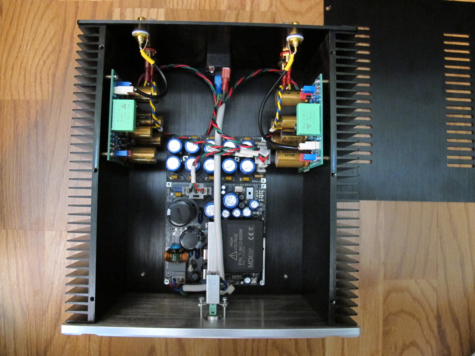

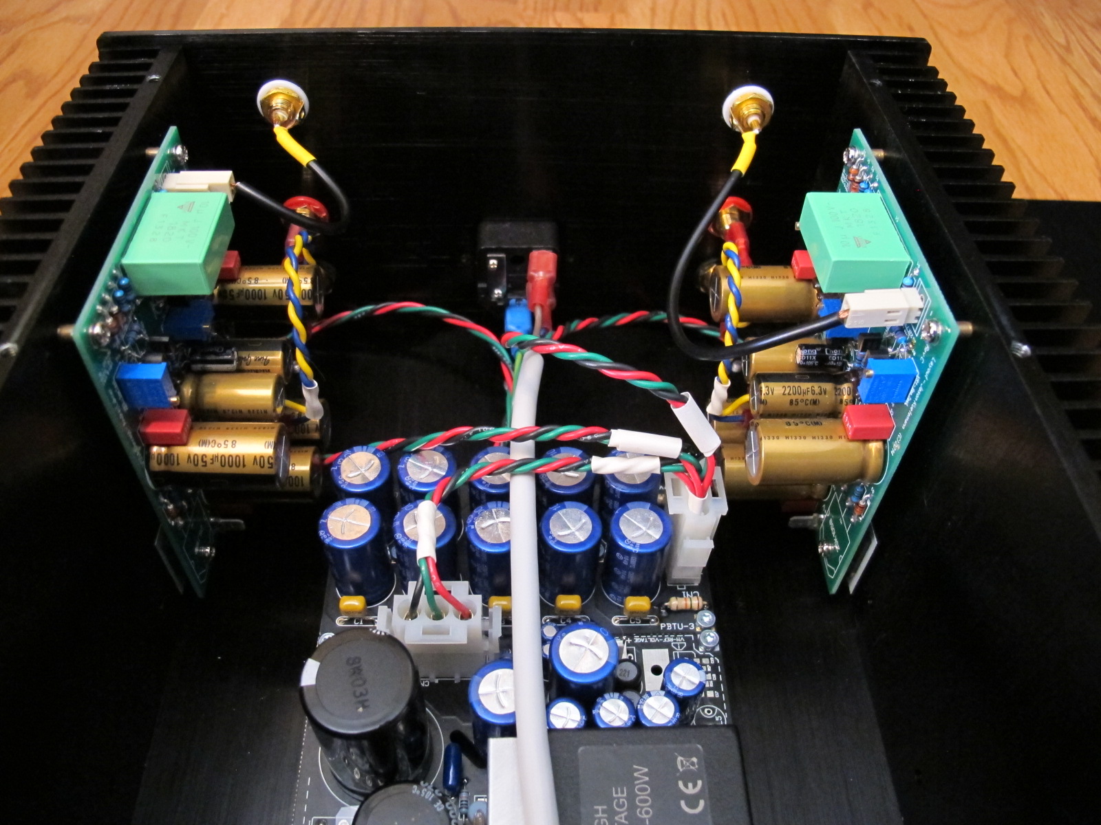

VSSA Through-Hole Version by Jason

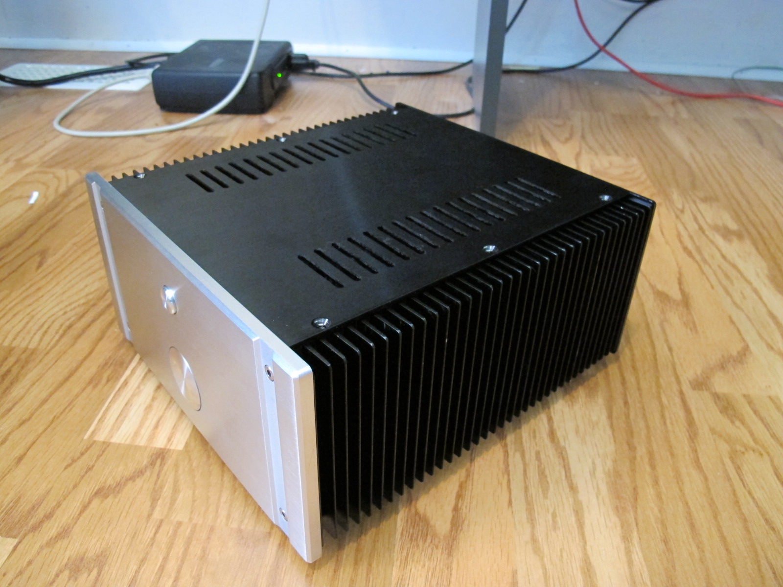

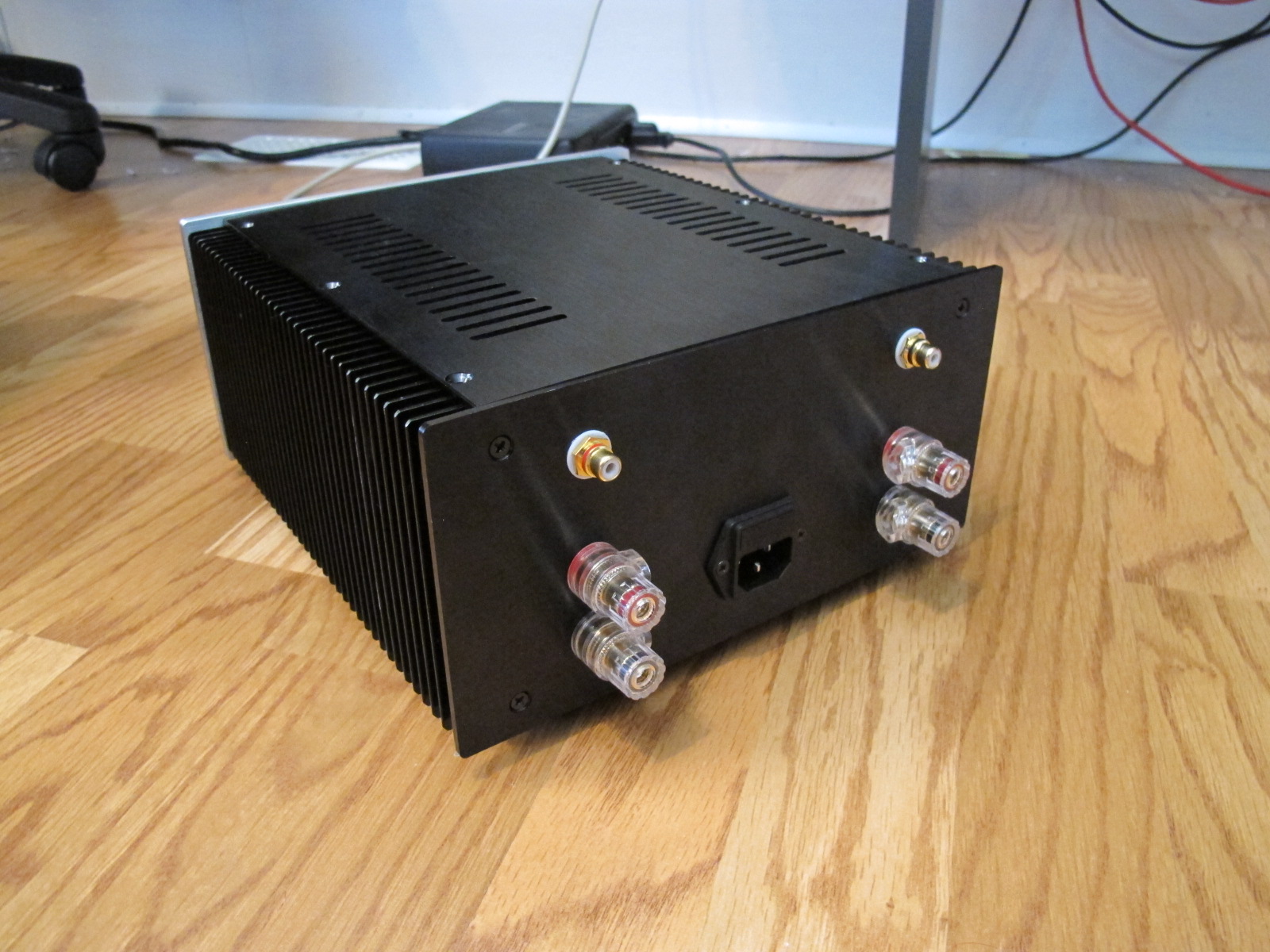

Almost there. Finally got around to installing a new SMPS (pictured is the DPS-400LV) and have it almost completely finished. Made a cosmetic plug for the from panel to cover the volume pot location.

That is an impressive looking SMPS. Where did you get it. I did a google search but couldn't find them. How does it sound compared to a conventional PSU?
I have a few more connections to make before I get a listen. I expect so long as it is electrically quiet it will sound just like a VSSA 😀.
I got it through AP2 (Roberto) here on the forum. The company is Audio Power out of Italy. Audio Power | Professional Audio Equipment
Finally got it all buttoned up and playing on some test speakers before sending it out to my main system. So far very pleased with AP2's SMPS. Nice quiet start-up and dead silent in operation both mechanically and ear-to-speaker (no audible hum or other flotsam) 😀😀😀

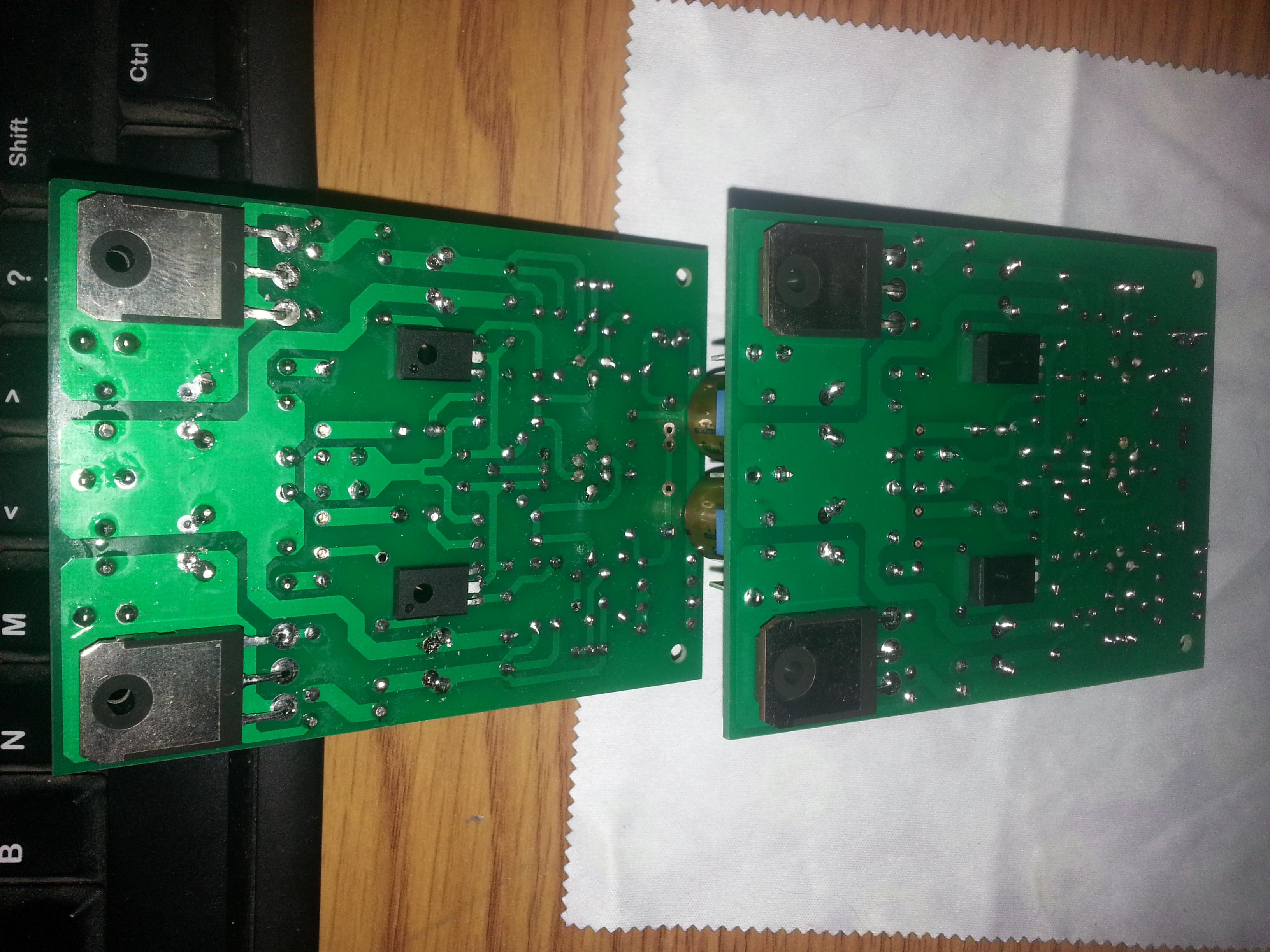

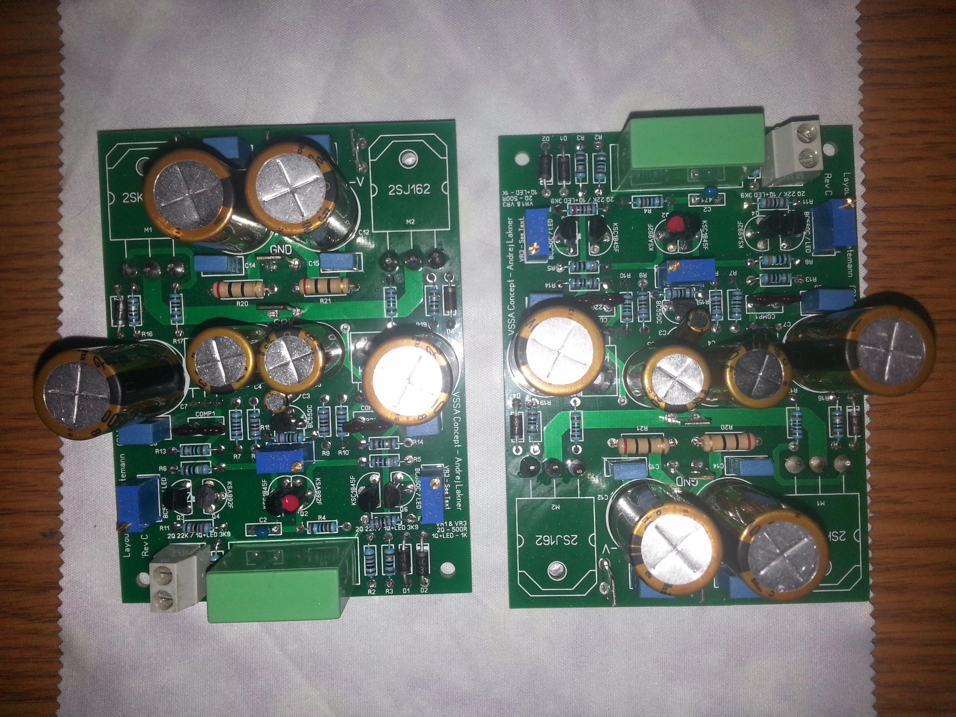

Finish Boards
At last I was able to finish the boards. This has been and continue to be a fantastic learning experience for me.
A little cleaning and than testing time..

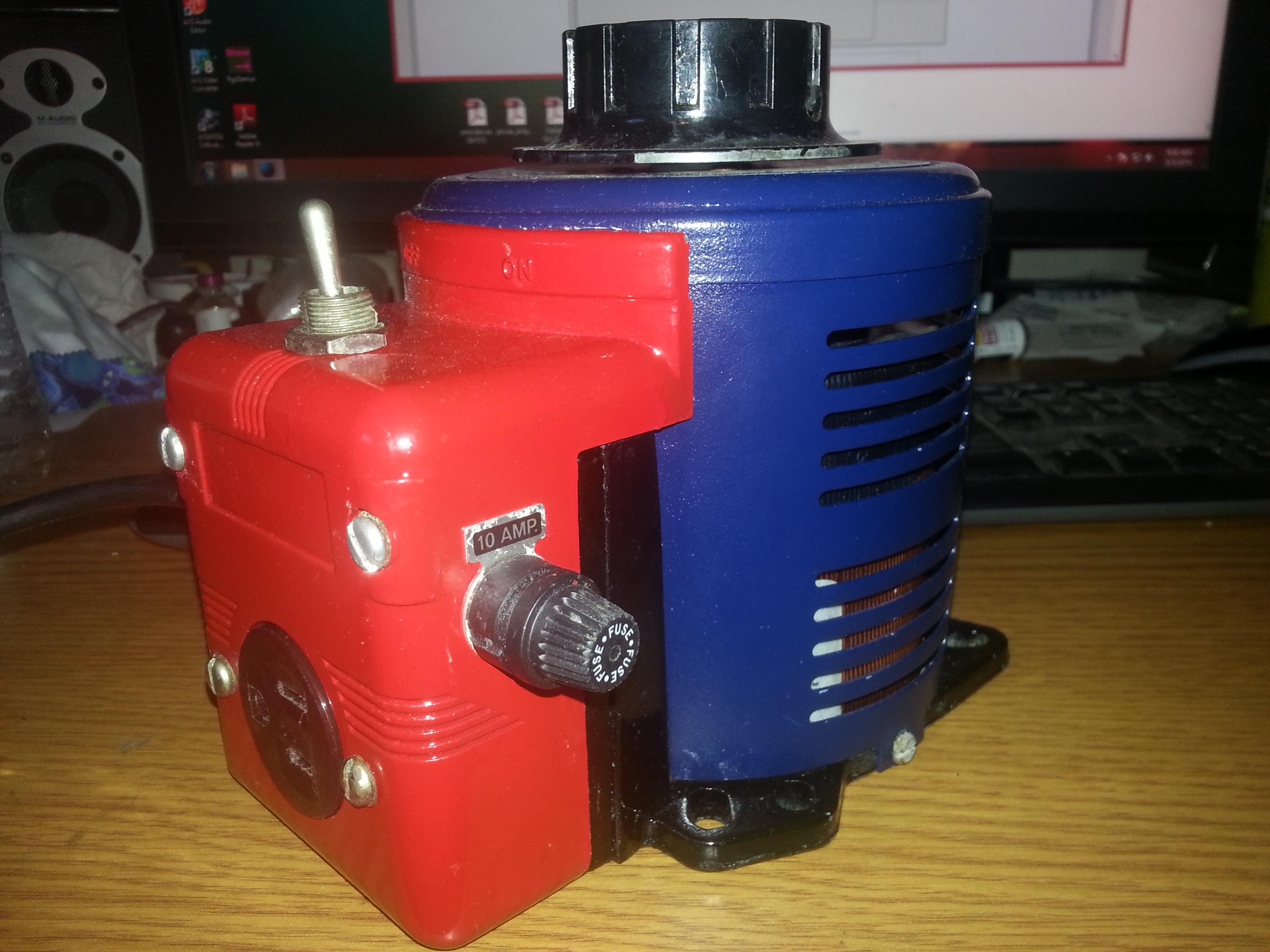

For testing I bough a 10 Amps 0-140 Volts Powerstat variac.

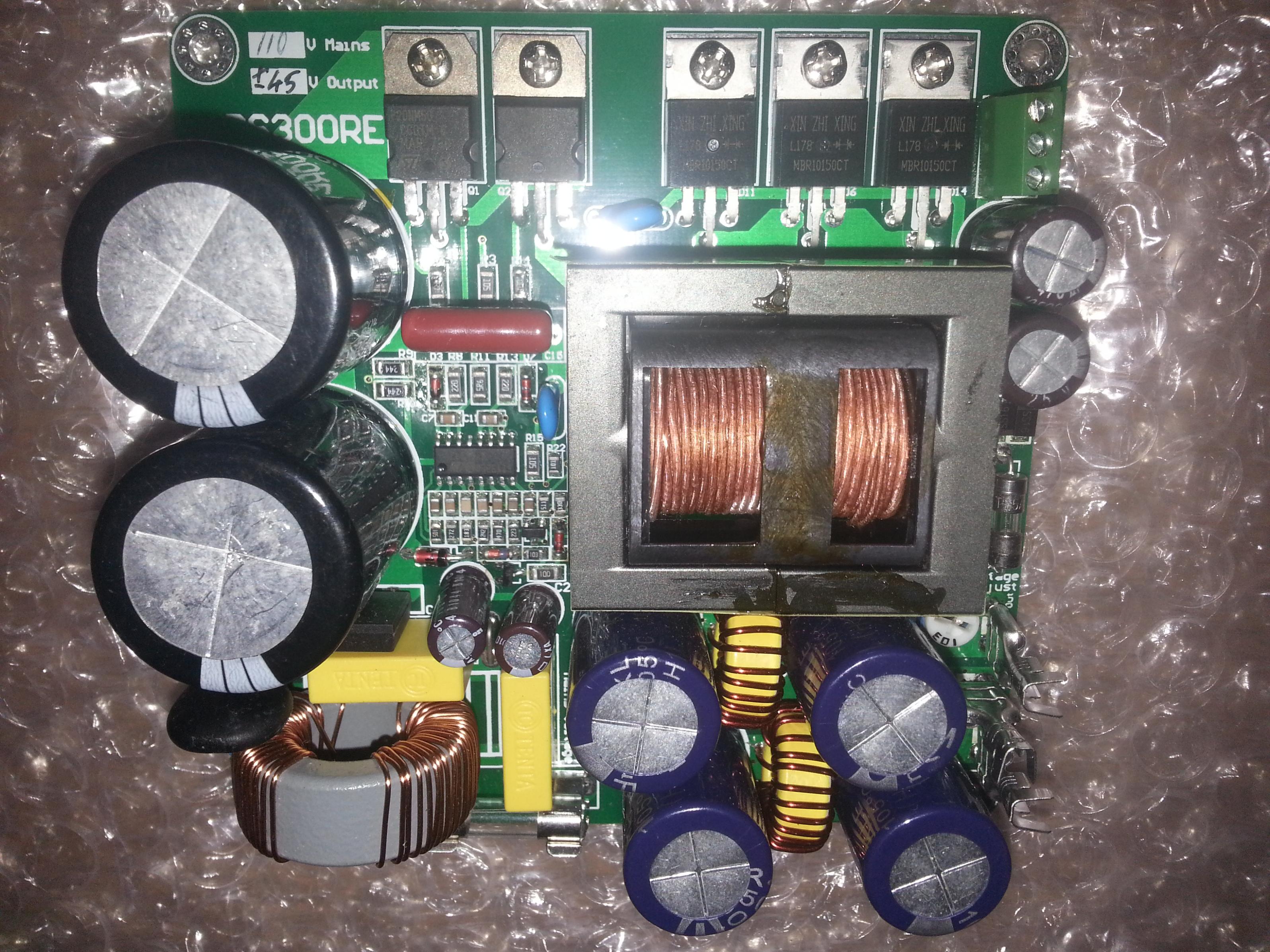

I also bough the 45 Volts 330RE SMPS.
I need help on the step I should take and any other equipment needed to text the boards.
A few pictures.
Thanks Cesar

Hi Cesar,
That SMPS will most likely power the amp very nicely but it is not good for initial testing. With that you can't use a variac or a light bulb. There is no way to power up with limited current. If something is amiss most likely magic smoke will escape. You might try using 100R resistors in line with the rail leads so they will fail first.
Hi Cesar,
Ok what else should I get and do I install the 100R resistor on the SMPS..
