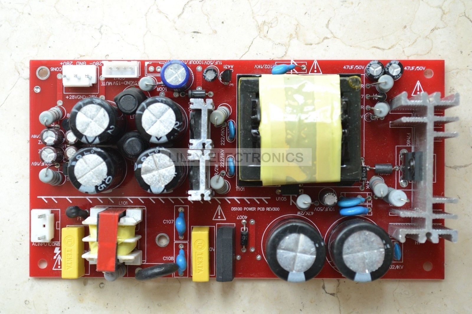

Another point that confuses me is the Power Supply.
The connex smps at ~$60 looks promising, ie; affordable🙂
Seemingly a fairly popular choice
Cheap is good, also aware of buy cheap, buy twice possibilities though.
If I read correctly..you had problems with your example ?
However Still4given didn't ?
No way of adapting a Computer PS ?
Are they even suitable.. dunno just curious ?
Some are quite decently made and sold in the millions.
I'm in no need of more than 50 watts, likely less than that, as my speakers are 94db.
But they optimally require an Amp with 'backbone' (current capability) in my experiences.. for convincing bass/dynamics.
What PS voltage would you suggest, 38v or 48v or ?

No annoyance, I'd rather answer a few queries than have to help troubleshoot a problem.
I bought a Connex SMPS500R, and yes I had an issue with it. It remains yet to be resolved, so I'll say my personal experience with that supplier has been less than stellar. Others have bought the Connex SMPS300RE and have apparently had success with those. I also had a bad experience with a ColdAmp SPS30, no recommendation / endorsement from me for that supplier either. Their product was at a premium price with no response regarding my dead unit. My DPS-400LV from AudioPower (forum user AP2) had worked well and despite his 'interesting' personality was easy to deal with and the product was offered at a decent price point.
I wouldn't bother trying to 'hack' a PC SMPS, they are not set up for the voltages we want anyhow.
There is absolutely nothing wrong with an old fashioned linear bulk supply, especially if you CRC filter it.
As for supply voltages, the amplifier works very well in the +/-30V to +/-45V range, with +/-45V being the maximum. Please do not feed it from higher rails as the output devices would be too stressed. People have asked about higher rails and the consistent stern answer is NO. The common most suitable SMPSs are generally available in the specified range and for linear supplies transformers of ~250VA+ in 22-0-22 to 32-0-32 VAC range are suited to the task.
This is probably against popular opinion but I ran this amp on this SMPS for a few hours today. I placed in on my A/B setup next to my TO-3 Peeceebee and there is only the very slightest advantage to the Peeceebee and it is running +-38V rails against this +-25V. I hooked it up to the scope and it looks very clean and begins clipping at 15vac into an 8R load so that is about 28watts. Plays nice into 4ohms. I don't have a 4 ohm dummy load to measure for you. Anyway, for a $30 investment worth looking at.

Do not overlook Hypex SMPS400A180, works like a charm. Producer is very reliable, not even one problem with any of their products.

Yes, I forgot to mention that one though I don't yet have personal experience with it. Thanks for the reminder LC.

I am sure the Hypex is a better unit. I just wanted folks to know that this SMPS will do the job and surprising well considering it is only +-25V. The VSSA doesn't seem to mind at all. As of this moment it has been driving 4 JBL cabinets for 8 hours and not breaking a sweat. For $30 it is a no-brainer and a great little tool to have around the bench. It also has a +-15V output that I have found very useful for matching MOSFETs. I even ran a Symasym V5.2 with it and it sounded fine. I like it a lot better than the Connex I bought.

I believe so. It holds its voltage very well. I'm not saying it will beat the other smps out there. I'm saying it works and it is a nice tool to have around for quick setup and that I was quite surprised how well both my VSSA and Symasym sounded when driven by it. It would be nice if someone else would try one to give a second opinion. I replaced the plugs with screw terminals because I didn't' have matching female plugs. They should probably include those.

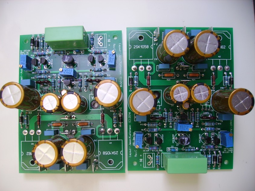

Been studying the PCB to double check on bits needed..I see an oddity with R20 and 21
These have 'extra' holes..What? are the inner hole(s) on Both R20 and R21 for.. Short resistors 🙂 Remainders? Or?
Also what is the orientation of KSA and KSC.. referenced to their printed/numbers face ?

You may solder directly or use pin header type connectors, choice of how to connect is up to the individual constructor's preference.
R20 and R21 do not have 'extra' holes. Those are vias where traces change sides. You can leave them as-is, or put a small spot of solder on them if you choose.
The KSA and KSC are oriented 'face up', with the print visible when attached to the heat sink. The leads are bent up to pass into the holes on the PCB.

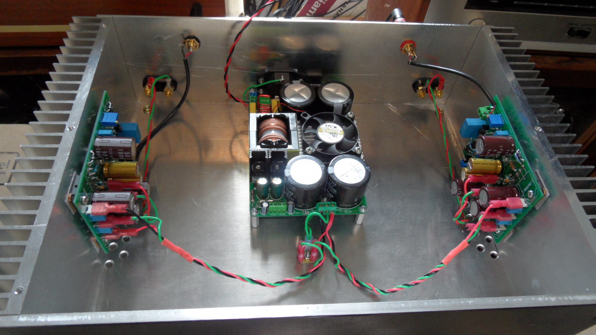

Here is my latest build with your boards. Still Awaiting a power Switch for the front panel.
It Sounds Great. Has enough punch for my taste in the bottom end & still maintains that clarity all VSSA are known for. 😀
