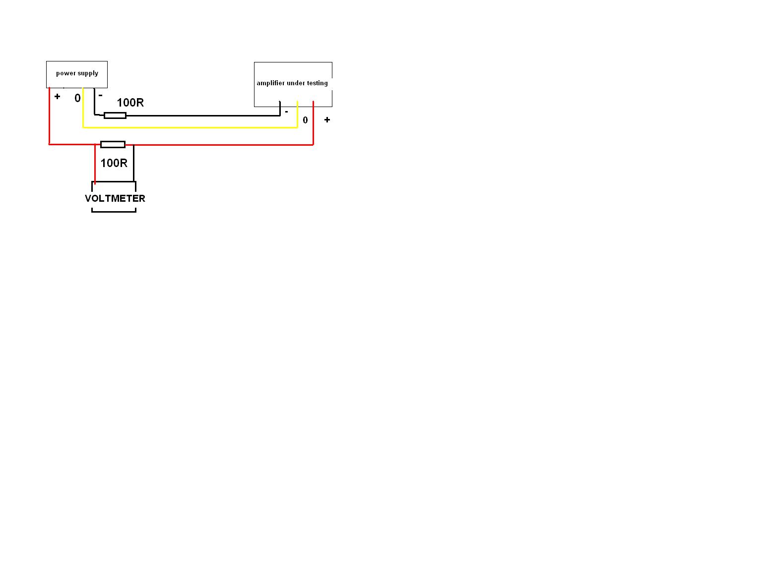

Hi Jason. I read post #372 several times and it just make my head spin.. I will continued to read it until I do get it.
I'm still a little confused on were I should place 100R resistor.

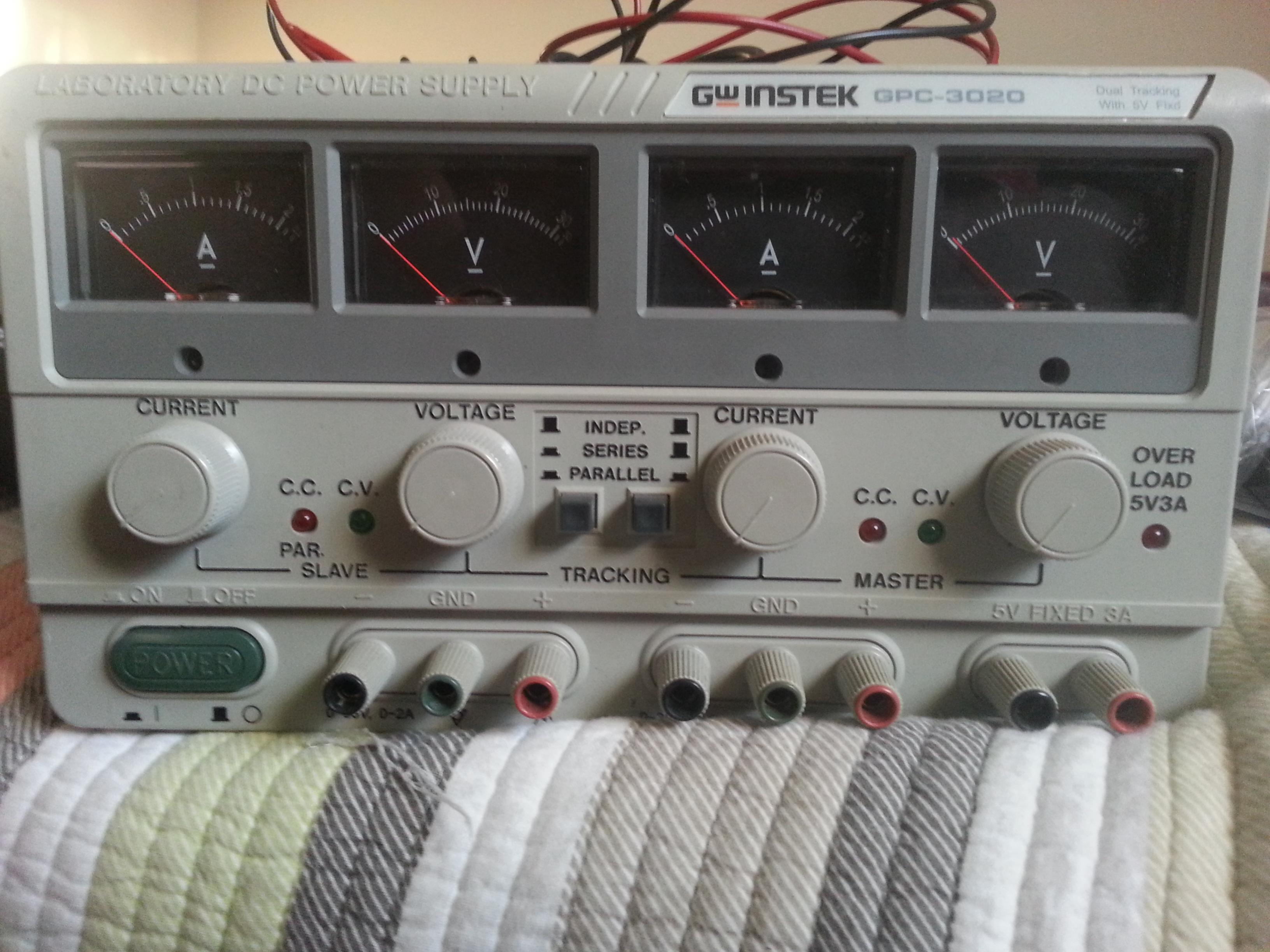

I bough this power supply today Gw Instek GPC-3020 for $80 bucks hoping the I can use it to test the boards..

That supply should be fine for initial testing and general bench use. Looks nice for the money spent.
The resistors go 'in-line' with the wires feeding the positive and negative voltages to the amplifier board. They are there for the purpose of limiting current in the event of a fault and you can indirectly measure current by reading the voltage drop across them.

Cesar,
All this said, since you have a nice bench supply you can set the current limit to perhaps 200mA or so and forgo any added resistors that are meant for those without such equipment. You would just turn up the voltage slowly watching for any excessive current draw until you are at full voltage (or 45V, whichever comes first though it looks like the bench supply may have ~30V output).
If you have constructed carefully and followed the first steps on the diagram to get the adjusters pre-set properly then you will likely have an uneventful power-up.
