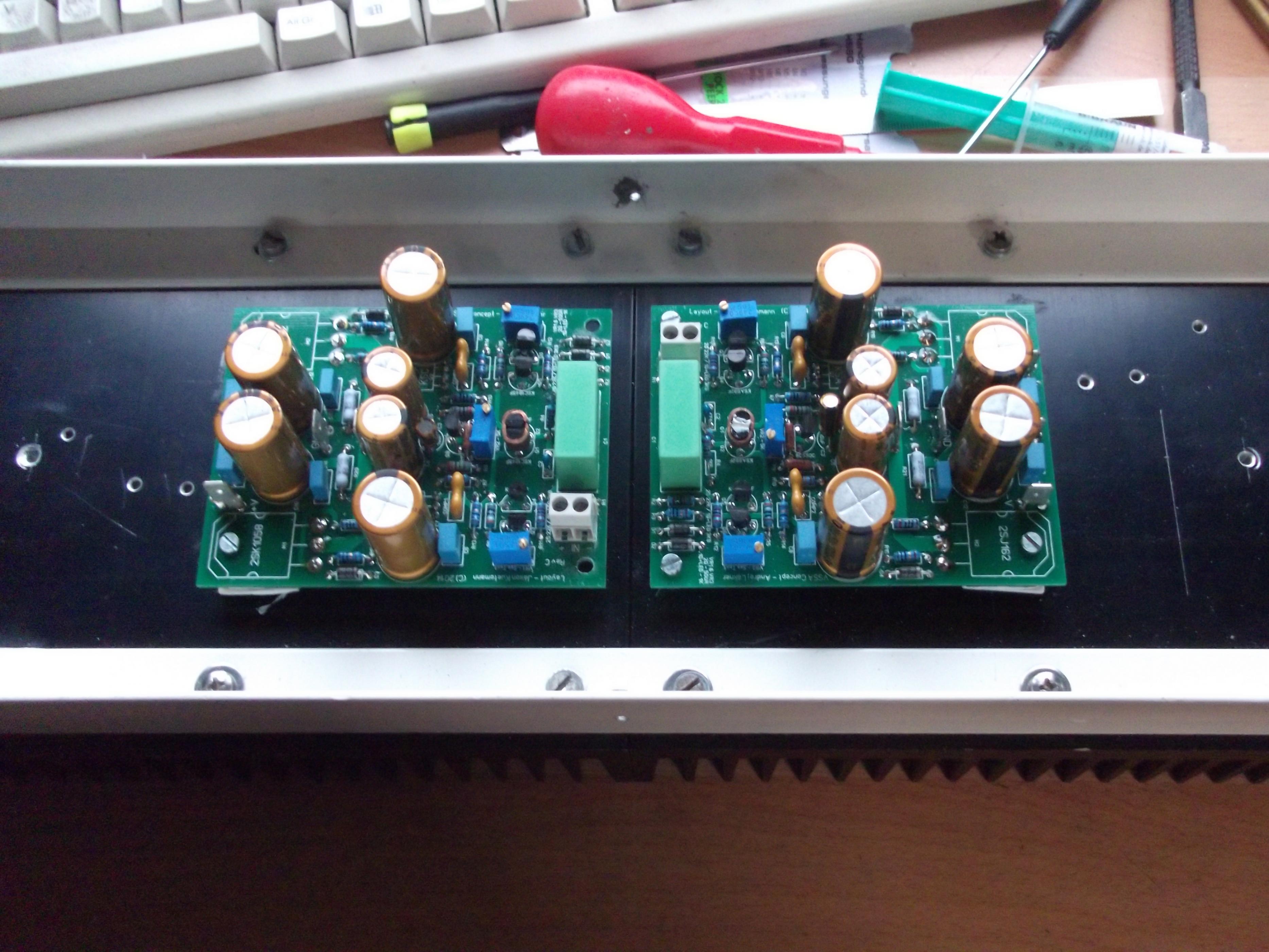

Build update.
The passed few days I study all the photos and I reread the entire forum again.
Watch some videos on how to solder.
The results are better than my first try.
Check post 323 and compare.
All feedback are welcome.
Jason thanks for the encouraging words.
That soldering is looking much better Cesar. With a little more practice you will have the perfect amount of solder so that the pads on the top and bottom are just right, every time. If the solder doesn't wick through to hole right away you can reposition the soldering iron tip just a little and leave the heat on for just a couple seconds more.
I'm happy to see you taking this slow and easy, not rushing into the build. When you are ready we will go through 'pre-setting' the adjusters and how to properly set these up. It isn't hard to do but will need you to take your time and work with care.

Hi Jason. Did you decided which SMPS to use with the VASS.
Almost finish the boards, so I believe I will need some type of power to set up and test the boards.
Can you recommend a inexpensive table top power supply for testing.
Will post some pictures later..

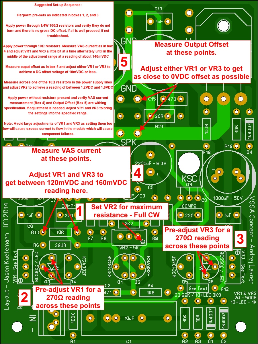

I know you have been studying the photos but the very first thing is a careful check of your work. Look for missed solder joints, joints that are shorted together (solder bridges), incorrect components / values, etc. one satisfied all looks good we will pre-set the adjusters before we power up for the first time.
Suggested Set-Up Sequence
Hopefully this will assist with setting up the boards for those who aren't familiar with the VSSA already.
This is easiest with more than one multimeter and test leads with small alligator clips if you have them. It can be done 'fully manual' with one meter and regular leads if need be. Just make sure you are slow and careful with set-up to avoid shorting something out with a slipped test lead tip.
Please Note: If properly pre-set VR1 and VR3 won't need large adjustments. If you feel like you are turning them too much, you probably are. Stop! Power off and start over. An anecdote; I had one test lead on a test module that wasn't in good contact when measuring the VAS current resulting in a false reading. It resulted in me turning the adjusters too low and popping the VBE and a 100Ω gate stopper. No major damage, but still a repair all the same.

Very helpfull Jason but one question does the input need to be shorted for the offset measurement?
Yes, whether the input is DC or AC coupled, shorted input simulates source's (preamp) low output Z and zero output DC. Also prevents unwanted EMI signals to enter sensitive input among measuring phase, while holding the amp in very steady condition.
DC coupled input transfers source's (preamp) output DC offset with gain 1 (AC coupled GNFB) or full gain (DC coupled GNFB) to the output. In this sort of connection any other than zero input DC calibration condition (shorted input) would cause certain output DC offset when zero DC source would be connected.
AC coupled input cuts source's (preamp) output DC offset influence completely. Now the source of output DC offset is the amp's input stage unsymmetry, driven by thermal changes practically in all stages.
