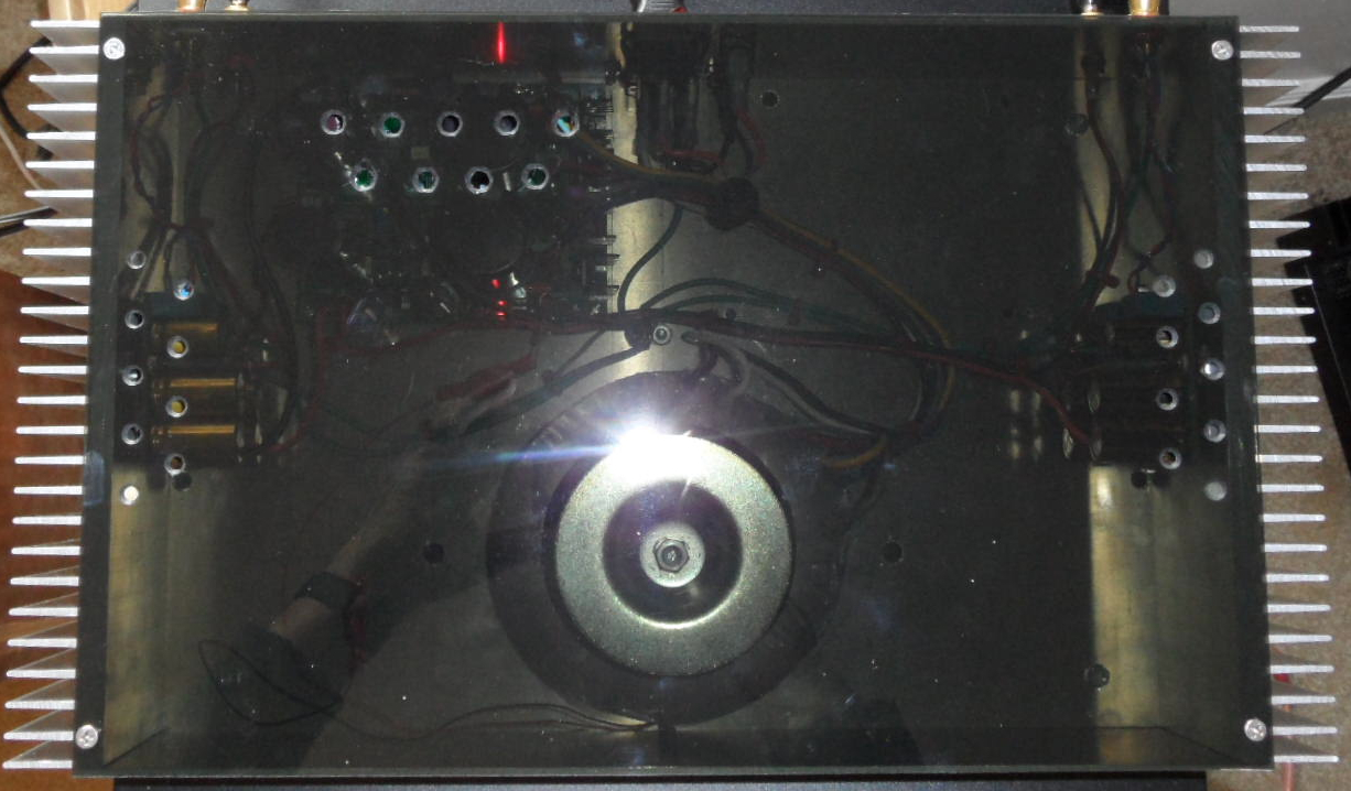

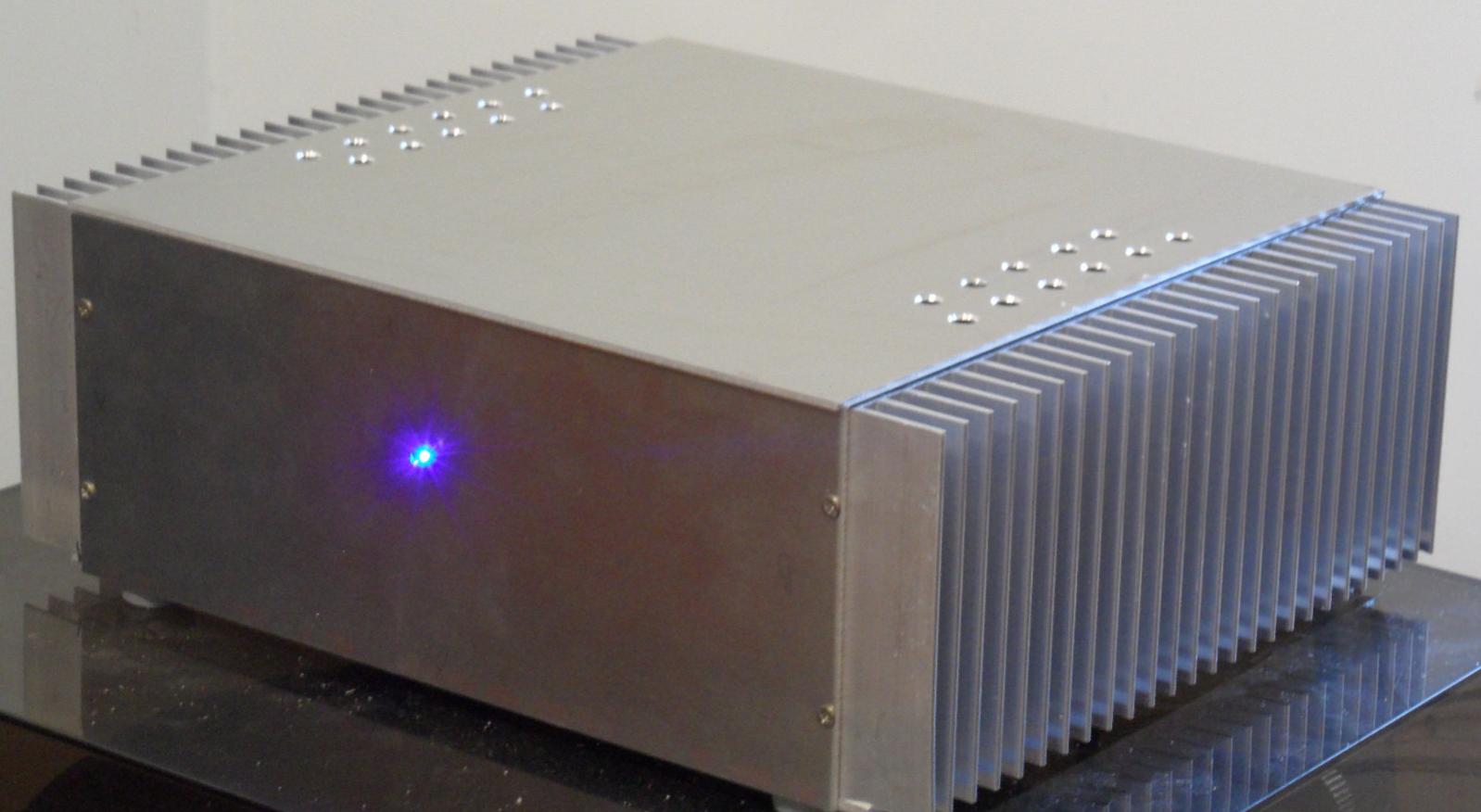

Jason,
Here is what it will eventually look like. This is a previous PMI VSSA build with an Alu top, Then with the Smoked Acrylic Top. Sorry i didn't take many Pics of the Acrylic top. My Brother in law is it's proud owner now.
Rick

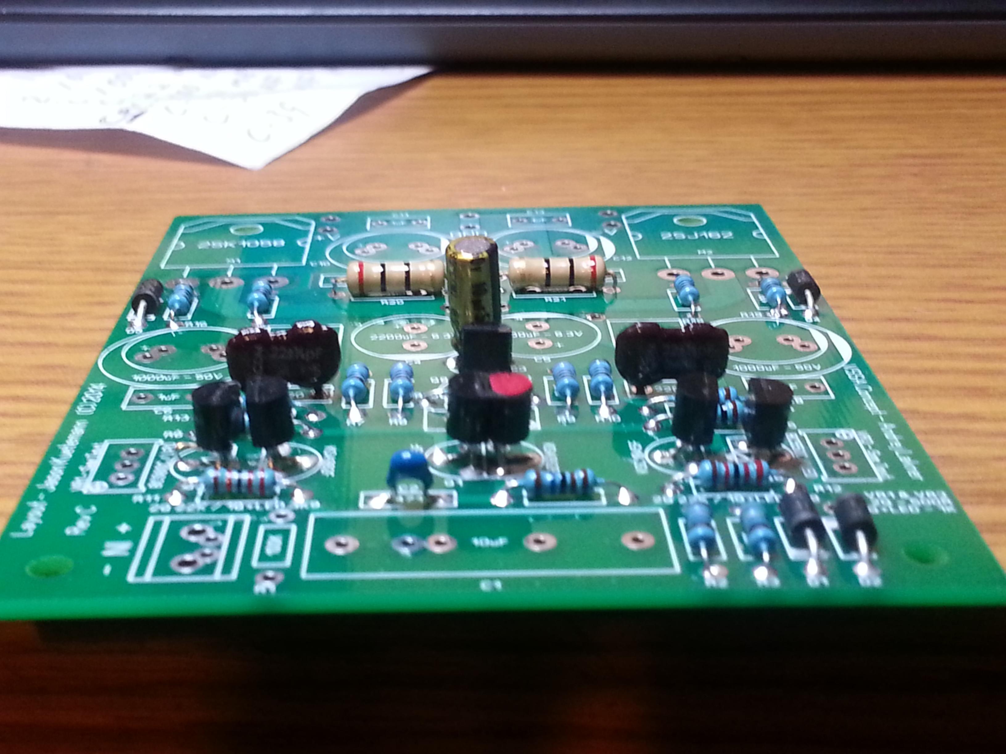

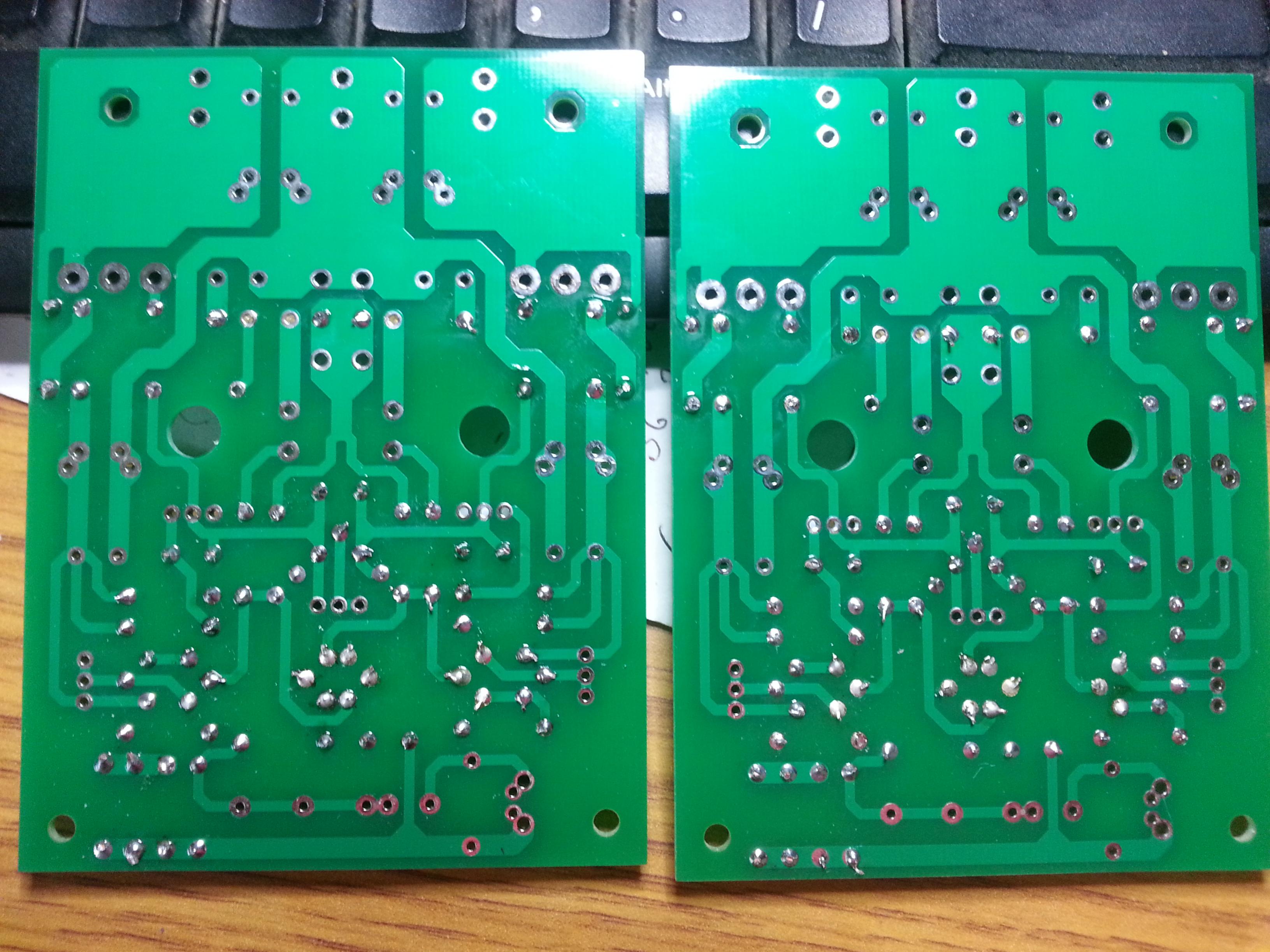

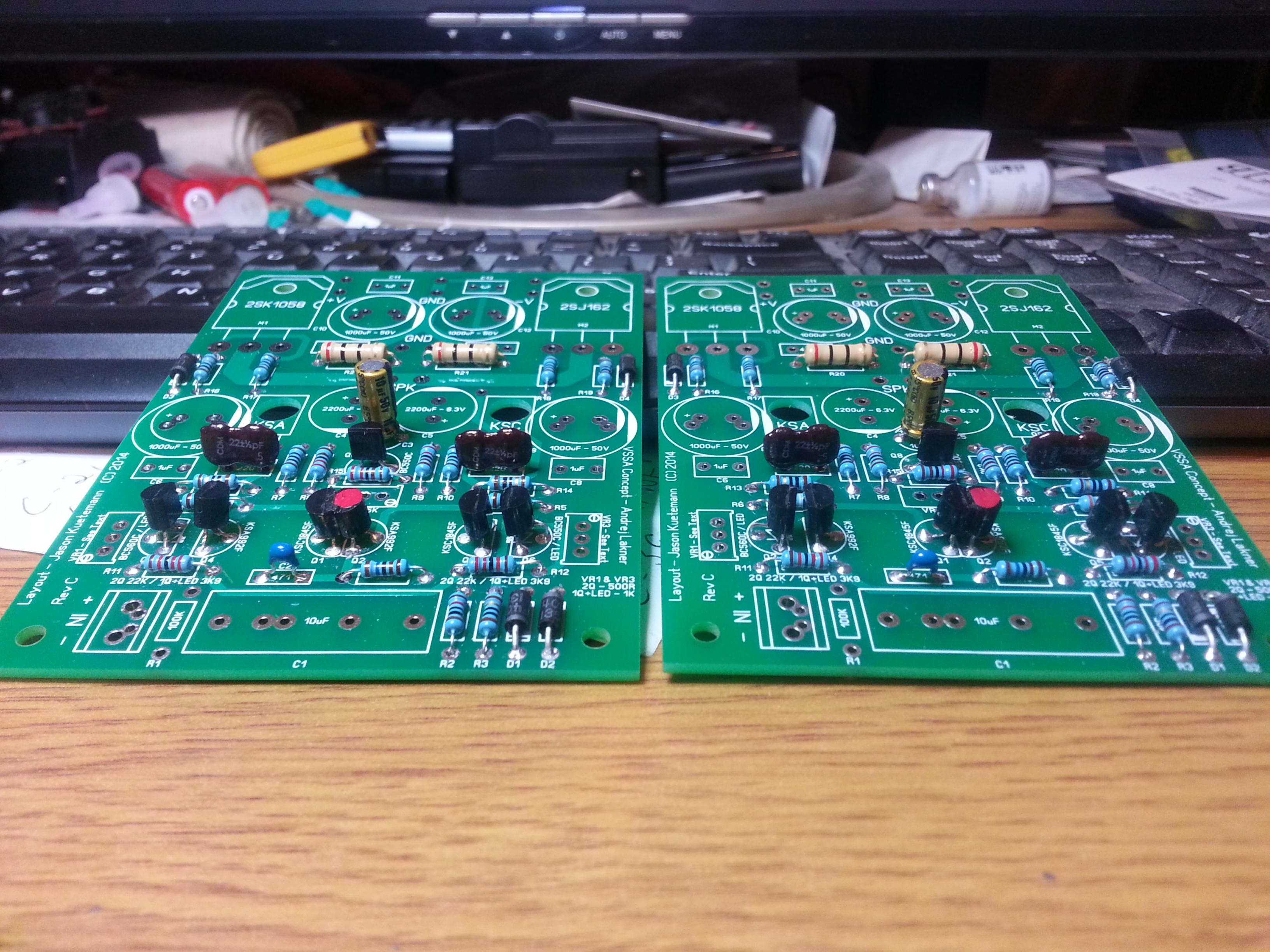

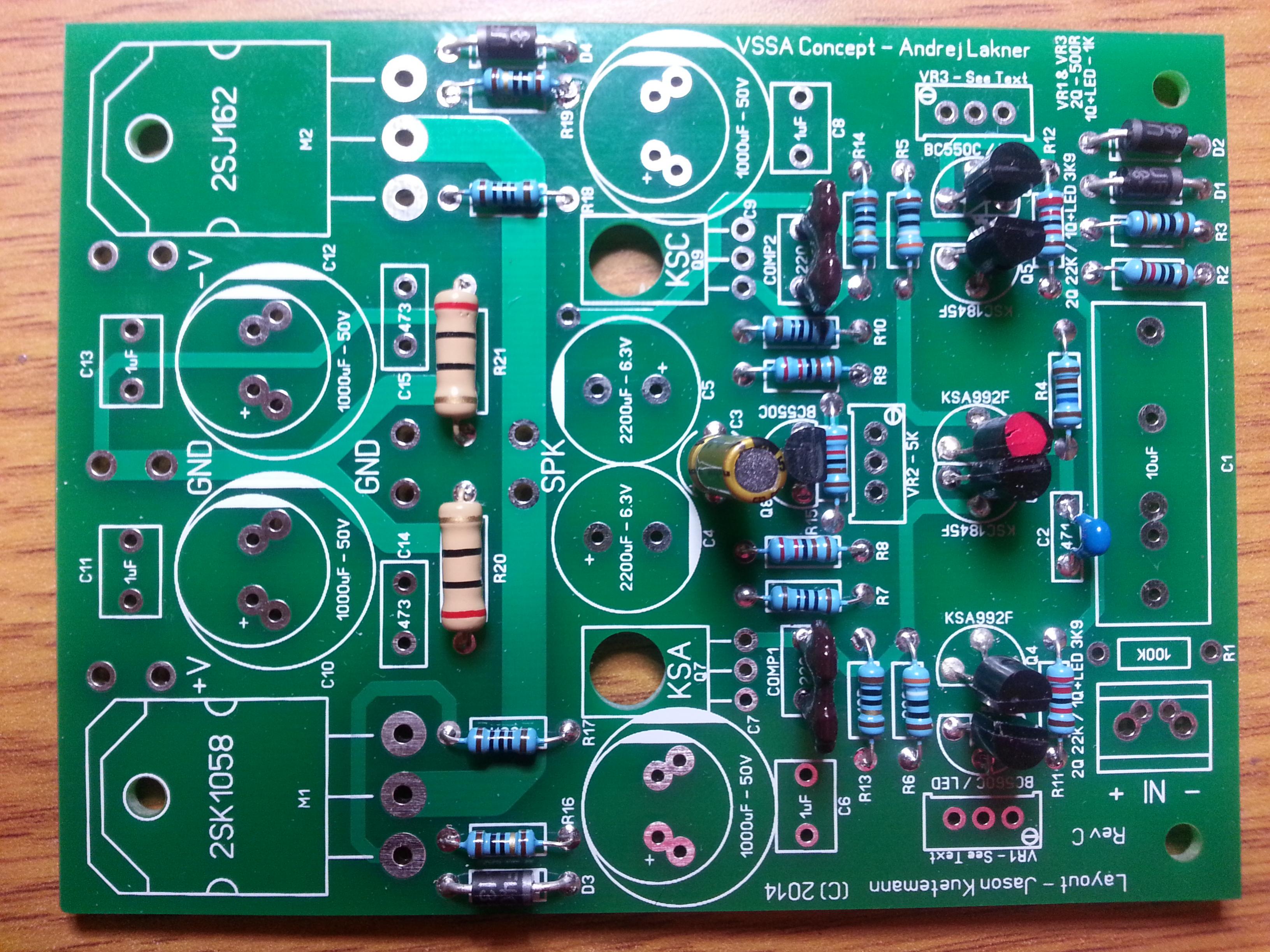

First attemp
Build update.
The passed few days I study all the photos and I reread the entire forum again.
Watch some videos on how to solder.
The results are better than my first try.
Check post 323 and compare.
All feedback are welcome.
