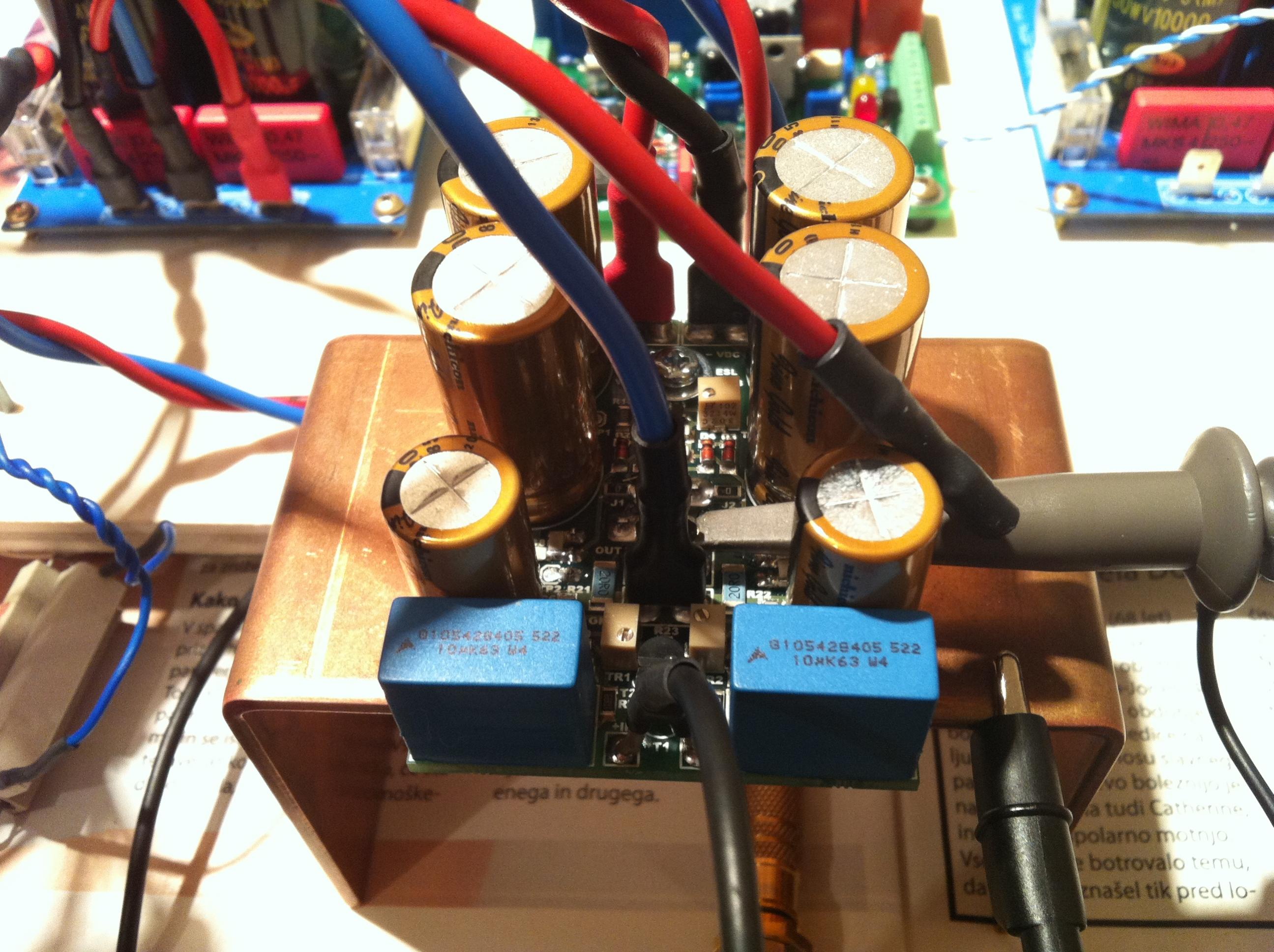

That is outstanding! How are you loading the output?SMD production VSSA PCB started to work immediately from the first power up. It took me 40 seconds to set it to 15 mA VAS bias, zero DC offset and 160 mA output bias. On pic is 2,7 MHz (-3dB) response, perfectly stable.![]()
At 2,7 MHz is loaded with 10 Ohms from output zobel only. Today's measurements are mostly concentrated to bias and offset leveling, clipping behaviour, stability in general. Output bias is trimmable from 120-200 mA, VAS bias up to 20 mA, offset in both directions ended at 0 mV, so quite happy with the results. Power is not an issue, it is always available if needed. 😀

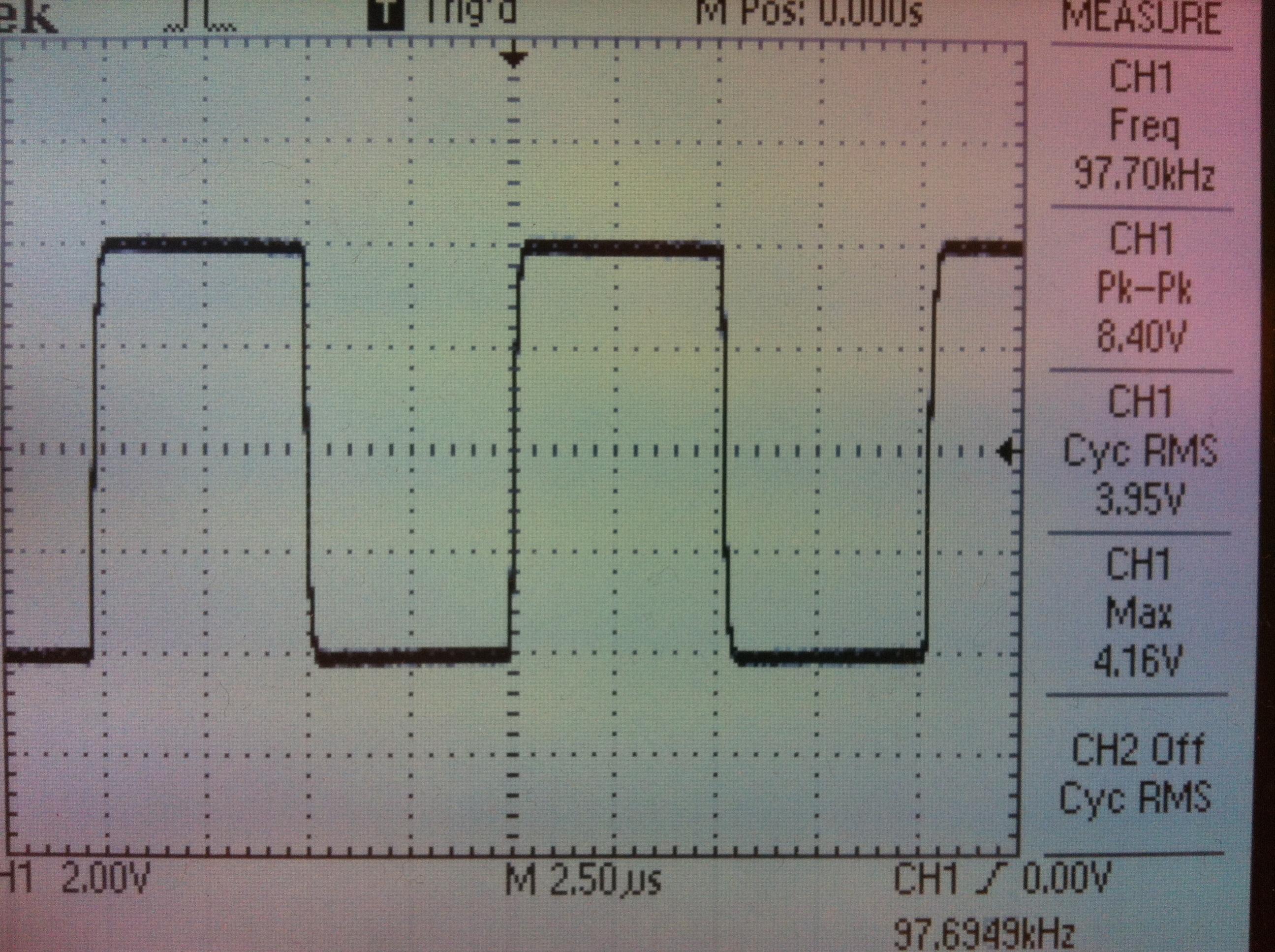

Well of COURSE, we always need something better... 🙄 I am using an old Wavetek for my tests. I am fond of some of those old instruments, they do not seem to fail as often as some of the newer ones I have seen (and heard about)...100 kHz on 8 Ohm is the same as an input signal, which comes from an old Elektor signal generator, not really the perfect one. Have to get something better soon.![]()

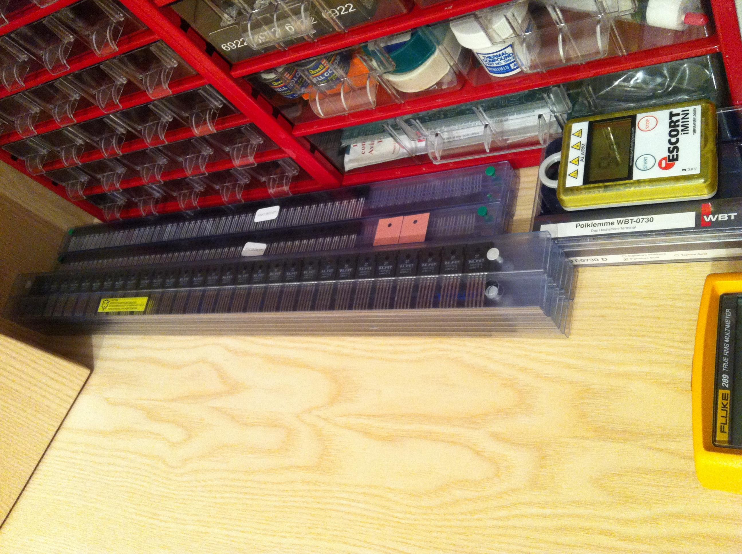

From what I saw up to now I think there shouldn't be any problem with the rest of 250 VSSAs from GB. 😎

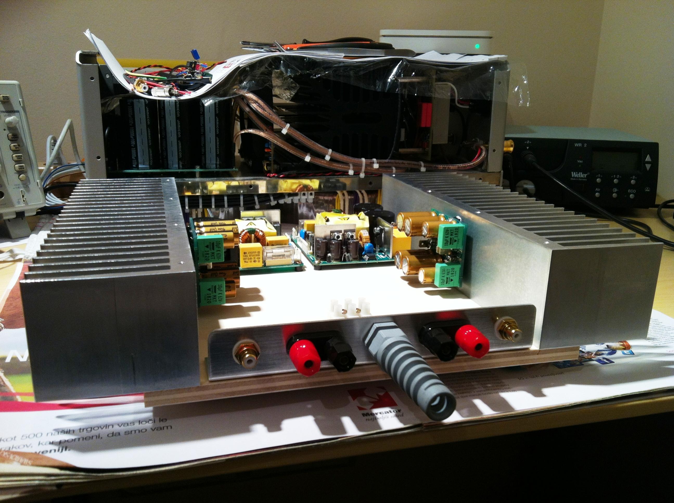

😱 Would you need a larger heatsink than the one you show in pics in some posts above in this thread?... what must be available if our goal is 100 W/8 Ohm rms and 150 W/4 Ohm rms....
Of course, this copper one is intended just for set-up checking. It nicely goes from room temp to 50 deg C in 5 min and stays there, so you don't have to wait too long to se how parameters settled at proper output bias and with temp raise only VAS bias changes from 12 to 15 mA. DC offset and output bias are fixed all the time from heating up. So this copper heatsink is just for testing purposes or to listening the music in a few Watts range.
Understood that, use of quick responding heat sink in test, but thanks.
Even the two aluminum heat sinks I saw in one of your prototypes seem (to me) smaller than what you would need for a +-45V rail, unless I am missing something.
Or to put it another way, if those were the correct size, then we can safely use a much smaller heatsink with 35-40V rails, which is what I think was given as maximum supply somewhere here.
I believe you recommended around 0.5K/watt?
(Forgive me if I missed some part of the thread)

Of course, this copper one is intended just for set-up checking. It nicely goes from room temp to 50 deg C in 5 min and stays there, so you don't have to wait too long to se how parameters settled at proper output bias and with temp raise only VAS bias changes from 12 to 15 mA. DC offset and output bias are fixed all the time from heating up. So this copper heatsink is just for testing purposes or to listening the music in a few Watts range.![]()

Yes, and that is exactly what my demo amp's heatsinks are offering.
