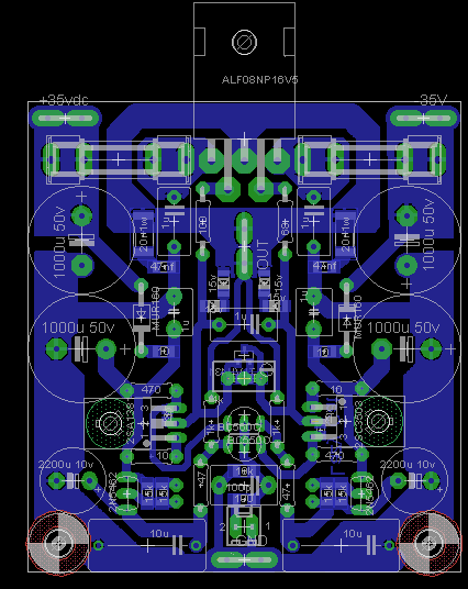

Hi LC,
It's always done (see file under). I juste want to replace parallele resistors by trimmer for definitiv...The board is single layer made with smd parts on copper side but that's not possible for trimmer...
Through hole multiturn trimmers are OK to be left on PCB after set-up, they're very precise. You have enough space to add two trimmers for offset/VAS bias adjustment. Also you can replace all three trimmers with two parellel resistors afterwards, all combinations possible to make with your PCB.

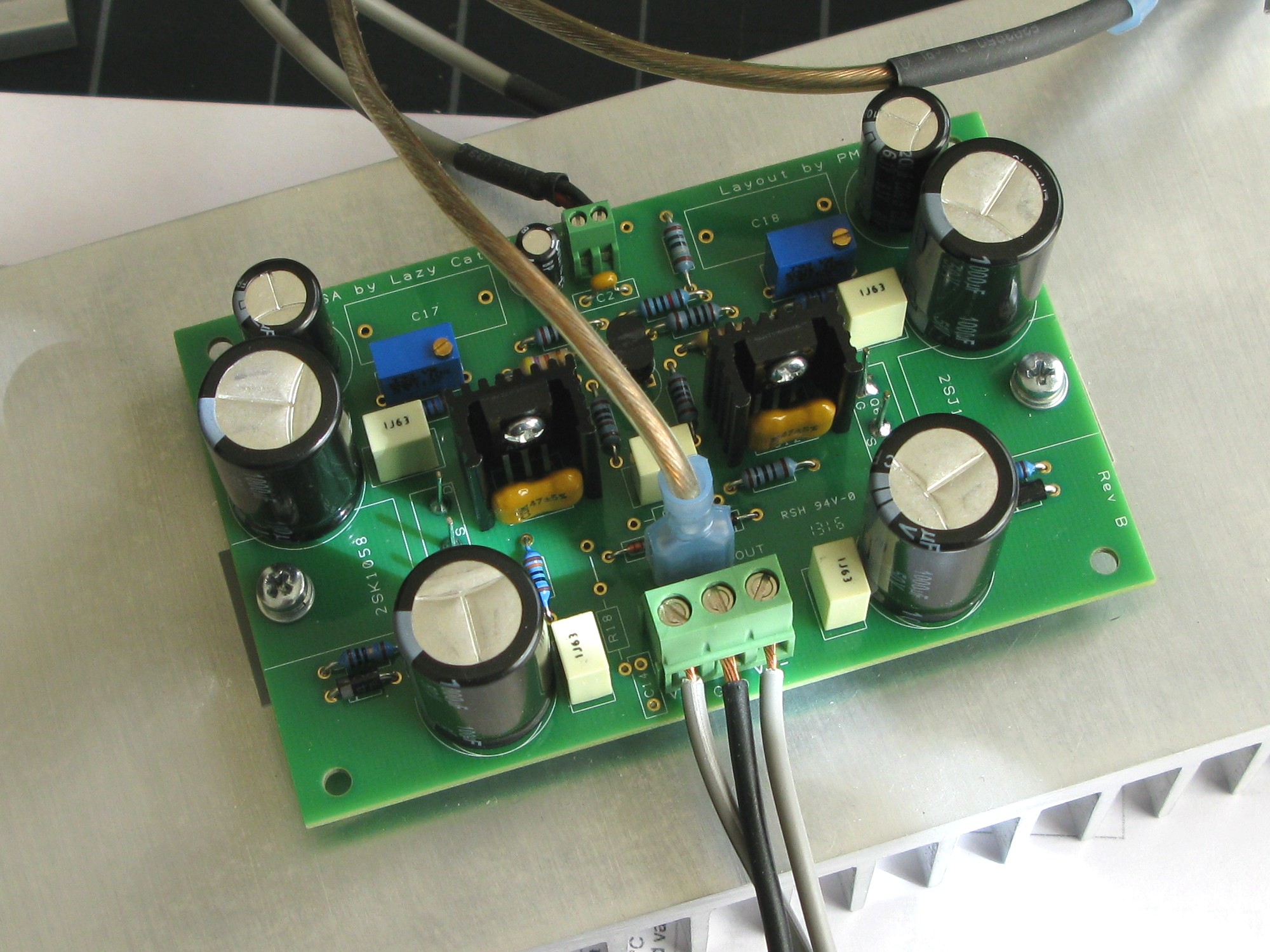

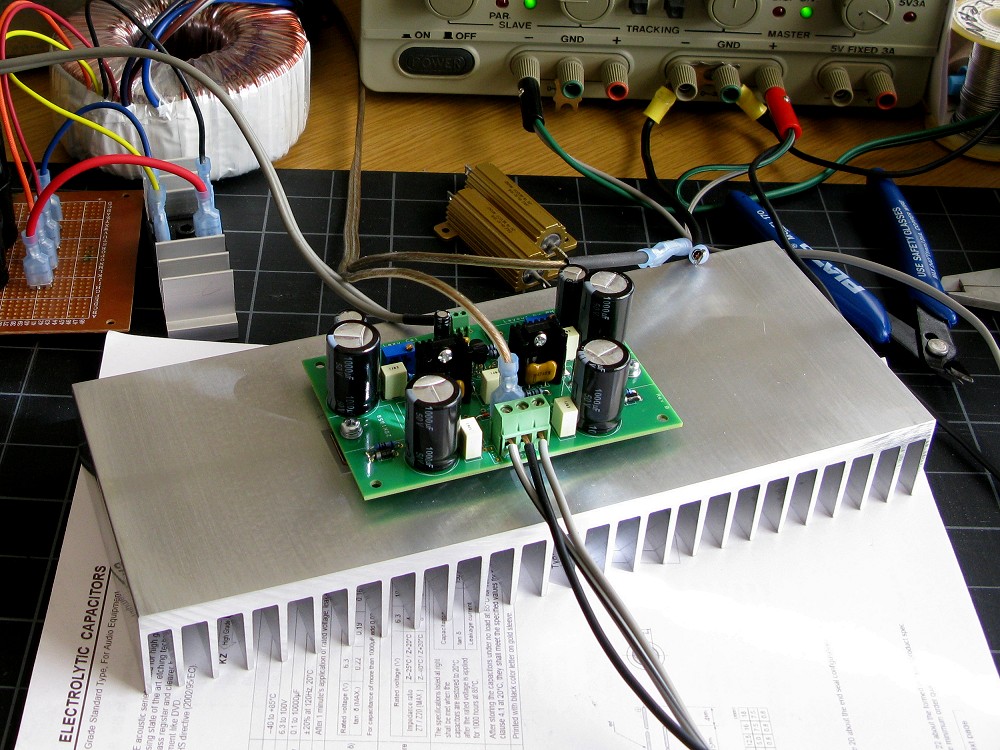

I am testing my layout of Shaan's circuit (pic attached), at a DC supply voltage of about +/-36V. I expect line and load variations of perhaps 35~37V DC. Offset and bias were set using two trimpots.
I have noticed a large change in VAS bias with fairly small changes in supply voltage. Over the same supply voltage range 35-37VDC, VAS bias current changes from 13.6~18.3 mA. 5% change in supply and 25% change in VAS bias current.
I would expect some of this because this is the circuit with a 15K instead of a CCS, but where is the rest coming from? 😕
Test conditions are 35-37VDC, adjusted using a variac, no input (shorted), no load (open). Measured with Fluke 77 multimeter. (pictures show input and output connected, but the above results were measured as stated)

That is right. 2V/15K = 134uA
470R*134uA = 63mV
63mV/10R (VAS emitter resistor) = 6.3mA.
