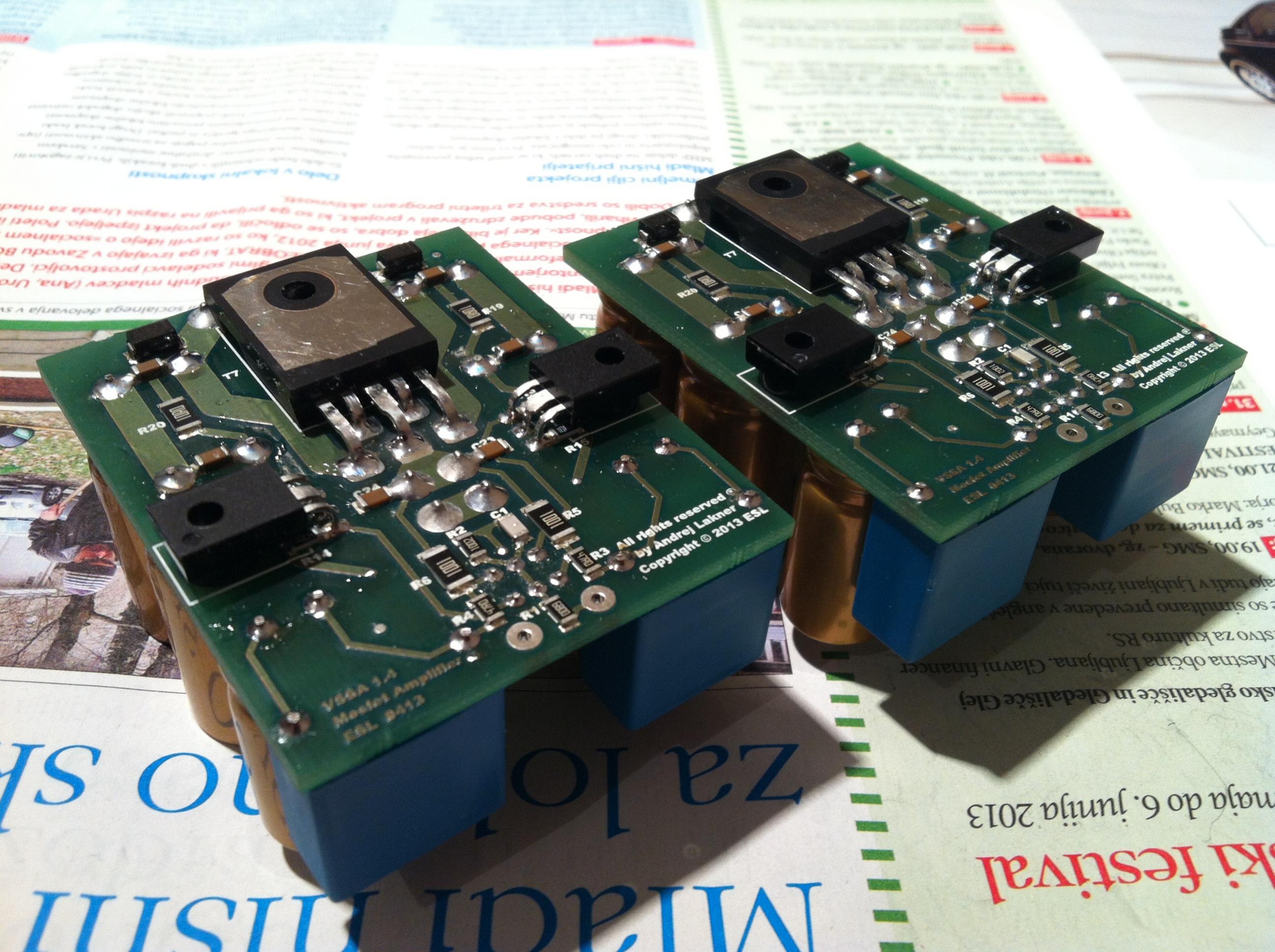

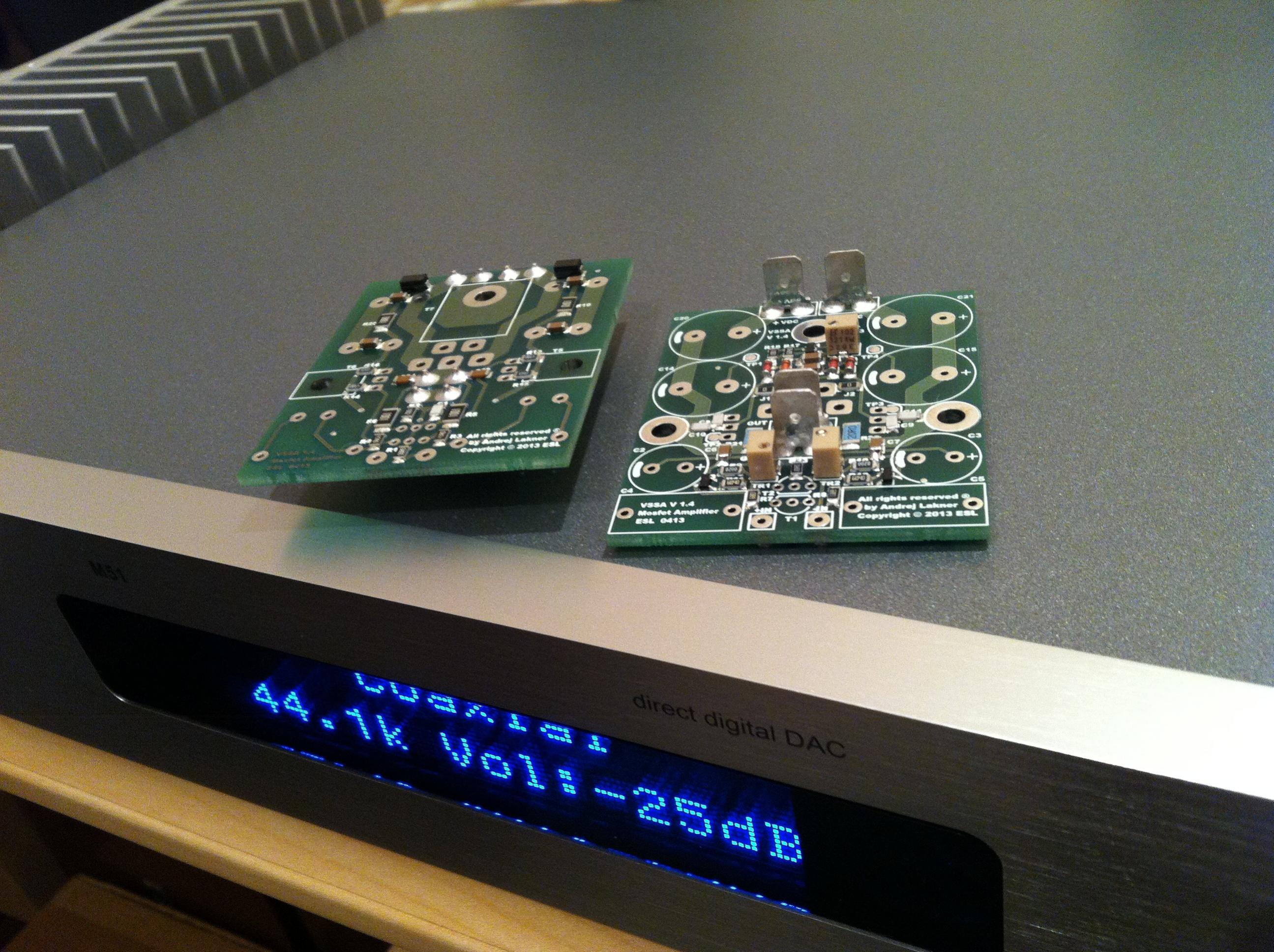

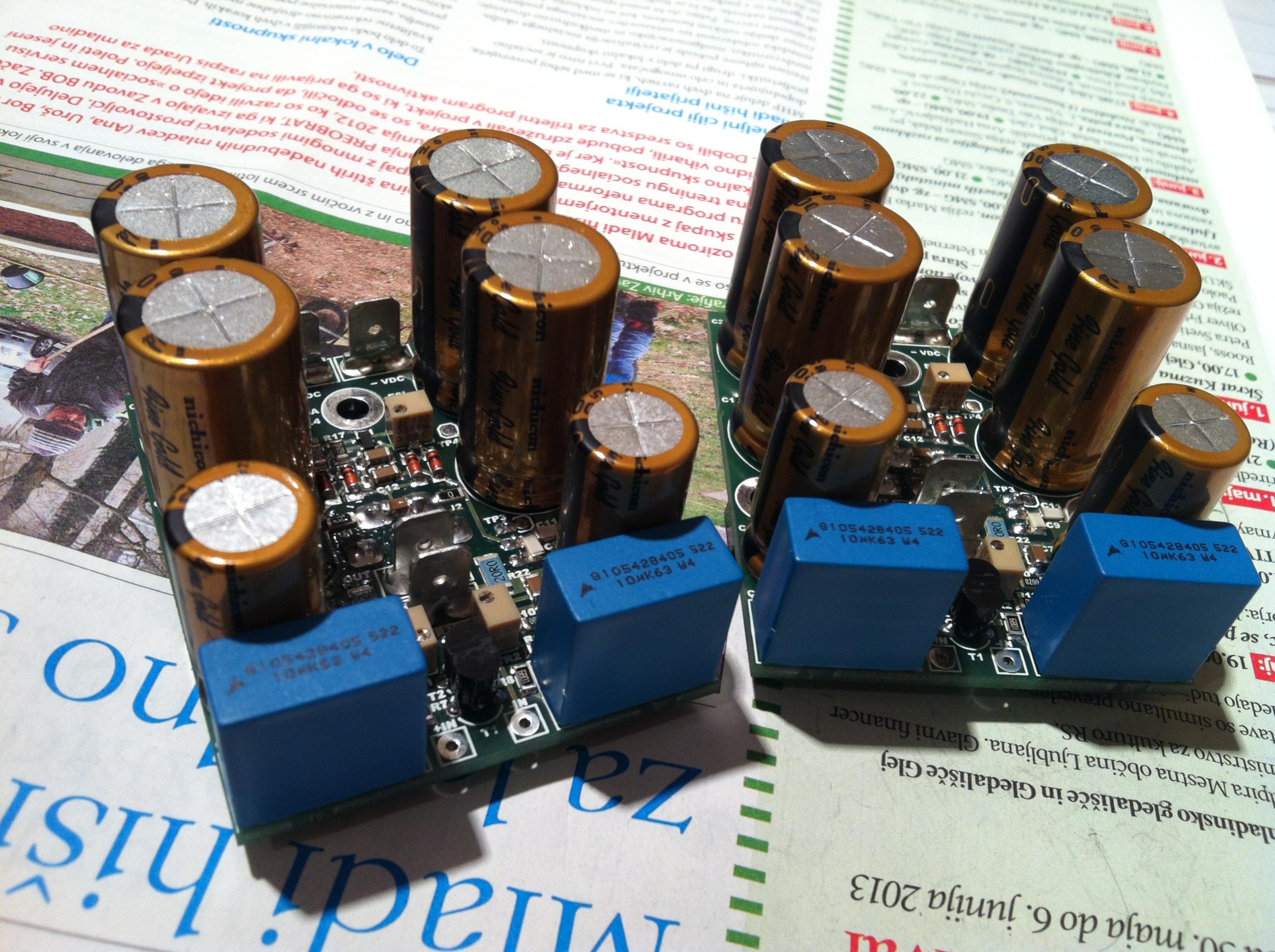

Two new VSSA PCBs I got yesterday for testing purposes, already fully assembled. It took me three hours only to complete both VSSA channels, which now are ready to be tested. 😎
All 250 VSSA PCBs are produced, as I explained in upper post, and waiting on the stock. SMD production company just needs my positive answer and if everything will measure OK, they'll get green light and assemble all PCBs till Friday next week. :yes:

Hi LC,
I did find the BoM on post # 705 and the following info for the caps. But if you have the exact part number for at least the Vishay MKT it would be great. I did post the FG caps MFG #
Capacitor dimensions for VSSA PCB:
- 10 uF/63 V, MKT, Vishay-Roederstein, 2 pcs = B32522C106K, B32522C0106J000 ????
Lead Spacing: 15 mm
External Depth: 8.5 mm
External Height: 17.5 mm
External Width: 18 mm
- 2200 uF/6,3 V, FG, Nichicon, 2 pcs = UFG0J222MHM
Lead Spacing: 5 mm
External Diameter: 12,5 mm
External Height: 25 mm
- 1000 uF/50 V, FG, Nichicon, 4 pcs = UFG1H102MHM
Lead Spacing: 7,5 mm
External Diameter: 16 mm
External Height: 31,5 mm

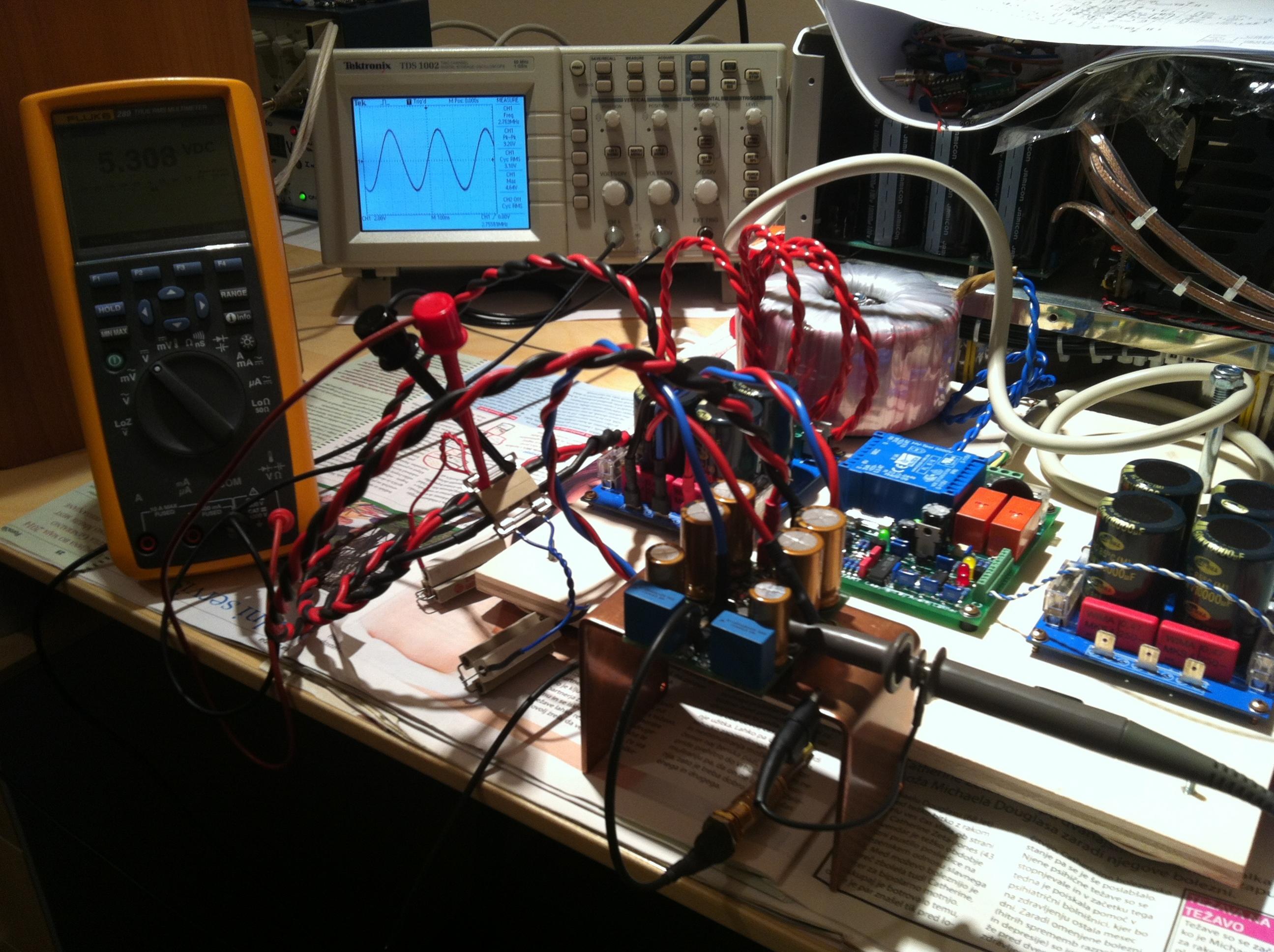

SMD production VSSA PCB started to work immediately from the first power up. It took me 40 seconds to set it to 15 mA VAS bias, zero DC offset and 160 mA output bias. On pic is 2,7 MHz (-3dB) response, perfectly stable. :up:
