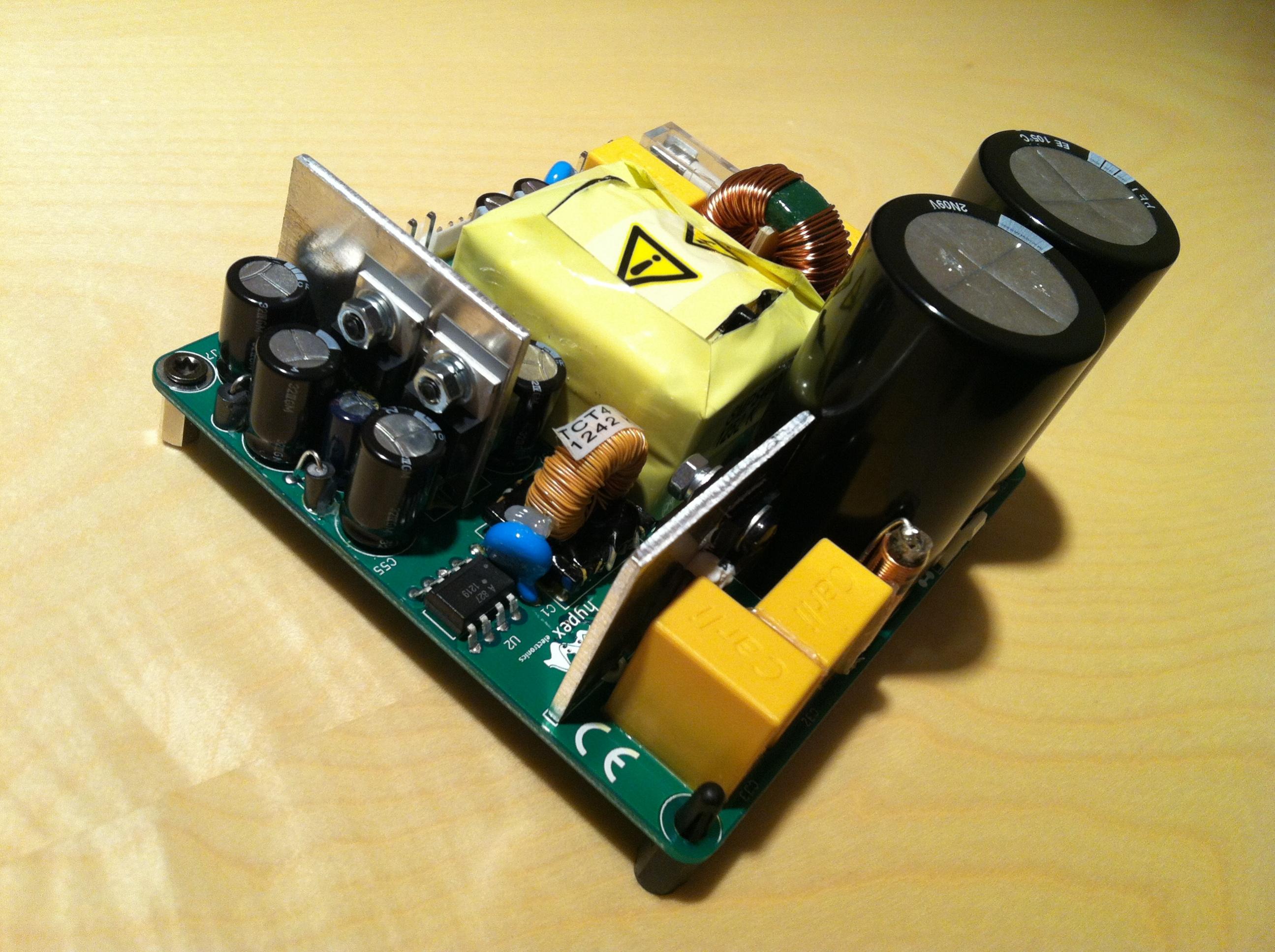

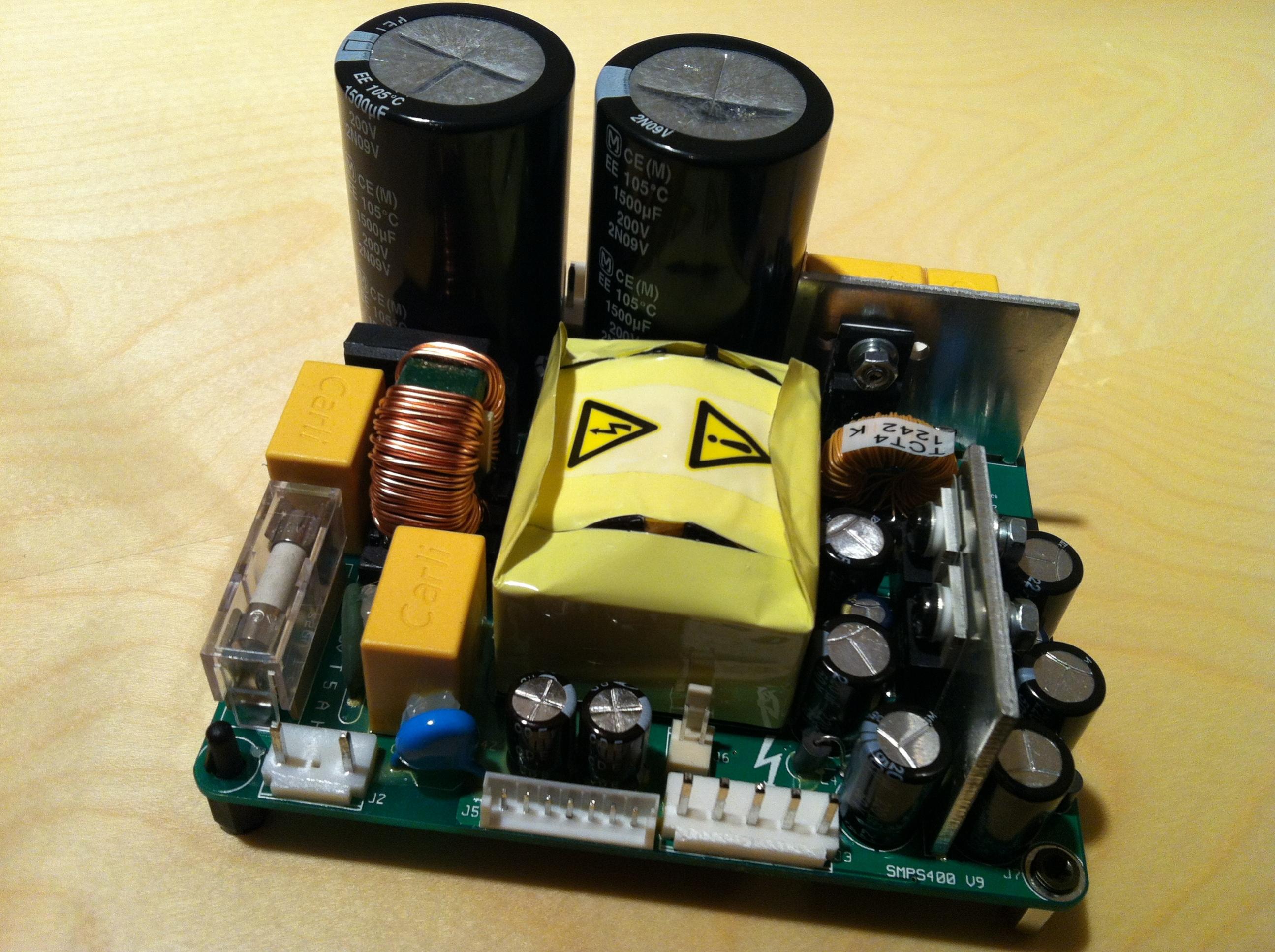

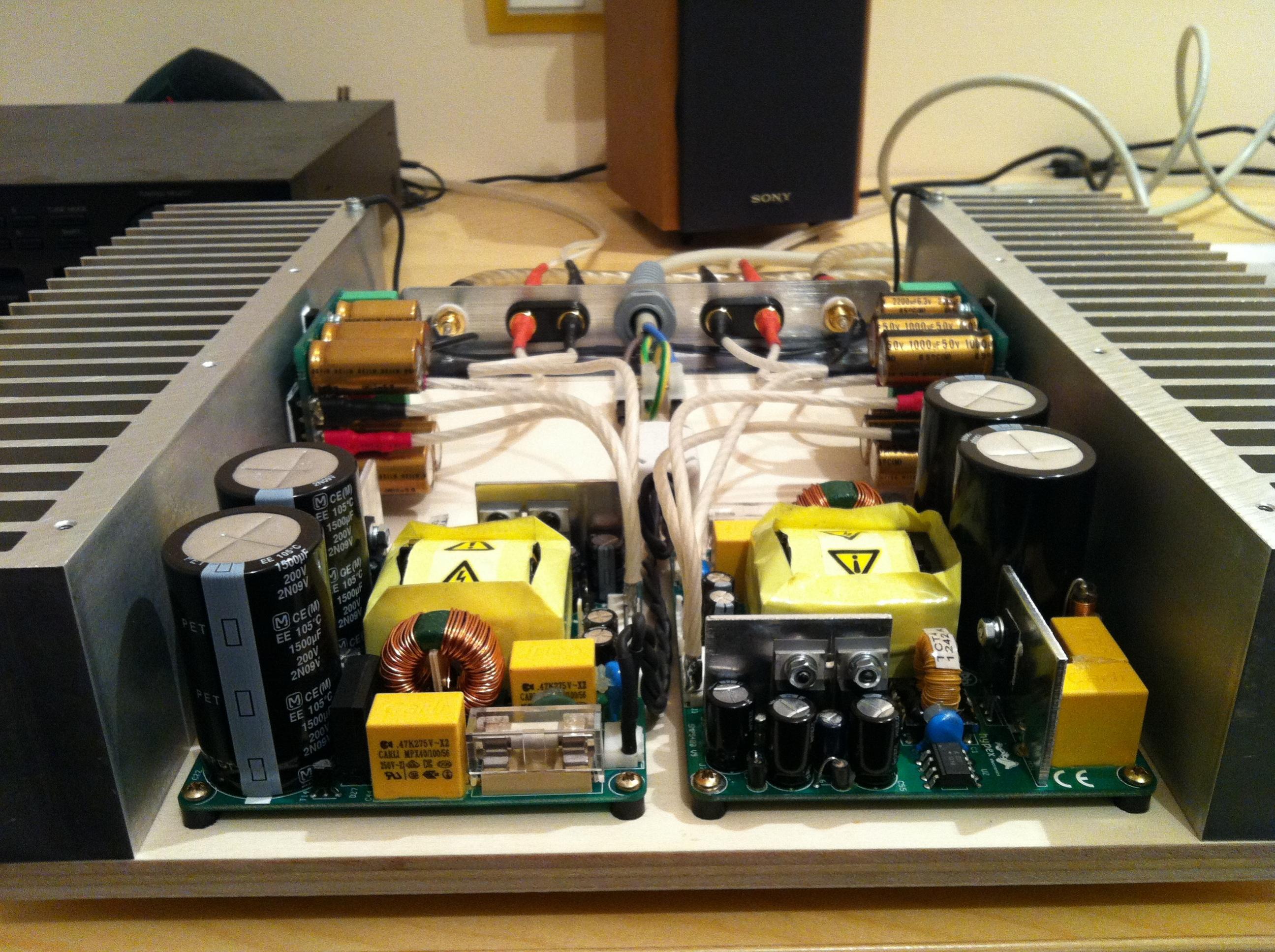

As you all probably know my demo VSSA amp has original Hypex SMPS400A180 power supply installed, simply because of better sonic quality compared to linear PSU. But original SMPS had SAMWHA elcos all-over PCB, so I made some measurements before and after and got significantly better results when re-caped all elcos with Panasonic. Since SMPS is unregulated (emulates linear PSU) voltage drop at constant 5 A (8 Ohm load on PSU output) is now only 2 V, before 3,5 V, and ripple 1 Vpp, before 2,5 Vpp, also 100 kHz switching carrier as ripple is now only few mV. Tomorrow these new SMPS-s will be installed in demo unit and sound check will follow.

I already expressed my feelings about SMPS400A180 upgrade with Panasonic elcos in post #1053
So far the best possible PSU to supply single VSSA channel and it is uncomparable with linear PSU, so much better. Current on demand - always there when needed.
Tune-up of SMPS400A180 as follows:
- 820 uF/200 V SAMWHA replaced with 1500 uF/200 V Panasonic EE
- 100 uF/100 V SAMWHA replaced with 220 uF/50 V Panasonic FR
- 10 uF/100 V SAMWHA replaced with 47 uF/63 V Panasonic FC
- 4,7 Ohm NTC shorted after 2 s from power-up
- PSU connection wires soldered directly
Mid-range presentation lively realistic, enormous energy in low-range, even more transparent and controlled bass.

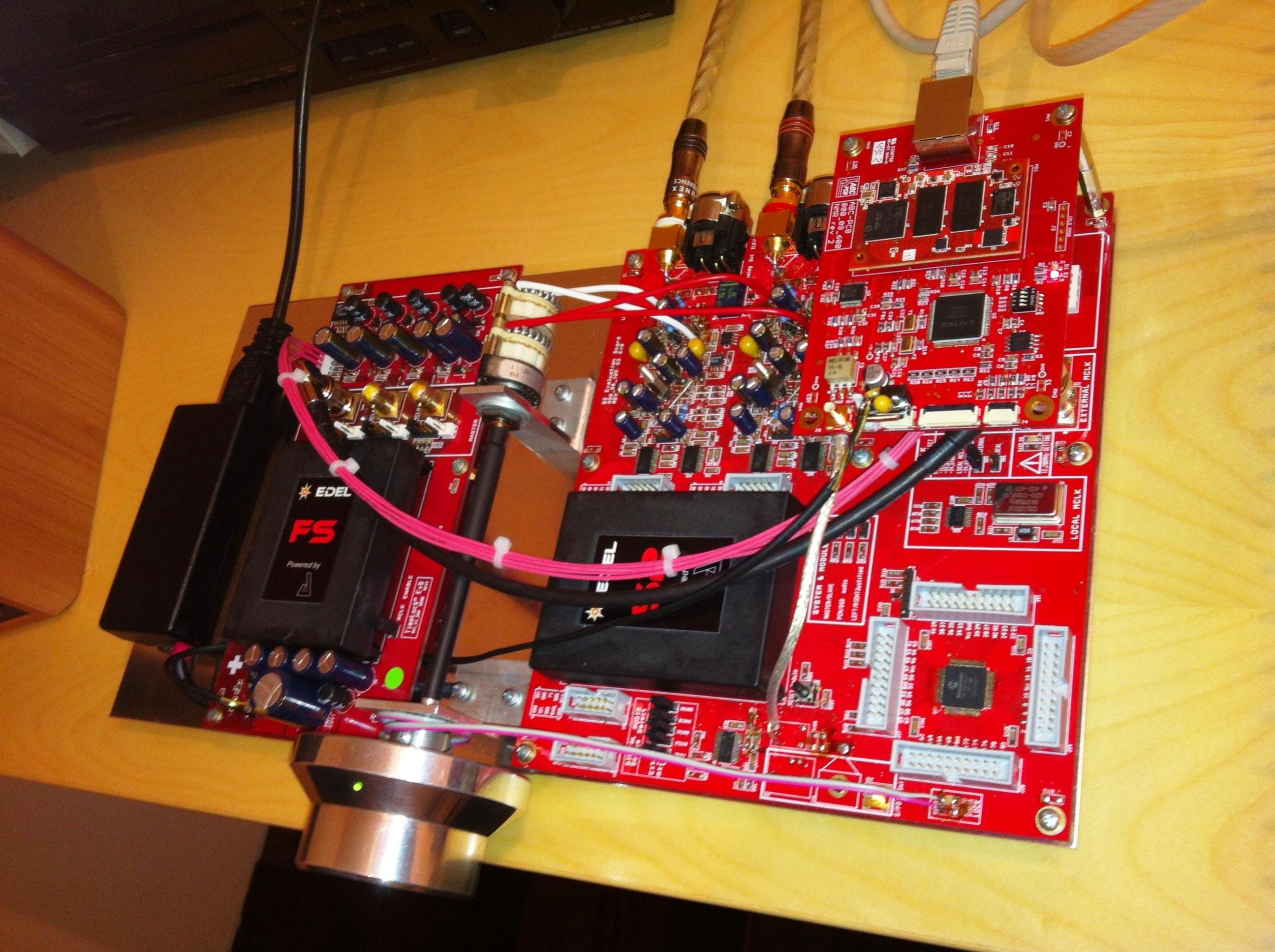

There you go again, making us jealous... (first the speakers, now my poor old DAC)... 😉You can also see new demo Streamer-DAC as a music source...
New Streamer-DAC still not in Anagram Streamer-DAC (picture) league which I own from before. Still few modifications ahead to be done to even come close or maybe not at all. 🙄
