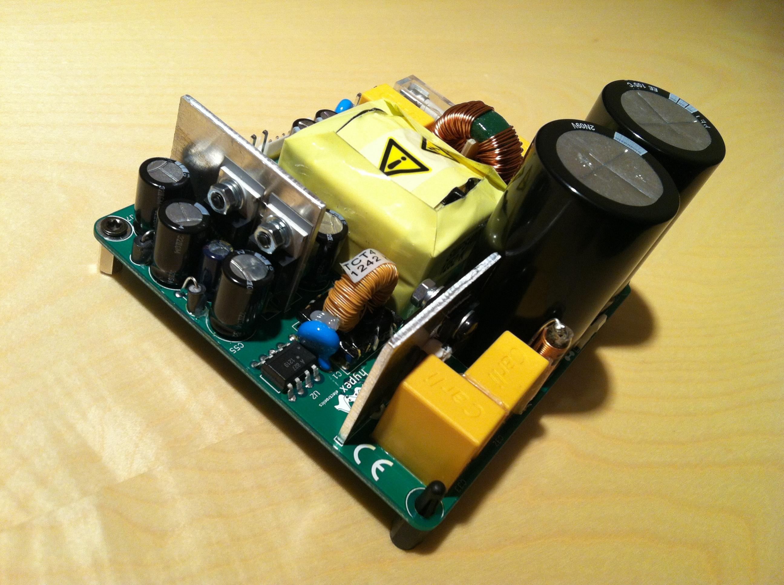

As you all probably know my demo VSSA amp has original Hypex SMPS400A180 power supply installed, simply because of better sonic quality compared to linear PSU. But original SMPS had SAMWHA elcos all-over PCB, so I made some measurements before and after and got significantly better results when re-caped all elcos with Panasonic. Since SMPS is unregulated (emulates linear PSU) voltage drop at constant 5 A (8 Ohm load on PSU output) is now only 2 V, before 3,5 V, and ripple 1 Vpp, before 2,5 Vpp, also 100 kHz switching carrier as ripple is now only few mV. Tomorrow these new SMPS-s will be installed in demo unit and sound check will follow.

Unregulated SMPS has its advantages, since it operates at constant duty cycle at 100 kHz ensuring maximal charging of output caps at all times and not interfering with amp from its (non)regulation influence. Present ripple and voltage drop are not so important (very good PSRR) as current on-demand now always available. 😎
