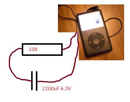

Pre-treatment for the feedback EL-cap

I have build one channel of VSSA 1.4 using thru-hole parts.
I could not buy Nichicon FG 2200uF EL-cap for reasonable price so I bought the following:
Rubycon ZL - Buy Aluminium Capacitors Capacitor,electrolytic,aluminium,radial,105C,6.3V,2200μF,20%,6.3ZL2200MLST10X23 Rubycon 6.3ZL2200MLST10X23 online from RS for next day delivery.
and
Panasonic FR - Buy Aluminium Capacitors Capacitor,Electrolytic,Aluminium,radial,low impedance,10V,2200F Panasonic EEUFM1A222 online from RS for next day delivery.
I did some prep work on the Rubycon ZL before I used it and it does sound better than the brand-new Panasonic FR.
I suggest that we should order parts & do some prep works whilst waiting the kits from LC.
