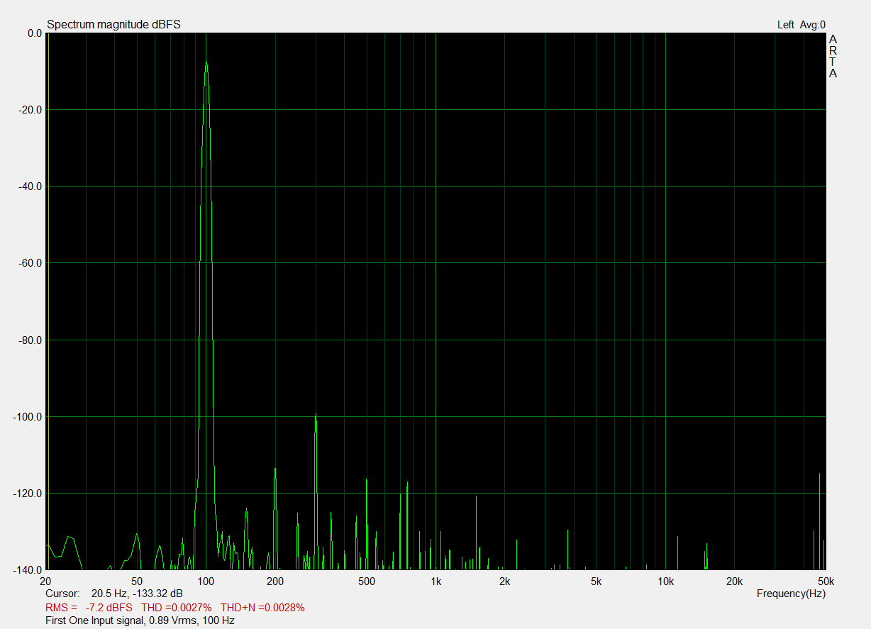

How around 100Hz ?

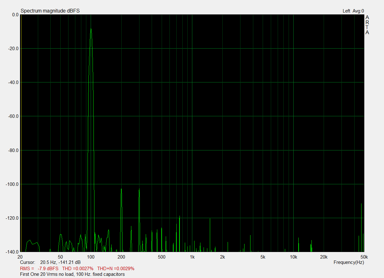

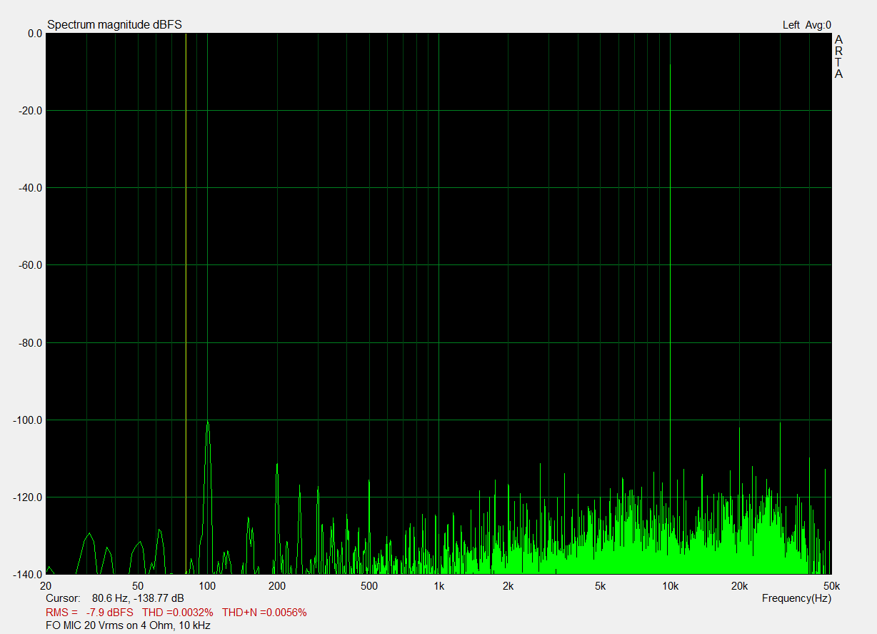

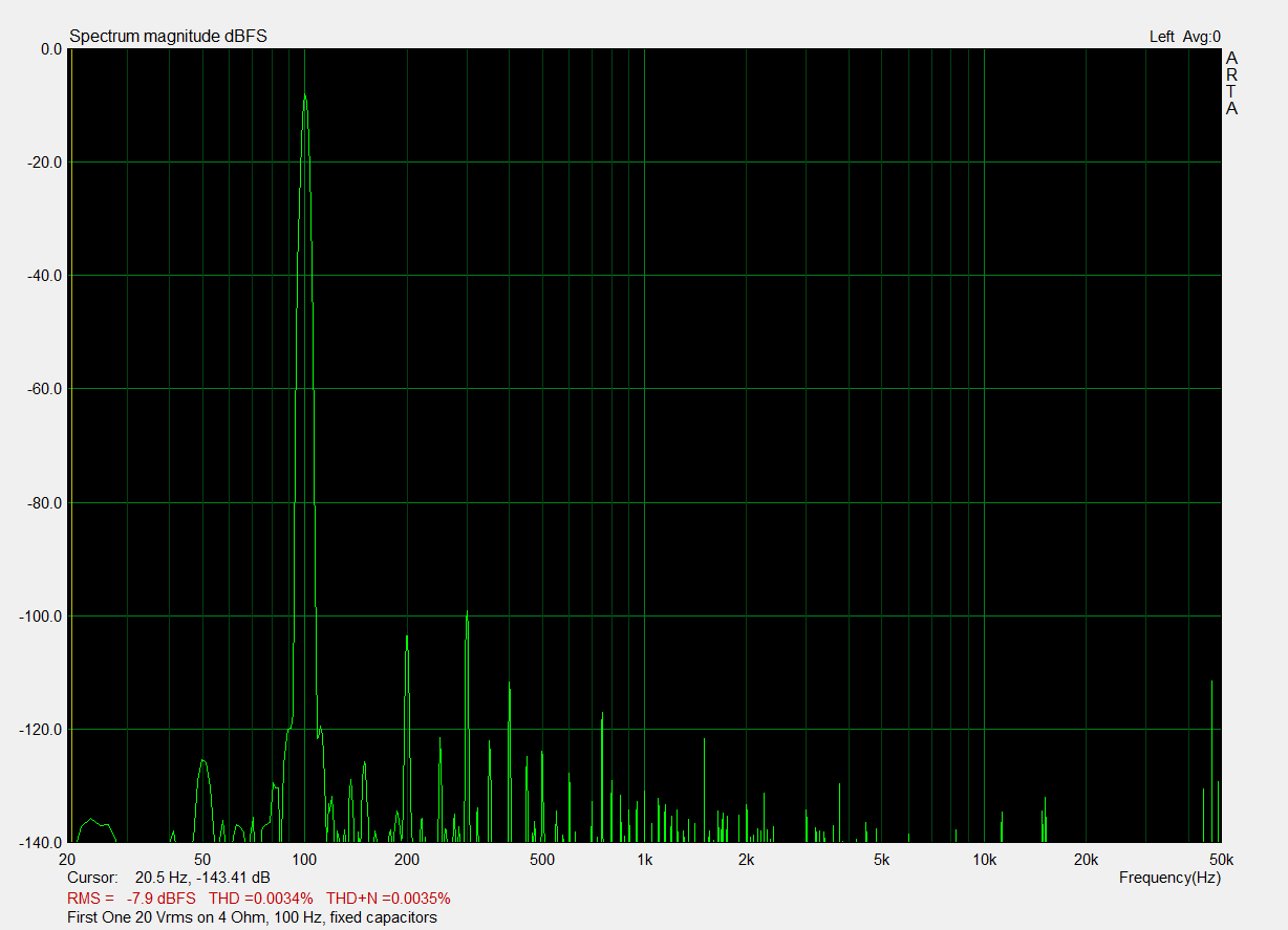

Here are the requested plots of the First One amplifier, 34 ppm THD 100Hz at 100 Wrms/4 Ohm
1. Input signal 100 Hz
2. Output signal 20 Vrms, no load
3. Output signal 20 Vrms on 4 Ohm

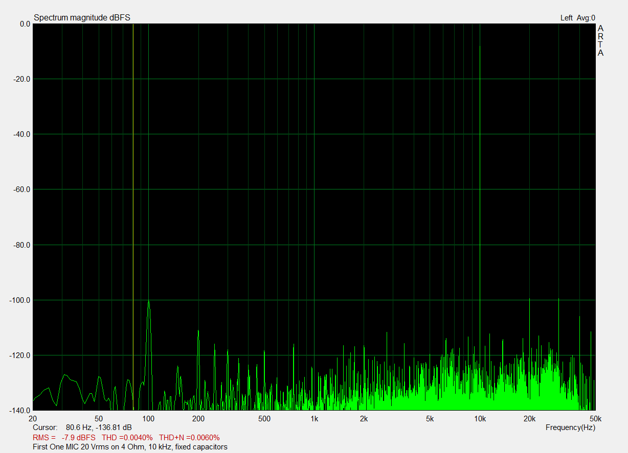

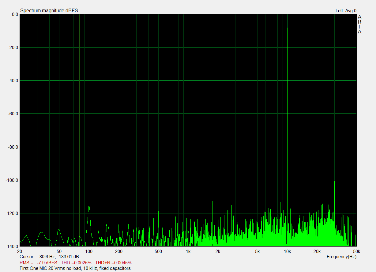

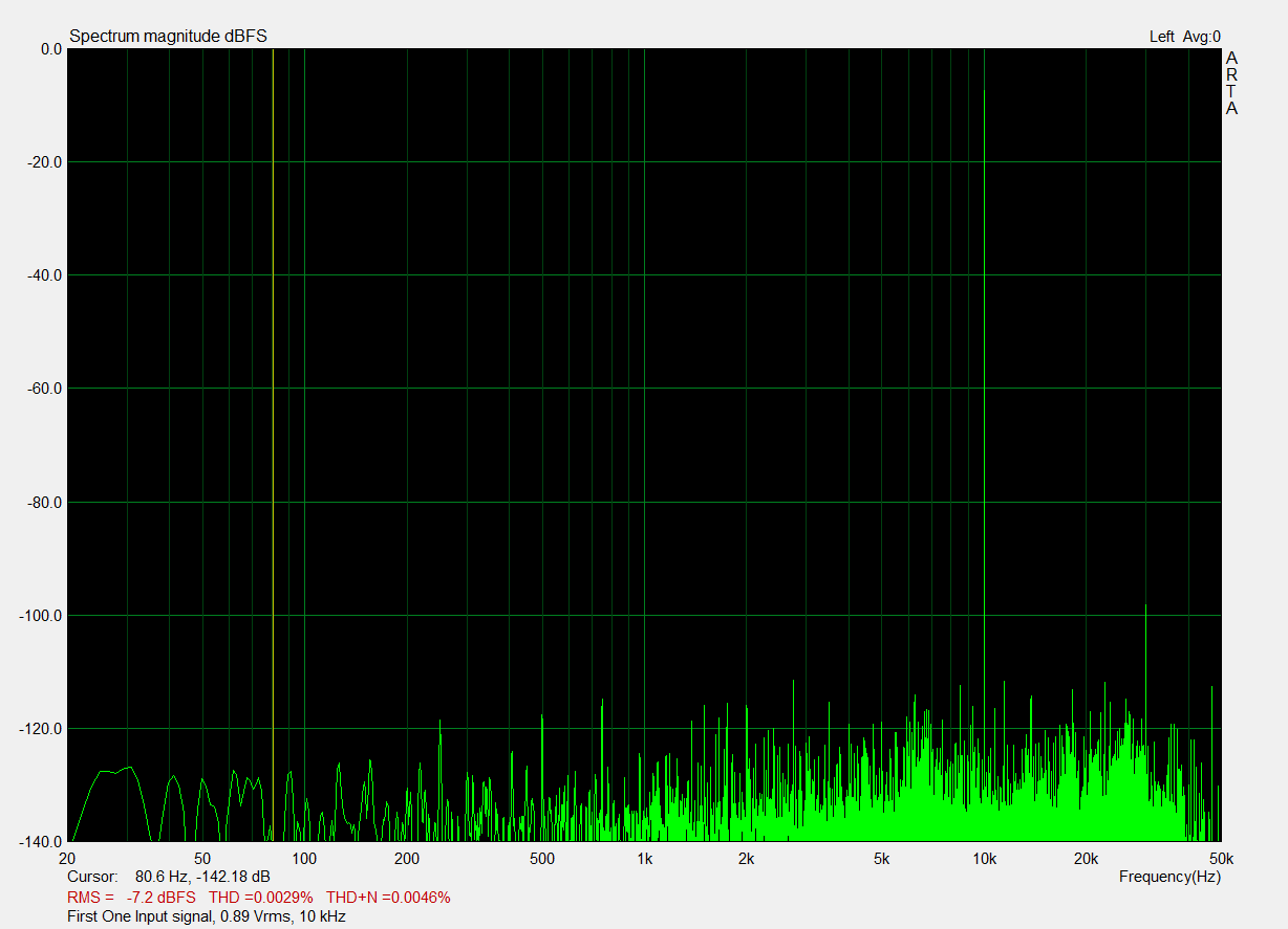

Now these 10 kHz plots and previous 100 Hz plots both series made today with fixed compensation SMD capacitors installed on PCB. Practically it is impossible to find the combination set by trimmer capacitors, but anyway very close results as before.
Plots of the First One amplifier, 40 ppm THD 10 kHz at 100 Wrms/4 Ohm
1. Input signal 10 kHz
100 W/4 Ohm from 100 Hz to 10 kHz THD changes from 34 to 40 ppm, only 6 ppm difference 😎

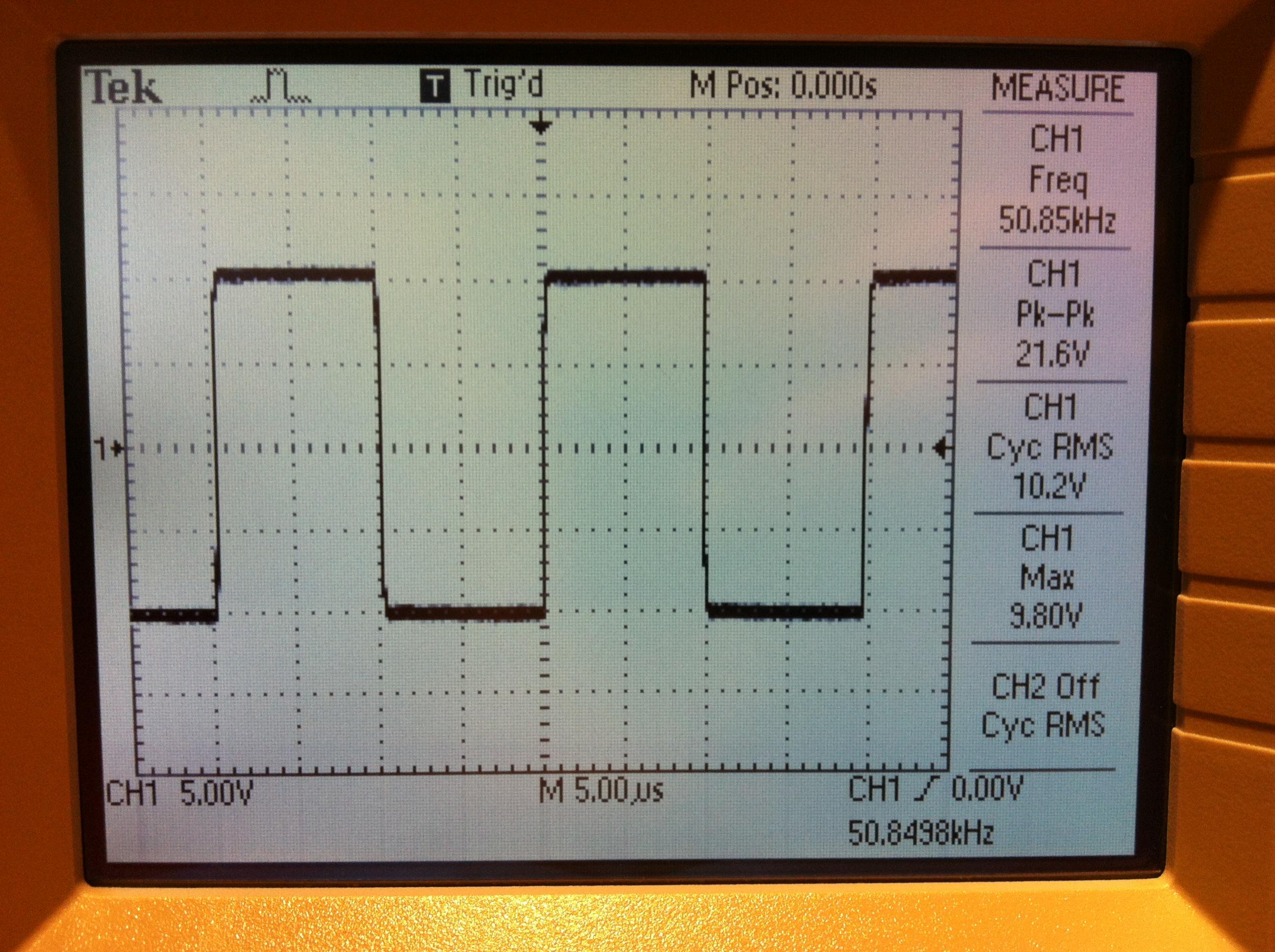

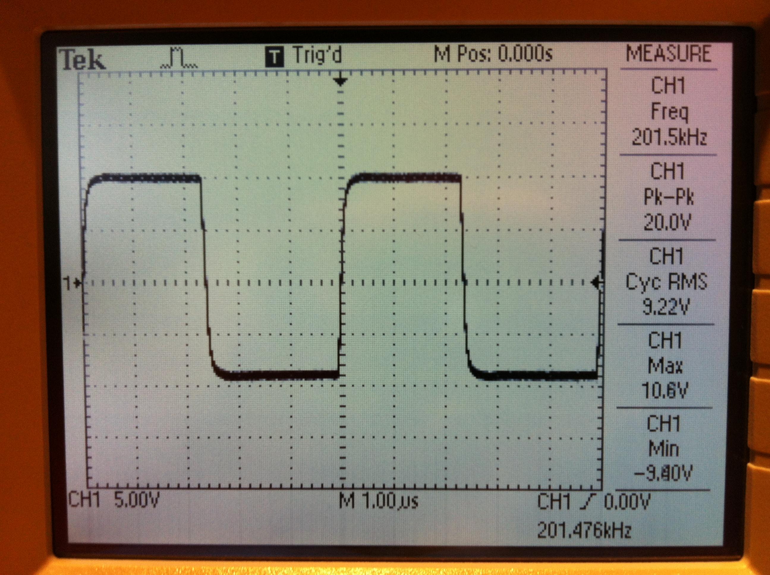

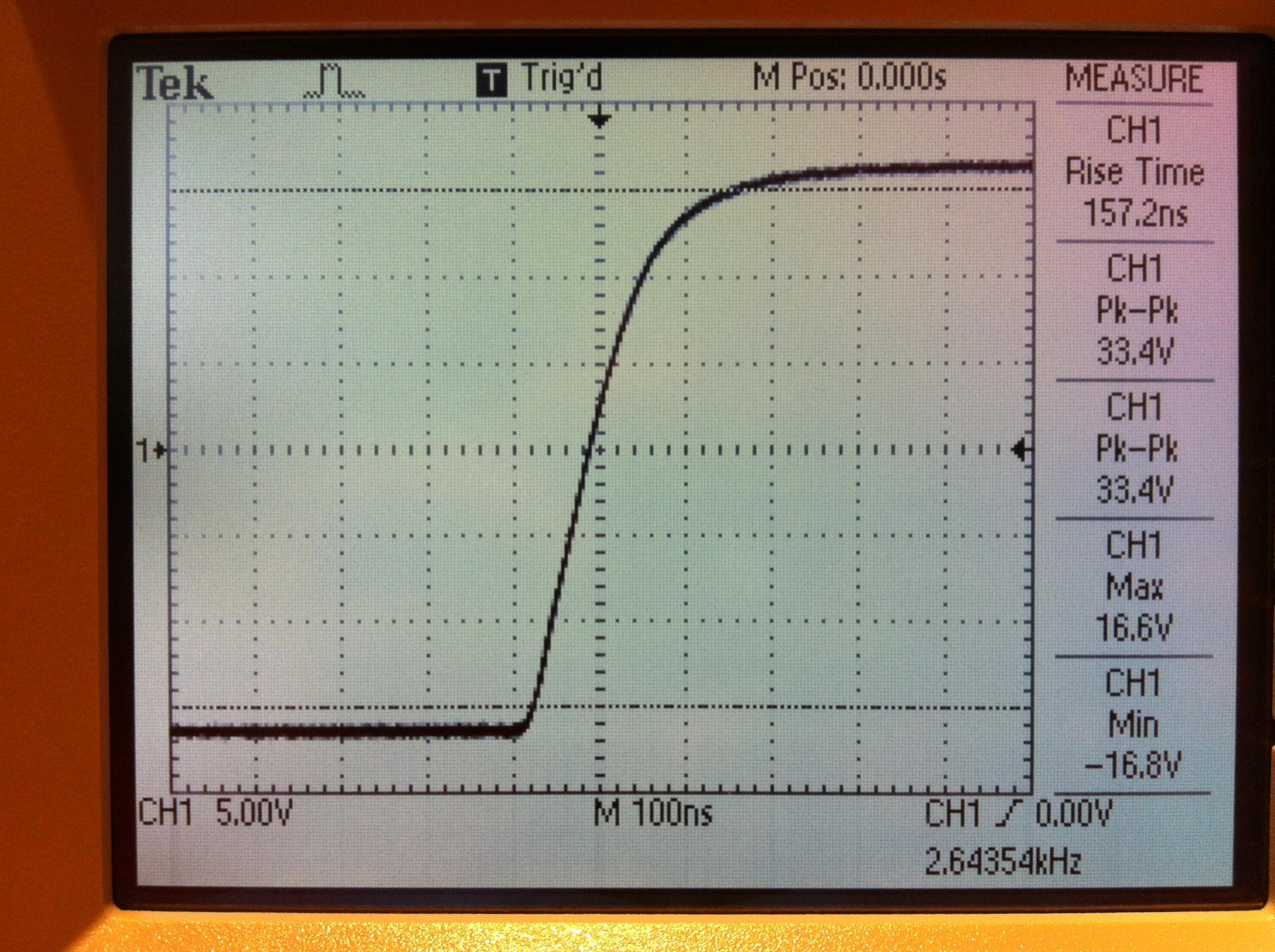

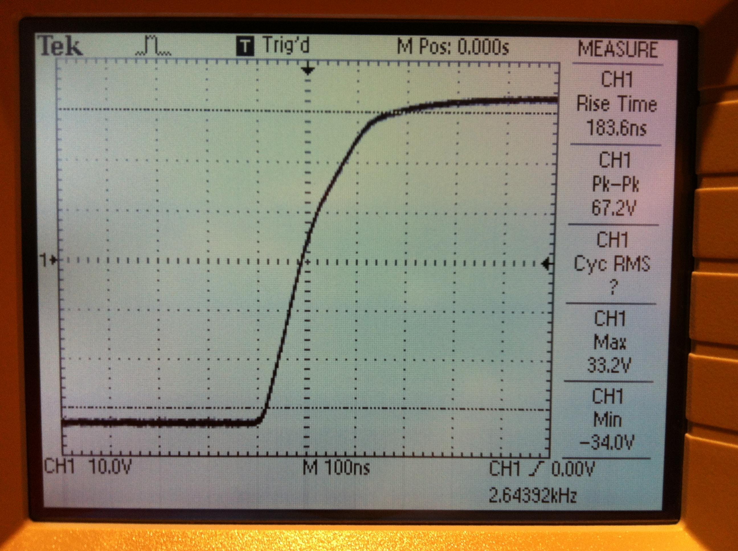

Few square waves and rise time measurements of the First One amplifier module.
1. 50 kHz
2. 200 kHz
3. mid signal level rise time
4. high signal level rise time
Calculation from pic.4, 60 V (90% Vpp) in 250 ns results in:
Slew Rate of 240 V/us

Assuming a single pole bandwidth for the amp, there's a simple relation between bandwidth fc and the 10% to 90% risetime, tr.
fc = 0.35 / tr
You have 1.4 mhz...not bad 🙂
