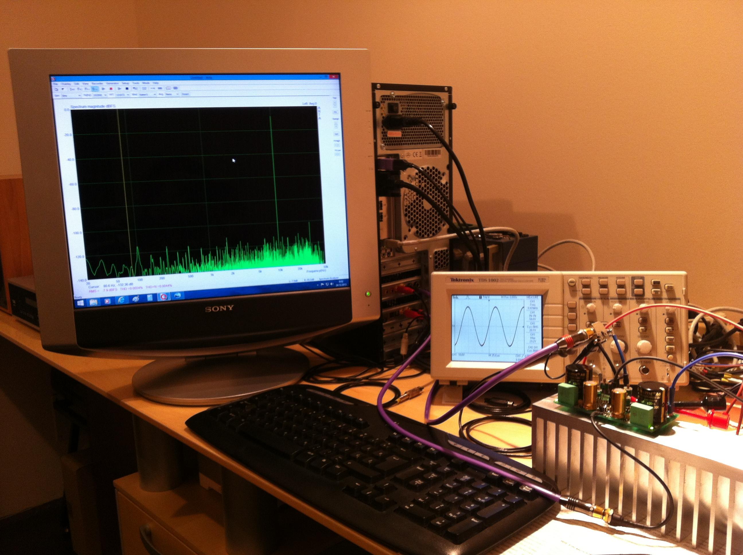

And this is how it looks when measuring with ARTA system.

Yes a lot of fun watching response on the monitor, any little change can make a difference so learning to use the system to get good results is very educational.
Also in general the ARTA measuring system just confirmed what I was doing before with just my Tek scope. Namely measuring amp's HF signal spectrum with 3 MHz carrier, tuning to lowest distortions has the same effect as now watching and tuning audio spectrum. HF compensation can make a lot of difference to THD and therefore the PCB layout comes into rule at this point as a general component of the amp, besides topology.
VSSA was also tuned to lowest HF distortion before releasing to GB, we could get something in between 5-8 dB THD improvement if implementing Cherry plus Miller compensation, but that would be more of academic act than real step forward to better sound. I think VSSA is somehow concluded project, not because there's no interest but because of 26 weeks lead time to get ALF mosfets. I would not even dare to think to go through the same path as I had with Semelab, so for me it is the end of the story.

Nice declining distortion spectra of the First One !

Besides ARTA I've also used REW5 with my speakers, it seems that you can also use REW5 for amplifier measurements.

Yes realy nice monotonic declining harmonic spectrum I got from the First One. Will check out the spectrum also with lower power levels ie. 1 W and 10 W, because input sine signal from the card is much clearer then.
For now ARTA is sufficient for my work showing me all the data I need, will do upgrading soon.

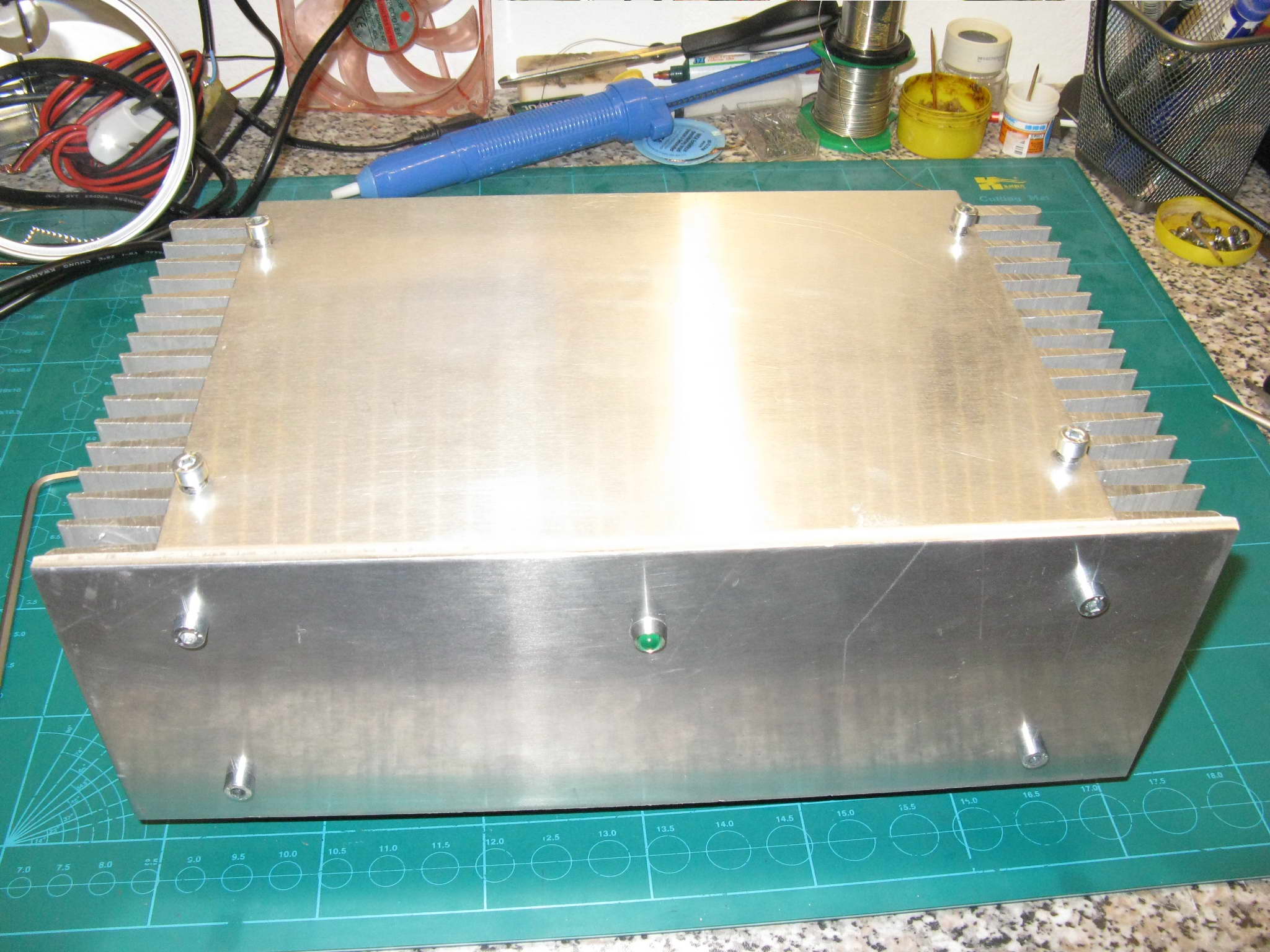

Very nice finish vgeorge. :up:
Any problem with GND loops, hum etc.?
Speakers will be ...

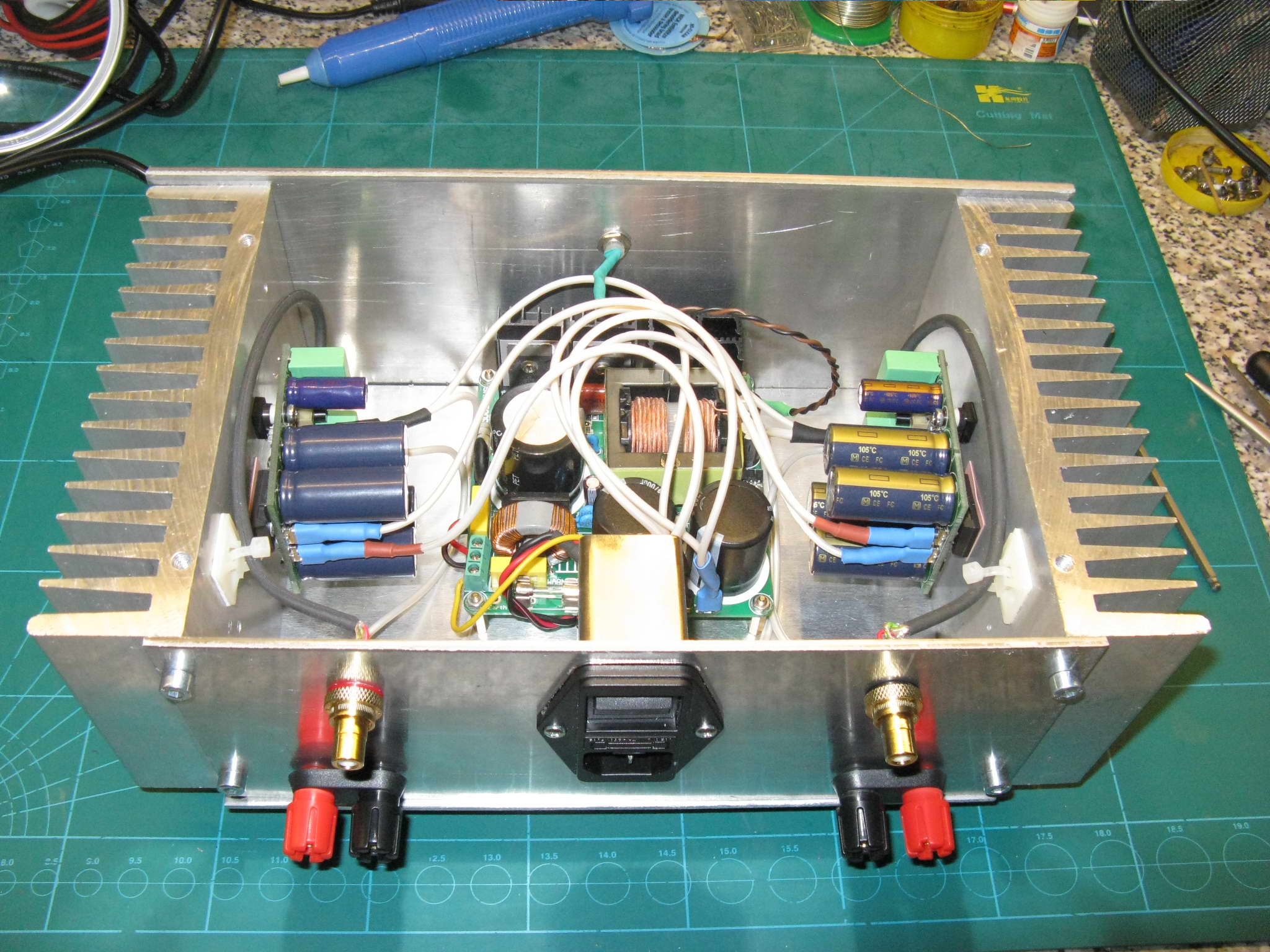

No problems with hum or ground loops. Completely silent.
Speakers are horns around 100dB. Have a look here : http://www.diyaudio.com/forums/multi-way/186540-my-island-speakers.html
I have Aleph J, Baby Huey (el84 pp from another thread here) and Sonny' s TSSA running in class A with dual SMPS.
This one and Sonny' s are my favorites do far. TSSA maybe a tad sweeter on the top, VSSA a little more dynamic. Differences depend on taste and mood mostly. I love both of them so far.
One note though, I prefer both of them without the bypass feedback capacitors.
