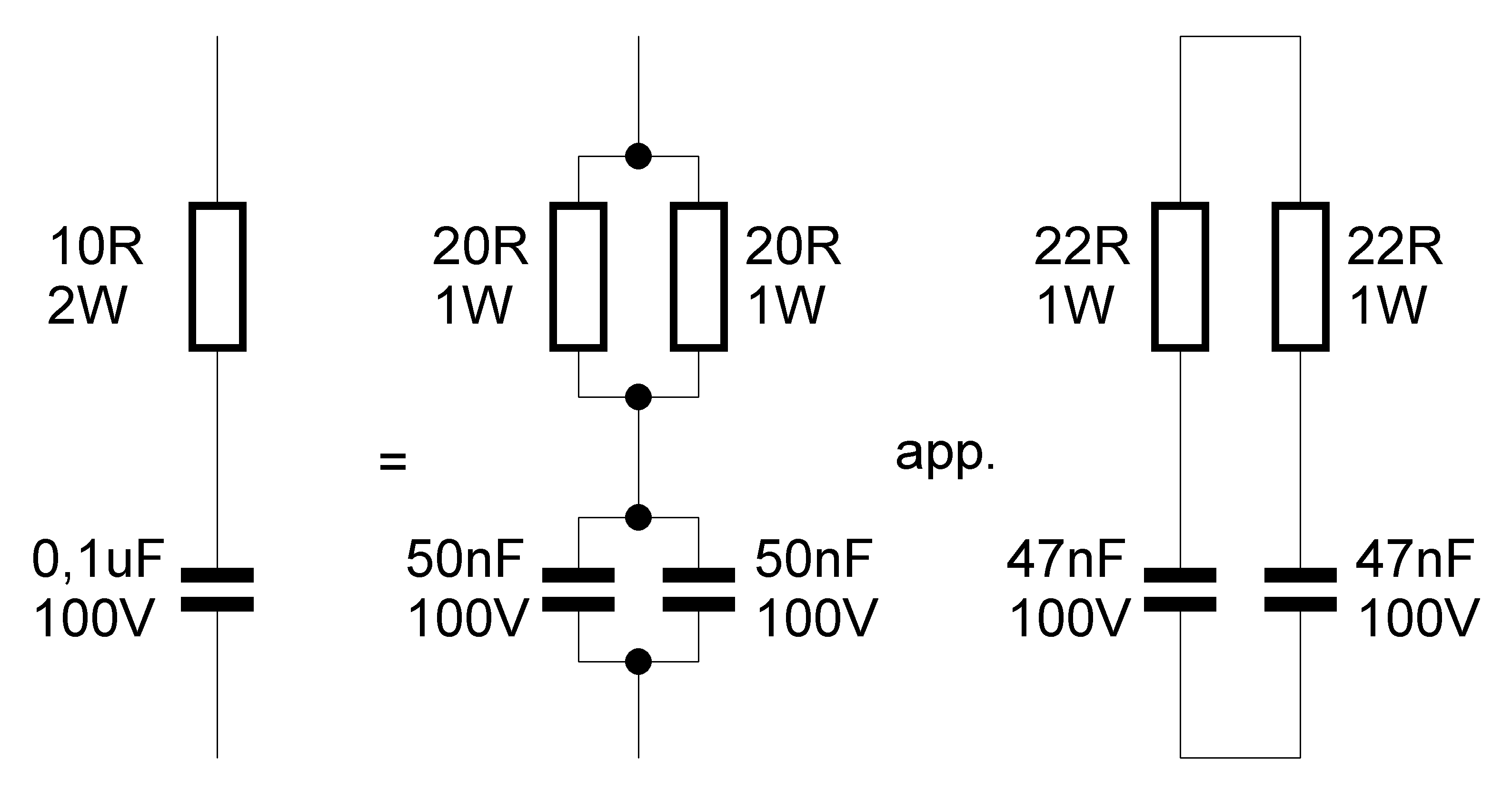

I attach picture from earlyer this thread about zobel network. If you break the two onboard, it could be repaired external either temporary or permanent with the 10ohm/100nF config.

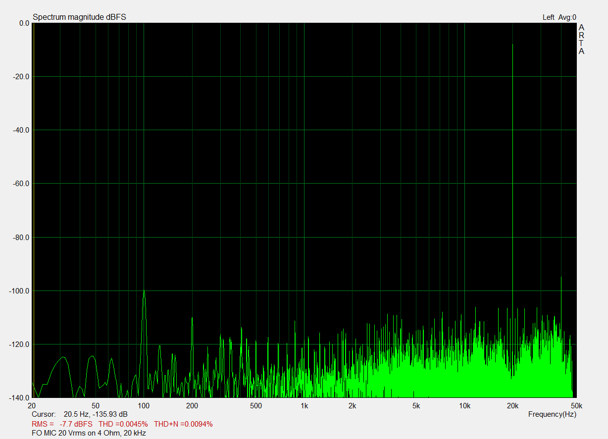

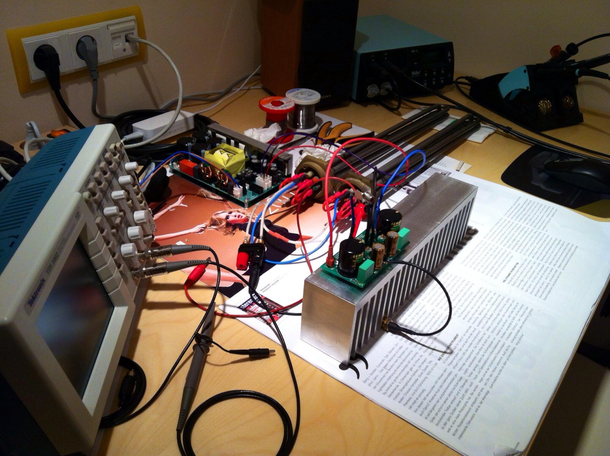

Today's play with MIC, measurements showed 45 ppm THD20, 100 Wrms/4 Ohm, slowly getting there. Half THD than with Miller only from post #3052. 😎
Yes water heaters 3*2,5 kW times two, all in parallel, so 4 Ohm plus tiny inductance in series, almost a speaker simulation. 😀
It is 15 kW all together. 😱
Did you guys note 45 ppm THD20 at 100 Wrms/4 Ohm, I am really pleased.
Hi BYRTT,
there are two 20R resistor . both have some brown marks but one of them is open. I have soldered a 20R through hole resistor over the open 20R and have powered up both channels and tested it. The dc offset, input , output bias current are all ok.
NOw playing music through test speakers and sound clean and nice.There appear to be ground loop problem in both channels that i am troubleshooting now.
Is there any possibility of failure in the C of the zobel??
What is the effect of malfunction zobel circuit ?
thanks again
kp93300
1- Not really.1-Is there any possibility of failure in the C of the zobel??
2-What is the effect of malfunction zobel circuit ?
2- Possible oscillation.
Groundloop see post #2534 point 3 and 6, think point 3 make your solution......There appear to be ground loop problem in both channels that i am troubleshooting now.
thanks again
kp93300
Don't think you can destroy cap in zobel, the resistor is the fuse there.
I remember earlyer in thread that VSSA is tested to run without the zobel, it only sits there to protect HF oscilation with complicated loads (especially exsotic speaker cables). Example if you run simple 1-3 meter 0.5-1,5mm solid speaker cable into a full range speaker, VSSA is staple without zobel, but one is on own responsibility when not following standard setup.
Immersion heaters I would say! What is the impedance on those things LC?
All heaters together in parallel 4 Ohm plus 0,12 uH inductance in series.
At 20 kHz it comes to 4,015 Ohm, so I set 20,1 Vrms to get exactly 100,6 Wrms for spectrum measurements and result is 45 ppm THD20 😉

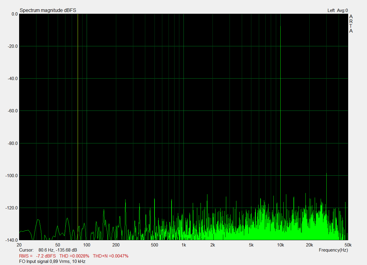

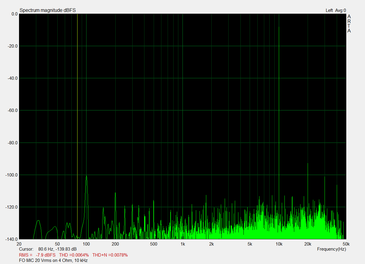

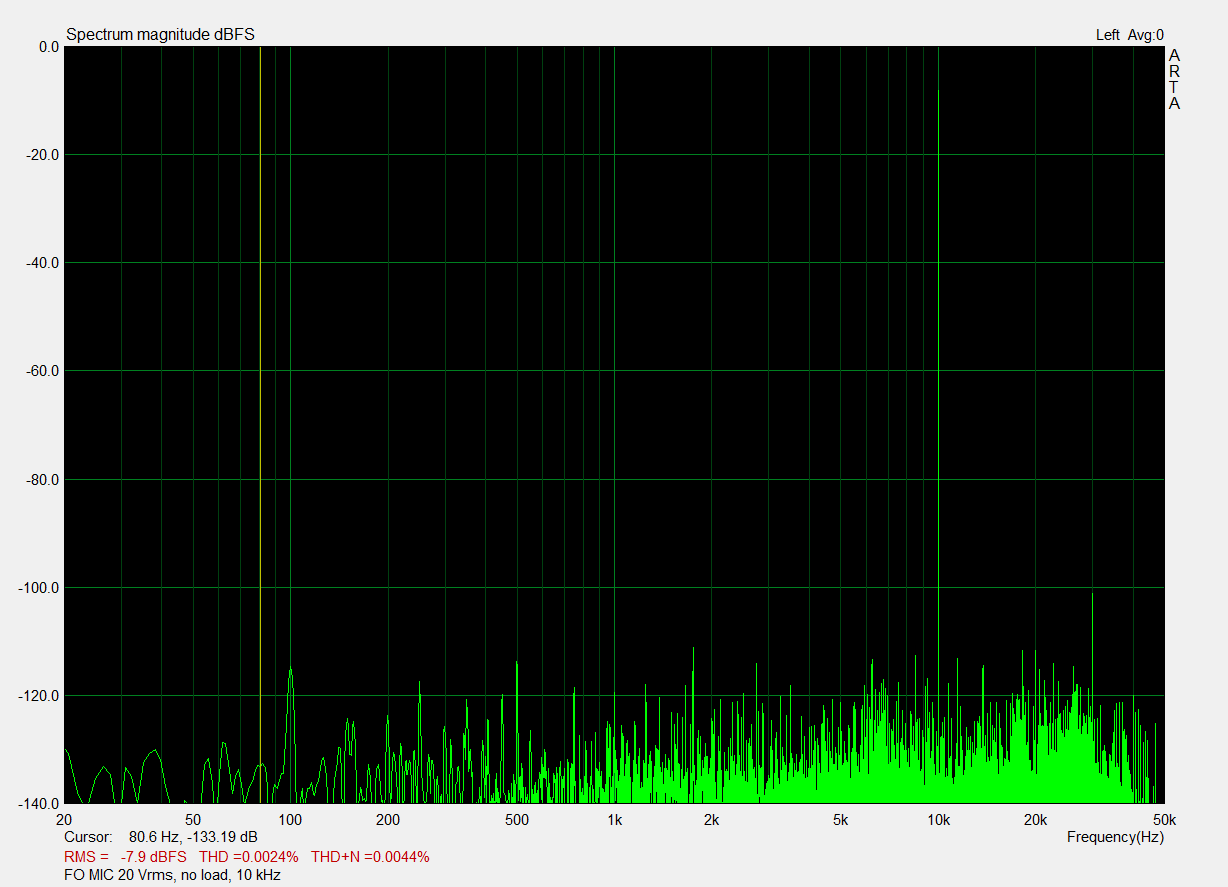

Today's 10 kHz measurements:
1. Input signal spectrum
2. Output signal 20 Vrms, no load
3. Output signal 20 Vrms on 4 Ohm
Third harmonic is the same as present in input signal. While loaded at 100Wrms/4 Ohm, only second and fourth are higher, third unchanged. Distortions are only 64 ppm the same as simulated on very much complex CFA designs.
With better input signal the amp itself would present also lower THD. Interestingly First One has even harmonic character, although these are very low, that can sound nice and pleasant.
First One is now ready to enter the market. 😀
