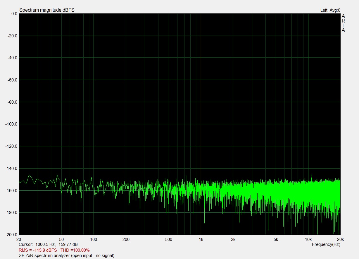

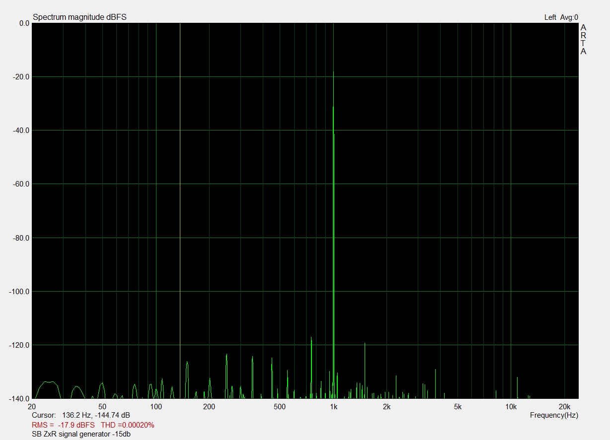

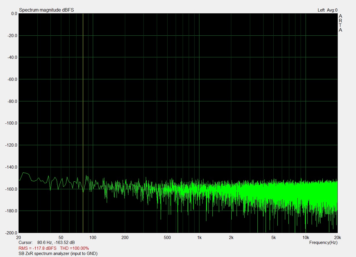

SB ZxR-ARTA measuring system for the First One
Being busy lately putting together measuring system for testing forthcoming First One amplifier modules. For that reason I assembled PC with SB ZxR audio card and the results are Quite impressive.
Spectrum analyser and signal generator formed by combining SB ZxR plus ARTA sofware are very capable one, just for an example of their performances three images are attached.
1. noise floor of an input shorted to GND
2. noise floor of an opened input
3. 1 kHz test sine from signal generator has just 0,0002% THD

Very impressive, and congratulation with new toy. How does card sound. Maybe i am stupid, but wonder that the input output converters range 120-127dB, how can you measure so deep.
It probably sounds nice, the only reason I bought it is to measure and compare different HF compensation methods on First One to get best performance to sound result. It will just serve to record and compare spectral signatures to find the best possible signature, such info would be also very helpful to develop any future designs.
ZxR card itself has 124dB signal to Noise Ratio (20kHz Low-pass filter, A-Wgt), more here. 😉

Hehe... the best is when miller cap (if any) is fed... lowZ... direct from output, right ?It probably sounds nice, the only reason I bought it is to measure and compare different HF compensation methods on First One to get best performance to sound result
They have put complicated names for this ;-)

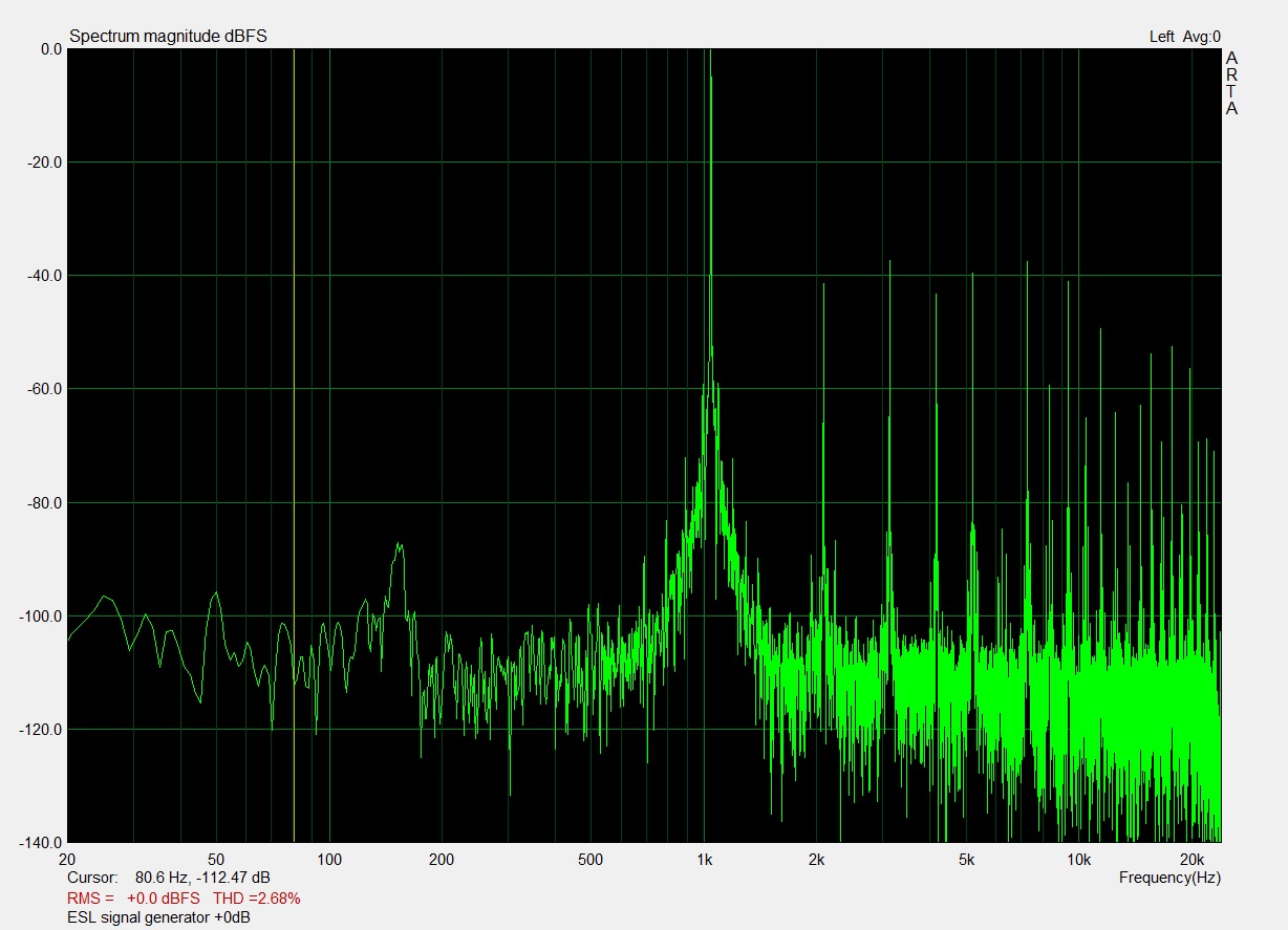

hahaha just tested my old Elektor signal generator - sine 1 kHz 😱
Maybe you should mod your signal generator and put a VSSA type output section on it 😀
