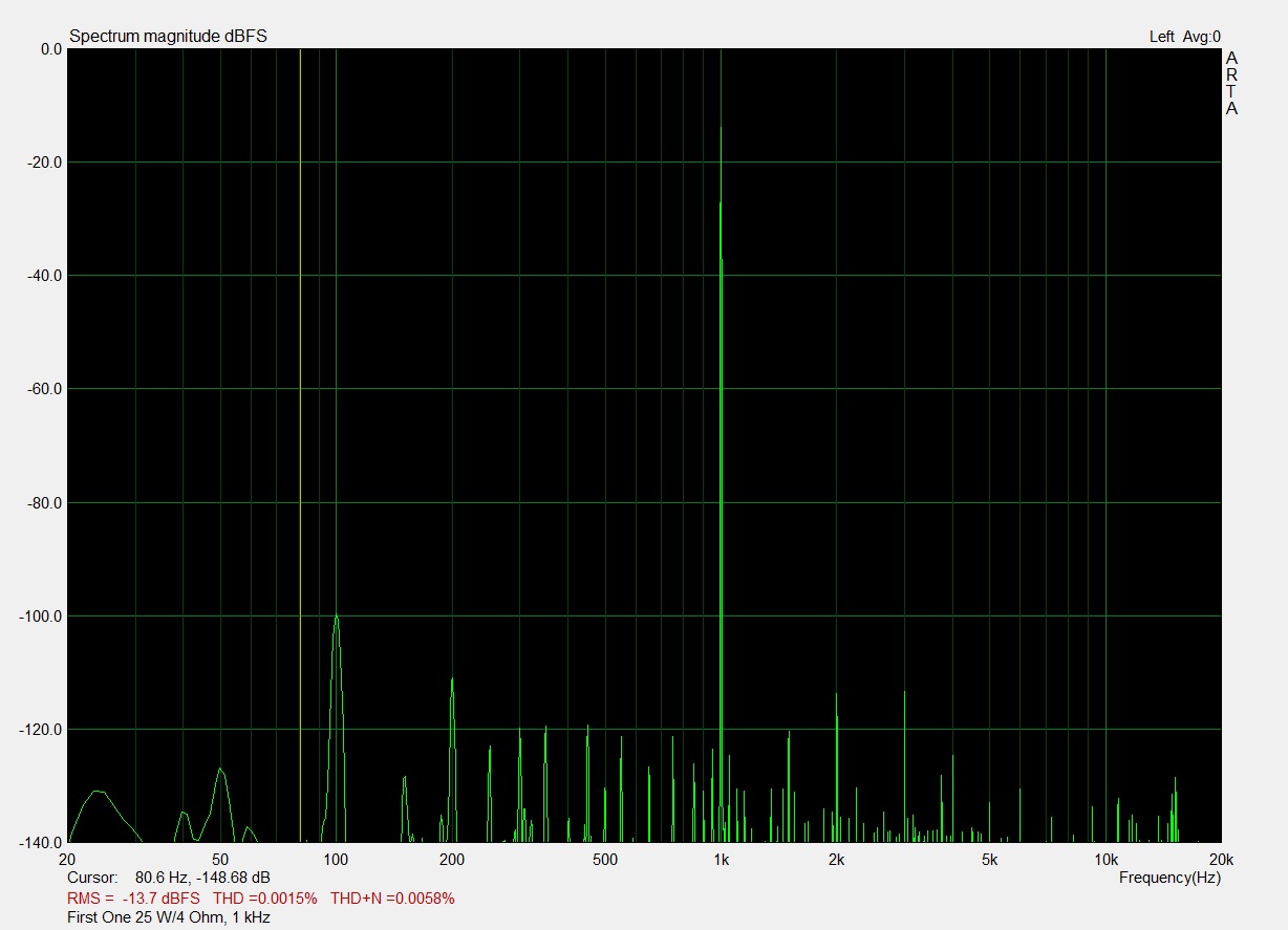

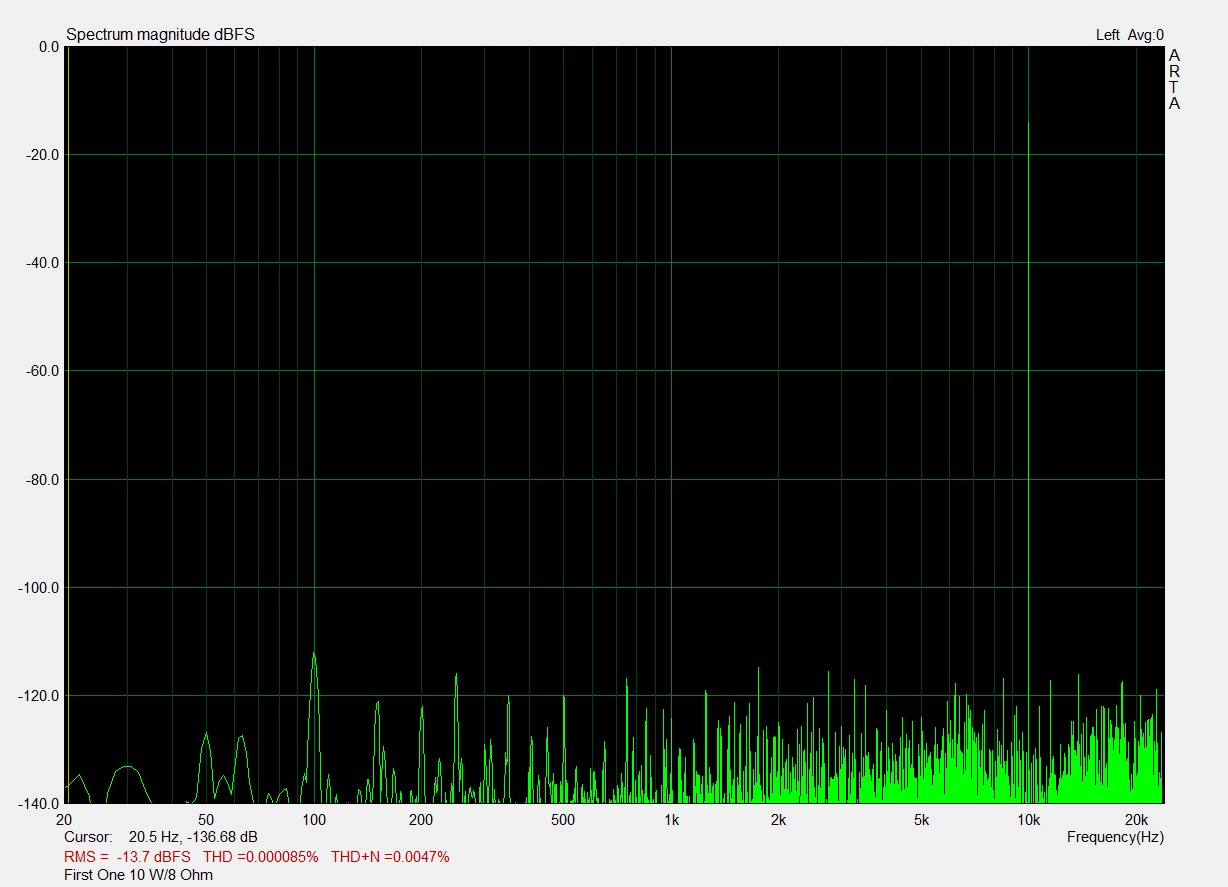

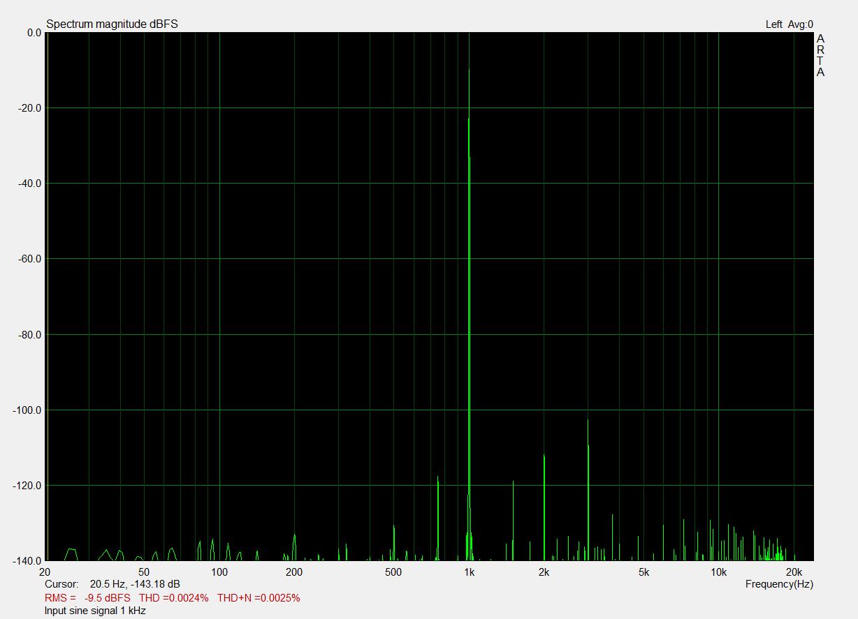

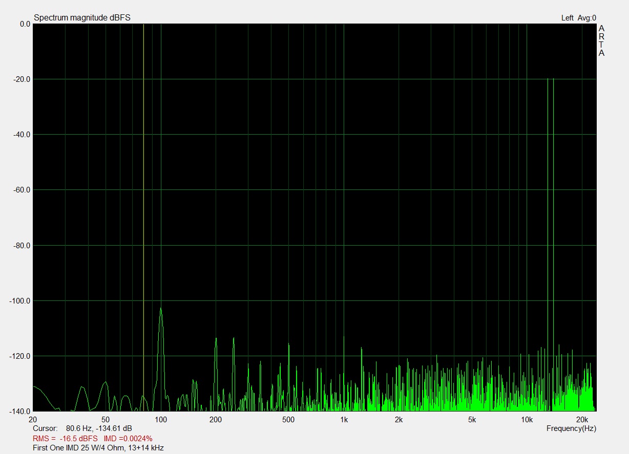

Hi guys

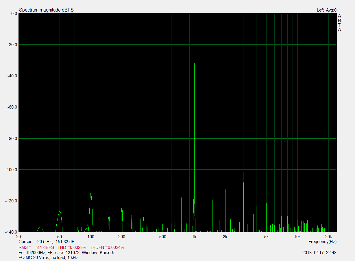

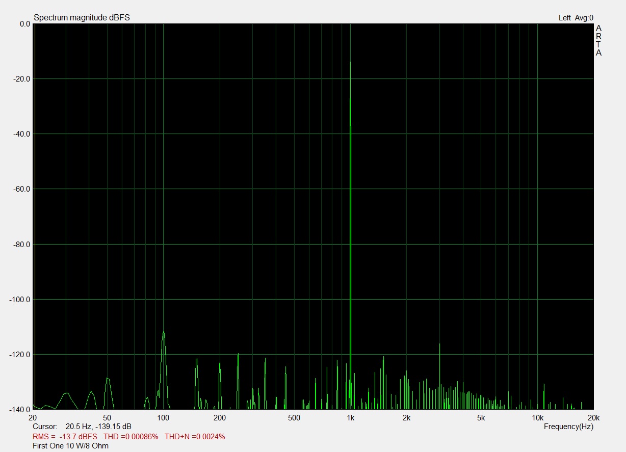

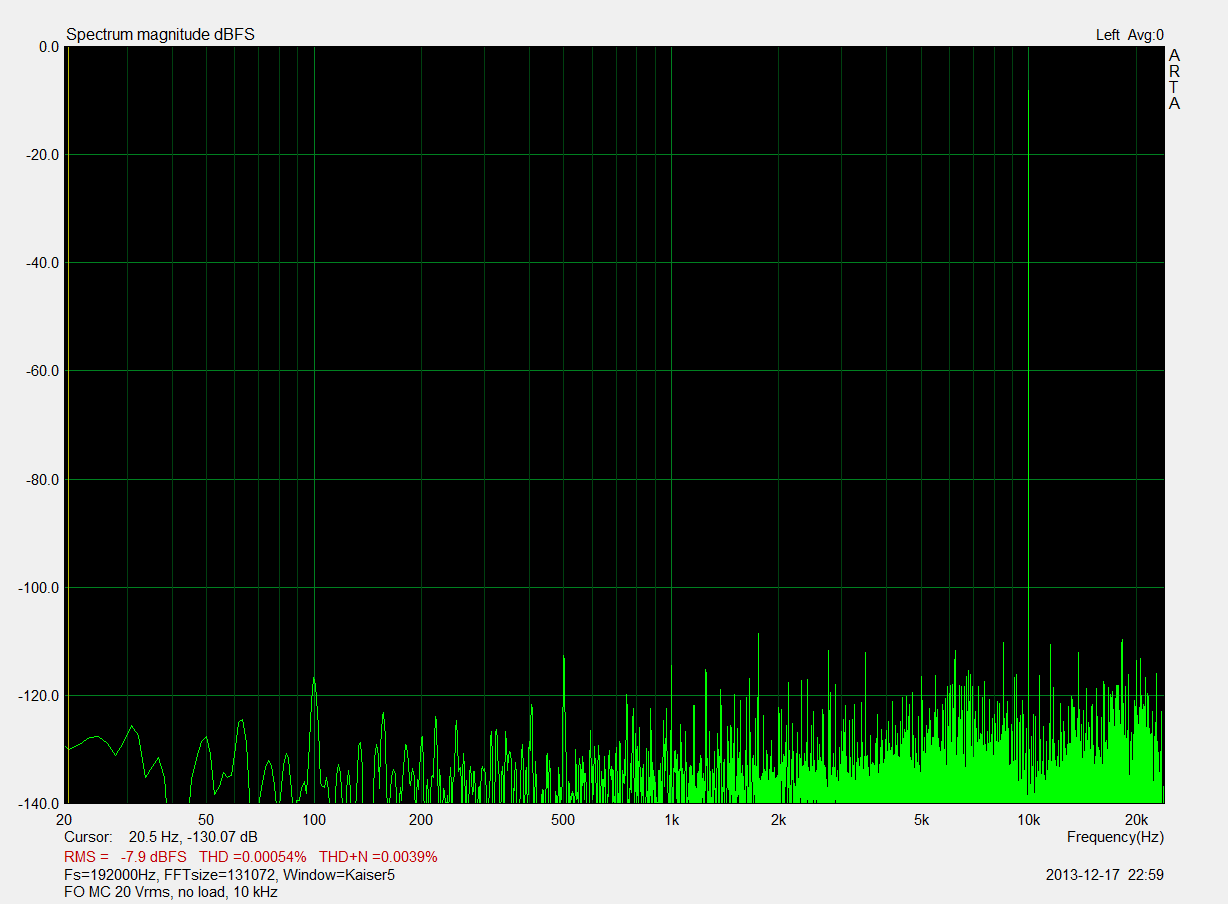

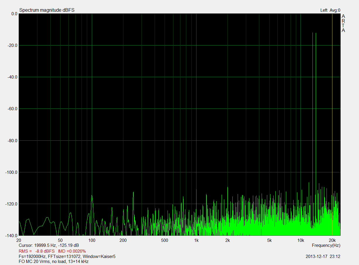

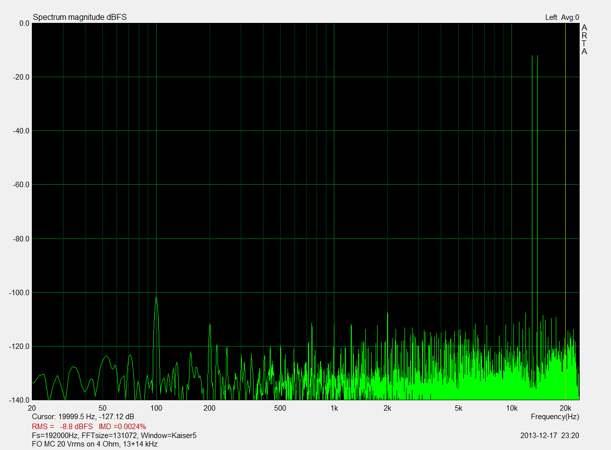

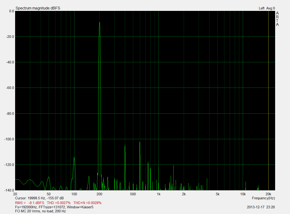

First One with Miller compensation, real measurements 10 W/8 Ohm and 25 W/4 Ohm, plus intermodulation 13+14 kHz 😉

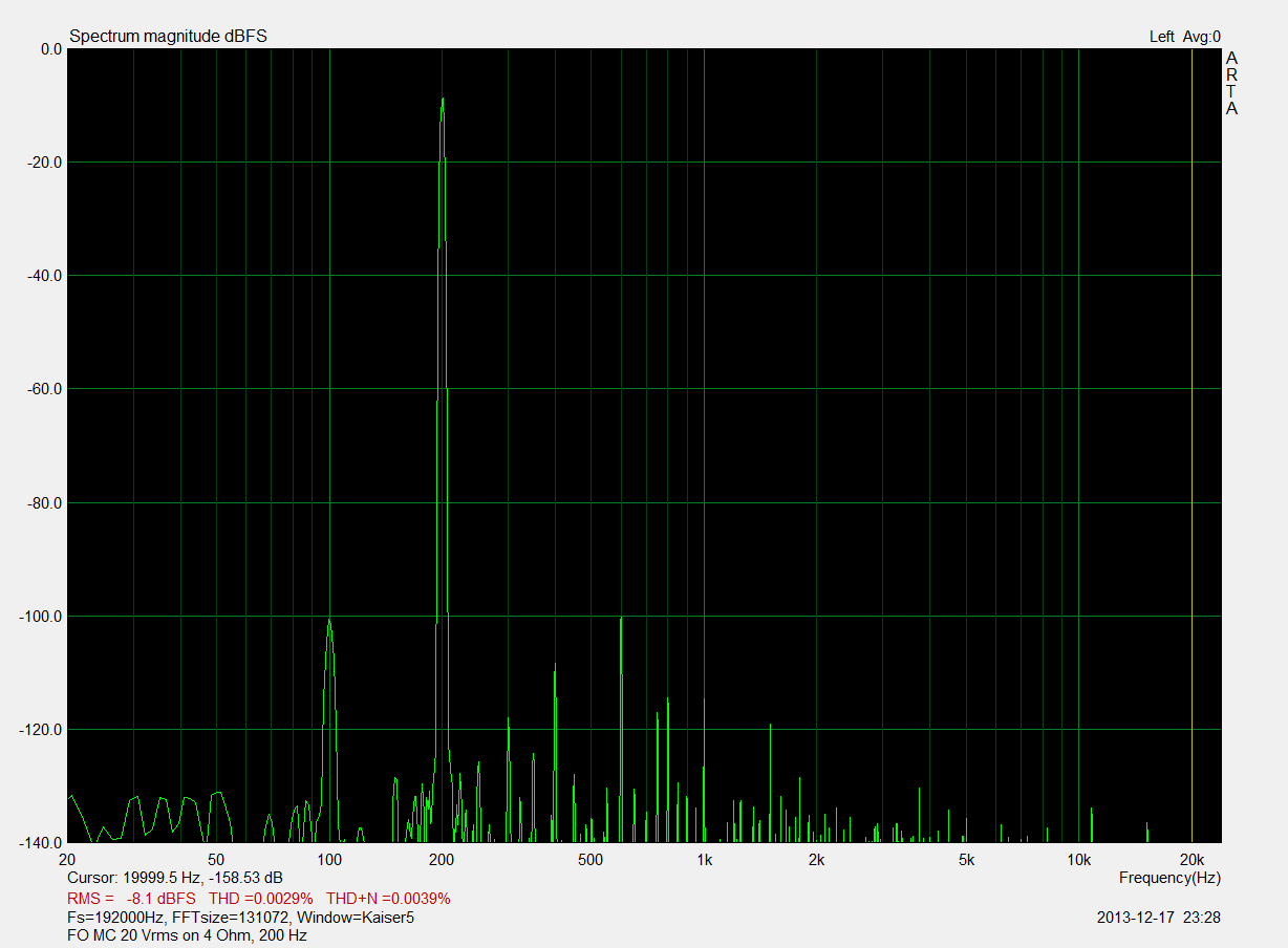

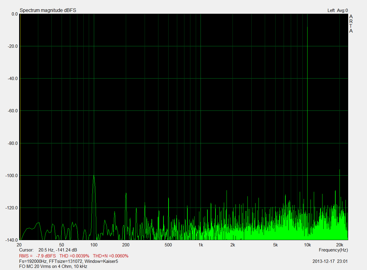

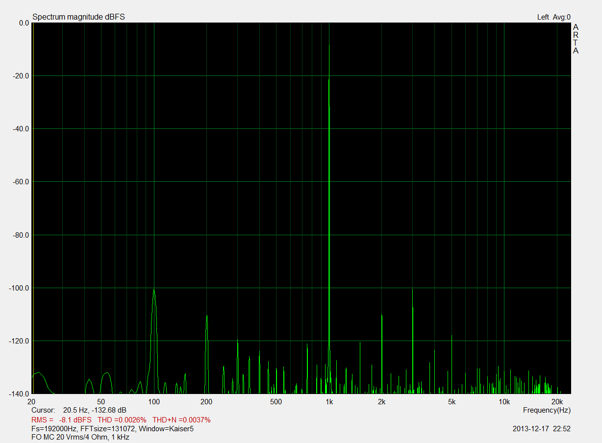

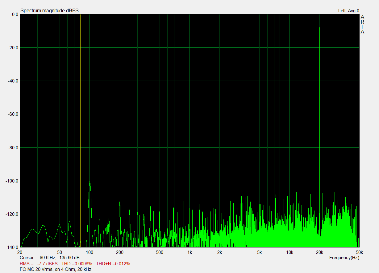

So, now few serious spectrum comparison measurements on First One with only 10 pF standard Miller compensation.
One graph shows 20 Vrms no load connected, next graph shows the same output 20 Vrms on 4 Ohm load, meaning 100 Wrms/4 Ohm. Diferences between the two are very small but hopefully enough to compare them with other type of compensations coming in next days.

First One HF compensation

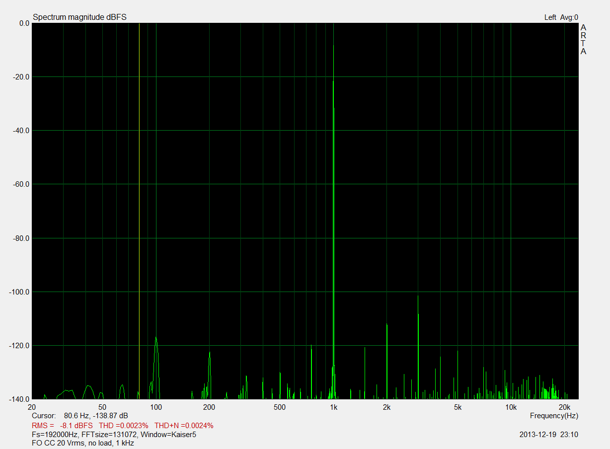

Today's work, transformed HF compensation to true Cherry, so compensating caps connected directly from the output to VAS bases. The results are shown bellow.
First graph is spectrum of the input 0,82 Vrms sine signal fed to the First One module.
Second graph is spectrum of the output 20 Vrms sine signal, no load, Miller HF compensation.
Third graph is spectrum of the output 20 Vrms sine signal, no load, Cherry HF compensation.
Résumé of all measurements is that there's practically no difference whatsoever between the two. In spite of so close performance I noticed a little better HF stability by the Miller compensation, so Miller stays in.

HD at 20KHz signal not better with Cherry ?Résumé of all measurements is that there's practically no difference whatsoever between the two. In spite of so close performance I noticed a little better HF stability by the Miller compensation, so Miller stays in.![]()
First One Miller HF compensation, spectrum of 100 W/4 Ohm, 20 kHz.
Second harmonic (40 kHz) 80 dB below the signal (20 kHz).

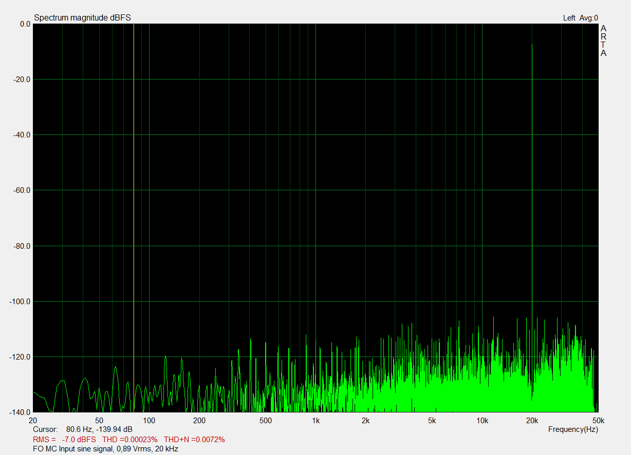

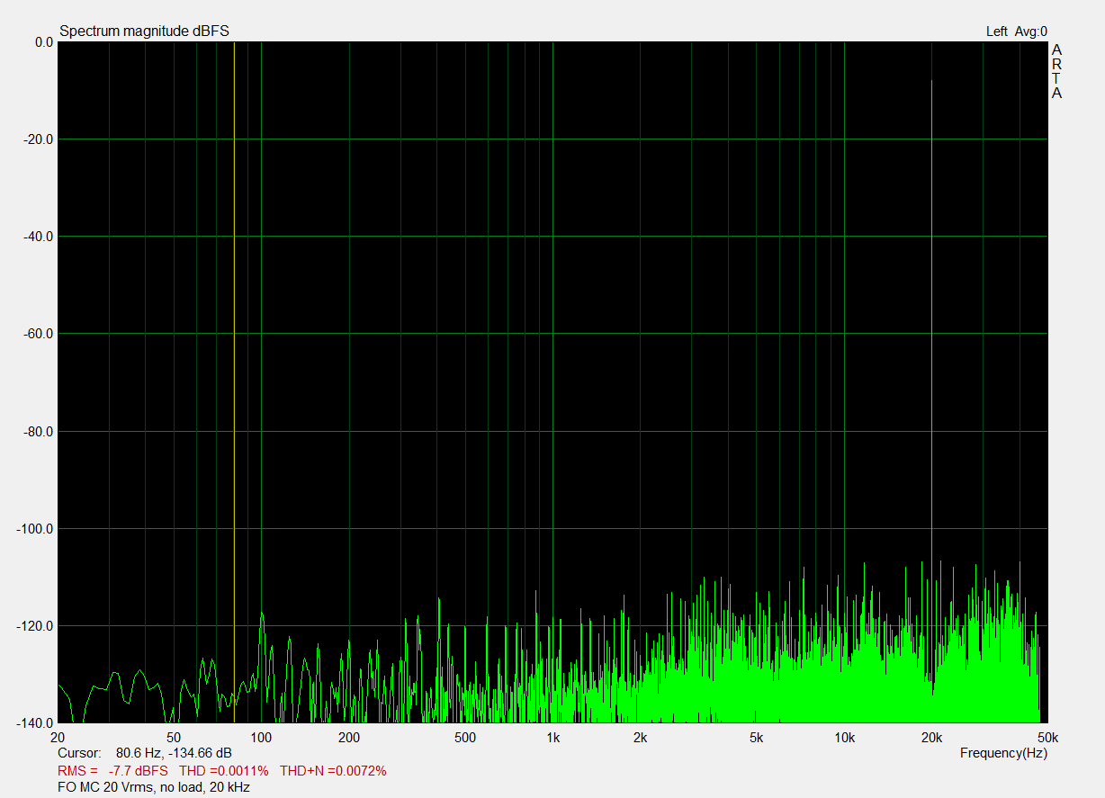

1. Input signal 890 mVrms, 20 kHz
2. Output signal 20 Vrms, 20 kHz
3. Output signal 20 Vrms/4 Ohm, 20 kHz
PSRR is -92 dB at 100 W/4 Ohm, very good for CFA.
Damping is also very high since there's absolutely no difference in output voltage (-7,7 dB rms on both 2nd and 3rd graph) when 4 Ohm load is connected.
So 96 ppm THD20 at 100 W/4 Ohm, pleased with the results, since these are real world measurements, not simm.
