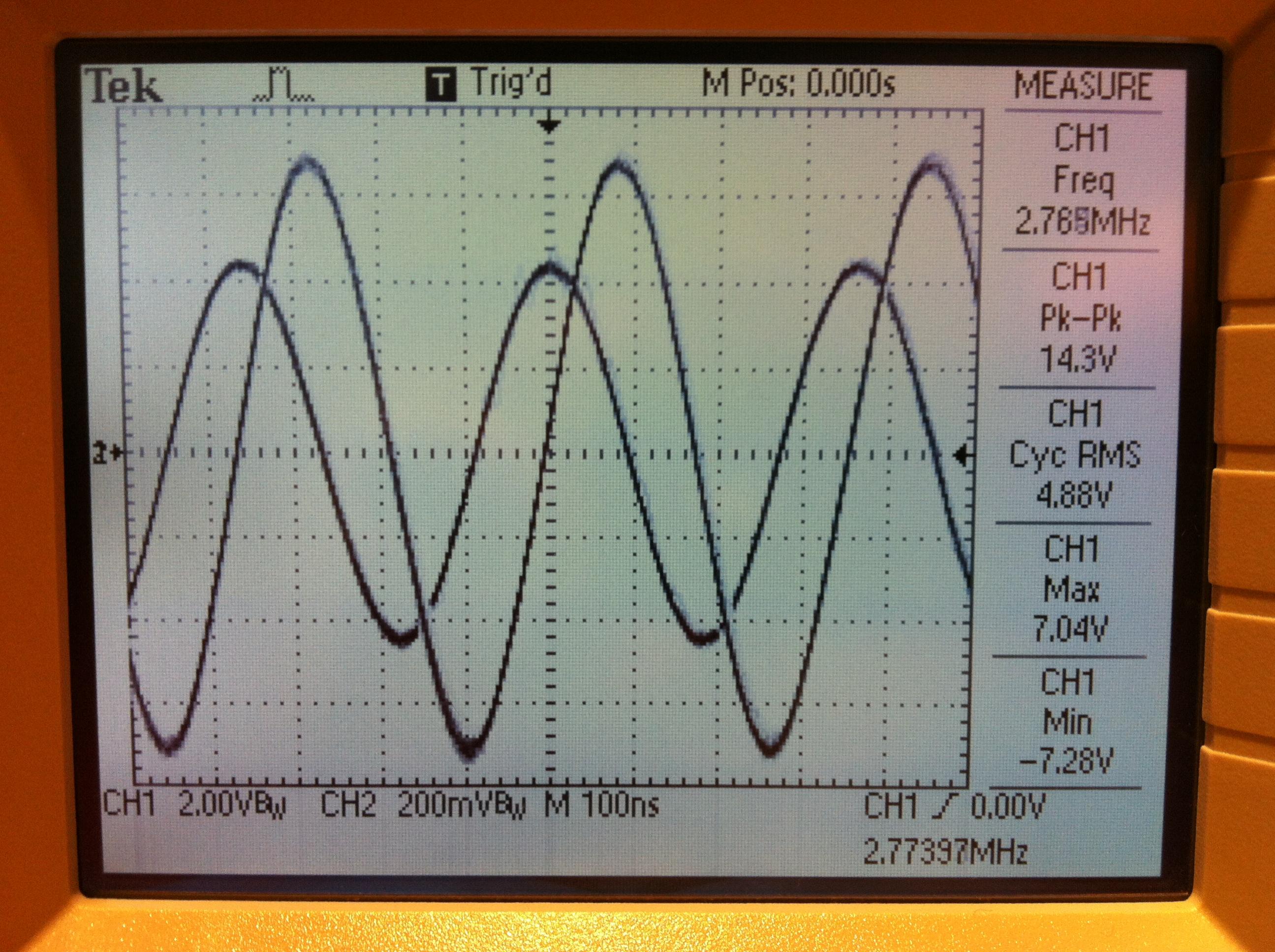

Today's measurement showing the First One's behaviour at 2,77 MHz sine signal.
We can see 0,9 Vpp input sine signal present on CH2 and 14,3 Vpp output signal on CH1
Calculations from the plot:
1. Voltage gain is x15,89 or +24 dB at 2,77 MHz
2. Linear voltage gain of the First One is +27 dB, meaning that 2,77 MHz is exactly -3 dB gain point
3. Phase shift at 2,77 MHz is 76°
4. 10 Ohm zobel load (Zr+Zc) dissipates 2,4 Wrms at 2,77 MHz

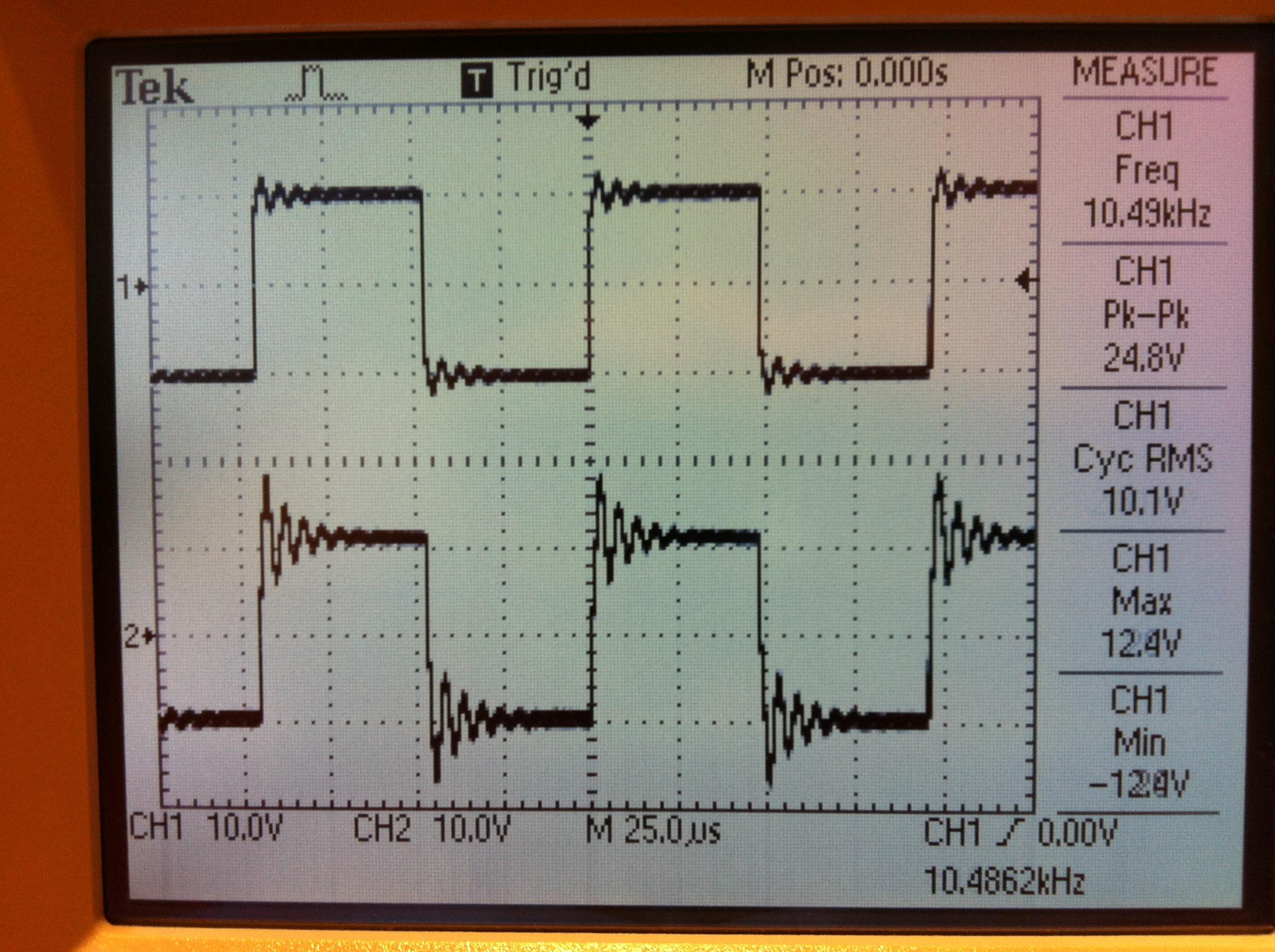

Over the weekend my task was to find proper output inductor and test the amp to all possible values of capacitance as a load, to be sure there are no chances for the amp to oscillate, no matter what kind of speaker cable is connected to its output terminals.
Lowest possible output serial inductance to fulfill upper demands is 0,2 uH, very practical small size still to be located on PCB.
Few pictures attached as follows:
1. Plot of 10 kHz/20 Vpp square waves on 6 Ohm +1 uF load. Upper trace amp's output in front of inductor, lower trace behind the 0,2 uH inductor.

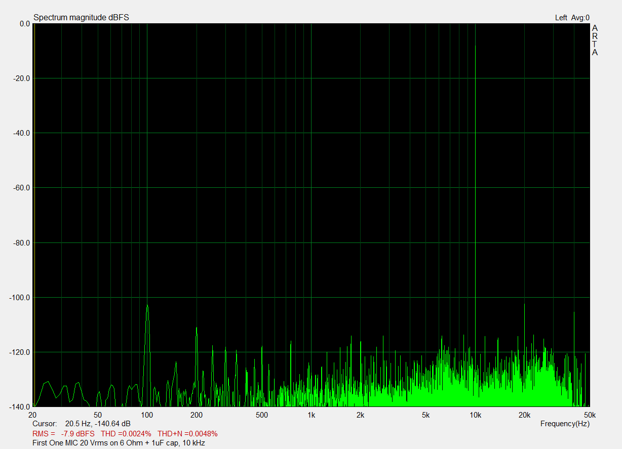

3. 24 ppm THD10k spectrum 20 Vrms on 6 Ohm + 1 uF (90 Wrms/4,3 Ohm impedance). We can see that 1 uF loading capacitor completely filtered out third harmonic and elevated the second for 5 dB. The whole THD droped for 8 ppm but since third harmonic is also present in the input signal, this THD reduction is actually bad, not preserving the input signal integrity.

Yes very nice, I am glad that all necessary measurements needed are finished. Before producing this module in great quantities all parameters and loading conditions need to be tested, no delayed unexpected surprises possible.
According to all what I experienced with this module I can only say it is very robust, been over three exhibitions driven to its max and tortured with all kind of possible signals and provoked oscillations in my lab. First One amp module survived everything with the first pair of mosfets installed to a new PCB. Also the layout of this new PCB is just perfect which is clearly shown in amp's very predictable behaviour and low overall THD.
So now it is the time to open the First One thread, which I'll do tomorrow since today has been long day.
Regards to all, Lazy Cat
Congratulations😎
......and thanks LC.😉
Thanks, I had to test it extensively, no surprises for the builders, what you see is what you get.
