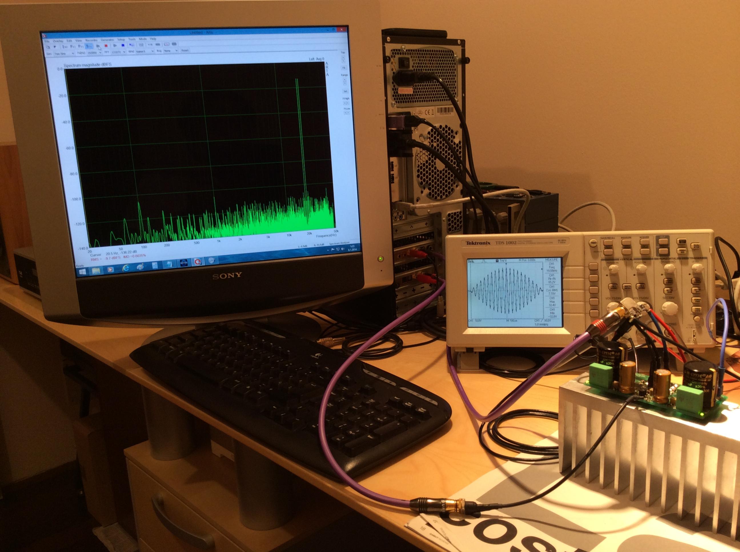

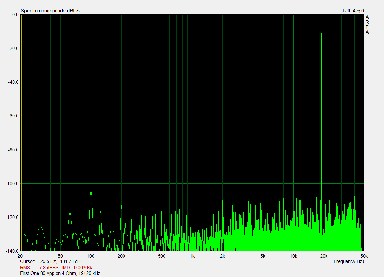

In the mean time here's 19+20 kHz intermodulation distortion measurement :magnify:
1. 30 ppm THD19+20k 80 Vpp on 4 Ohm load
2. Setup

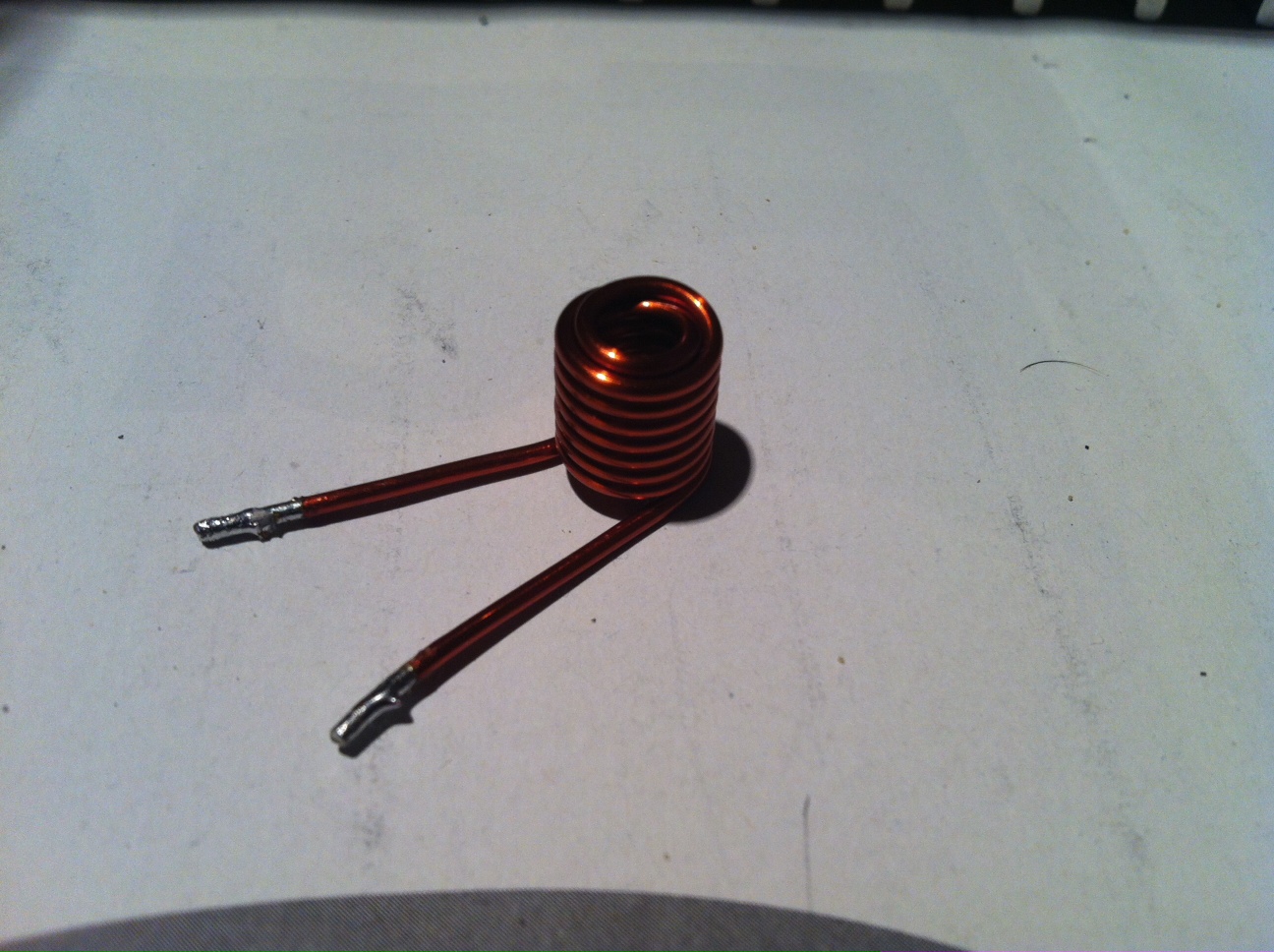

Replace burnt zobel resistors before proceeding. It looks you've got an oscillation on previously good channel. Since you don't have a scope to see what's the problem, I suggest you to use one of these (pic) on the output. It looks like yours speaker cables having highly capacitive character, causing problems. Or maybe you feed unintentionally some RF into input because of bad GND connection, etc.
Of course it can be done hehe, just get them out and solder new ones, they're big enough so there should be no problem. 😉
Output inductor from the pic has around 1 uH inductance and will prevent the VSSA to oscillate because of highly capacitive speaker cable you have. No worries since VSSA originally doesn't have inductor on the output, now the problem is solved.
Inductor from the pic can be made in no time from 1,5 mm Cu enameled wire, procedure how to make it is described in VSSA installation manual. 😉

Do you use output inductor from the pic now?
Ah, I should have seen that🙂
I can not get two soldering irons in this small gap so will add a normal 0.6W resistor to the bottom side of the board.
I will not connect it to my amp again until I have output inductors. I actually have some from an old amp lying around, I expect the value of this inductor is not so critical.

No no no Esperado you know me very well. All this fuzz about the measurements was not for me, once I heard the VSSA I knew it is very good in all respects, that its parts/values were chosen optimally and that is clearly audible. The measurements are here to prove me that also raw technical specifications of the First One fits into frame of simm sceptics who's relying on specs only. Not only that, it proved also that is well over their simm results being in the top league.
One thing really learned during performing all these tests is ability of the amp to preserve input signal integrity, its harmonic structure with all artefacts present, in the output signal. And that is what can be easily seen in those plots and why the measurements are good and tells you more about correlation between measurements and expected sound quality.
