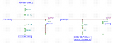

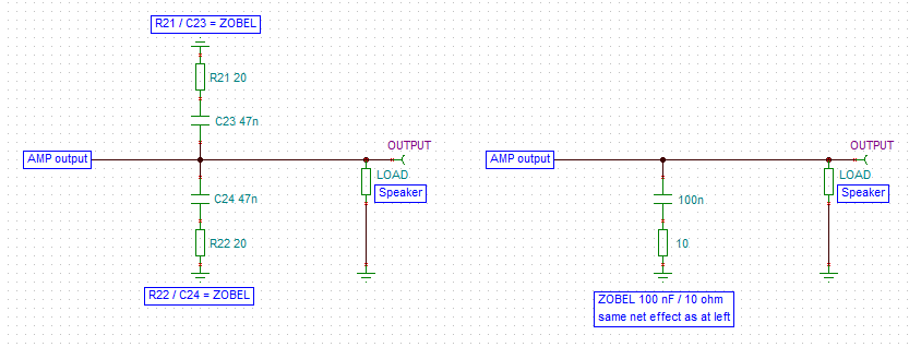

When you mention zobel i think you mean the inductor/resistor (RL output) at output to protect amp from capasive speaker/cable load. Zobel filter is build on PCB and consist of two caps and two resistors, these resitors is R21/22 (see first picture). If you can use those from parts bin inductors and 10 ohm resistors i don't no (see second picture for procedure).

based on you findings around the First One, would you recomend a new configuration for the output of the VSSA 1.4 regarding Zobel and Inductance with or without resistor in paralell ?
No, no new recommendations whatsoever. In VSSA installation manual everything is explained, also parallel RL output filter and when to use it. :yes:
In First One amp L has just a little bit lower value according to measuring results and will be pre-installled on PCB. 🙂
