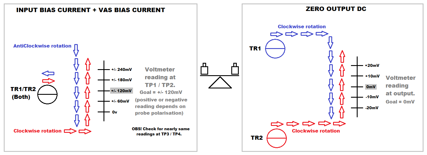

I m turning in circle with the TR1 & TR2 of the VSSA adjustment;
when I organize to have 120mv on TP1 then I have 200+ mv on the speaker out.
then playing with TR1 (or TR2) to brings that down to 0, then the VAS bias falls and I read 50mv instead of 120mv...
FYI, I have set TR3 so that the overall curent is arounf 180 ma roughly, but still, playing yoyo !!!

oops, ok now I have the bias and the offset 🙂
in fact just need to be relax and play a bit with each pot 🙂
dont drink too much cofee before suc exercise
what I did : put TR1 to the max I could.
then reduce TR2 so that the value is on V1 is 150mv
then reduce TR1 to 135mv
then adjust TR2 for the offset to 0
then by magic the V1 was showing 125mv
breath , wait, and double check

maxidcx, nearly same as "steering the car, wife telling something, phone beeps, police at behind", difficult.
Balance, see picture 🙂

maxidc, try to preadjust the potmeters so that you read ~200R on both R9 and R10. After that power up the module and adjust slowly and in small steps, just as BYRTT has pictured up.
In my XVSSA case it helped me a lot soldering 470R on top of both R9 and R10, so the adjustment range was reduced to more useful values..
Good luck and try to get most of patience before this step 😉

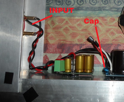

Hi. I got problem with VSSA amp. Amp have little seasound in otput. Caps in powersupply are normal, intput cable is enought good, biasing is also in place (maybe +-4mV is variaton). In PSU i have 300VA toroidal transformer, and 12x 10000uF caps, but if there is something wrong, I must hear in output 50/100Hz?

Hi. VSSA - album Fotoalbumis - Fotoalbum . These pictures are 5 days old, and i have change some wire plases, but 95% it is like at pictures.
There should be central GND point to equalize GND potentials (currents) between left and right channels, otherwise this eq current will flow between input grounds causing interferences clearly heard in the speakers.
Hi Elektrohoolik and LC.
Attach picture where input cable seems to be braided with speaker cable, is that okay.
Also possibility that the blue bypass cap makes resonance, this said because after first entry for PSU spades at VSSA module there's 1mF electrolytic also bypassed, here by 1uF.
Intput cable I already put other way (not twisted with output cables) to input. Plastic washer must also be between PCB ann screw (exepted output mosfet)? But i can't hear in output 50/100Hz sound (Ok maybe littlebit). Hmmmm. Blue caps, i gonna remove tomorrow , lets see what then happens, russian caps are sometimes like cristhmas present, you dont know what is inside... And if still noise is in output, i put output GND wire to GND connector at PCB. But interesting is that it it like digital noise, or like sea, not 50/100Hz.

Elektrohoolik yes it's funny the noice is seasound. Bypassing can make resonance with certain unlucky values, maybe that little blue one do that, it's cheap trying desolder one end. I can't see the input pair (BC550C/BC560C) in your pictures, you haven't put any metal art around their case to couple them thermal, then take that off and use non metal or glue them together.
