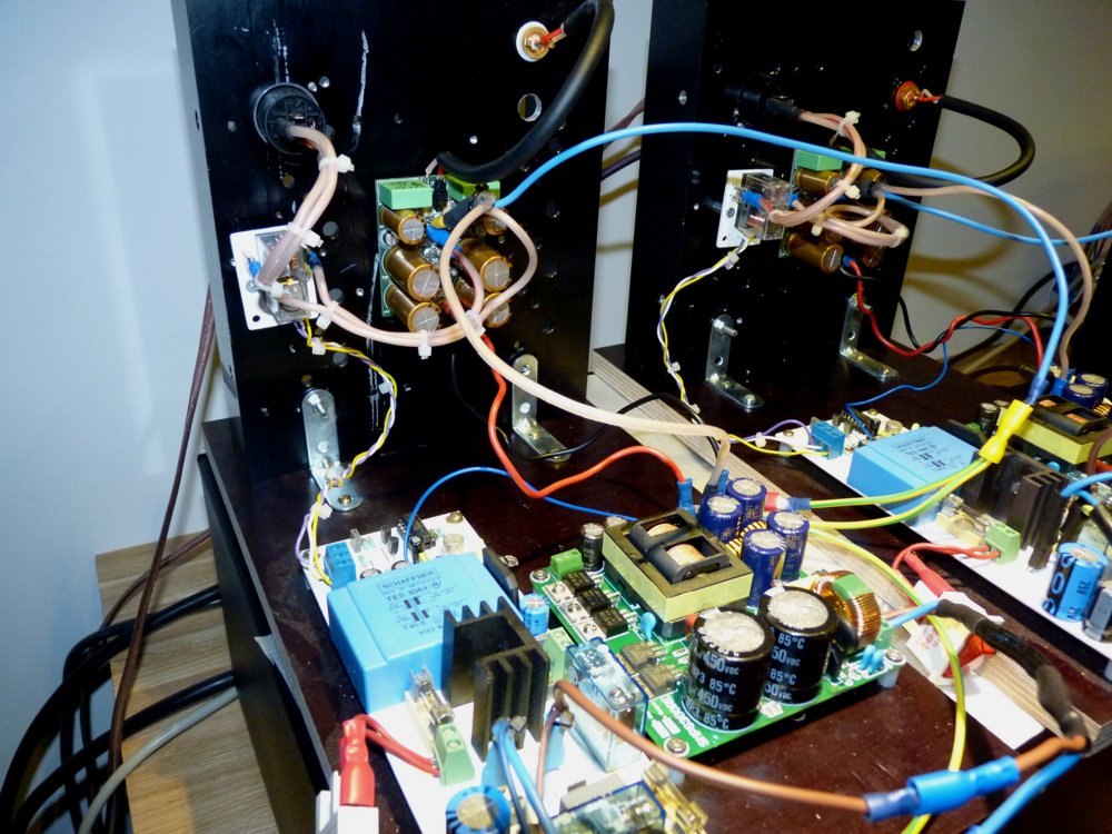

Hi. You can find picture here VSSA - elektro1 - Fotoalbum . It is best quality, what i got, but when the amp get warm, i didn't hear this noise...
Hi. I wrong, I still can hear noise, when amp get warm, but i don't hear, when i put 47nF cap in intput... BC560 and BC550 i glued together with super glue. So there is hopefully good thermal transmission.
Elektrohoolik, your wiring is not OK!
L and R channel have to be connected with GND wire to chassis. This wire goes from each VSSA channel PCB GND faston connector to mid point of the chassis, otherwise you have GND loop, causing interference currents.
Also try 0,5 uH inductor with 4,7 Ohm/3 W resistor, both parallel and in series with output wire located at + output terminal. This LR output filter prevents amp to oscillate because of too capacitive cables.
Look to recommended wiring diagram drawn in VSSA Installation manual and try to realize it in your case.
