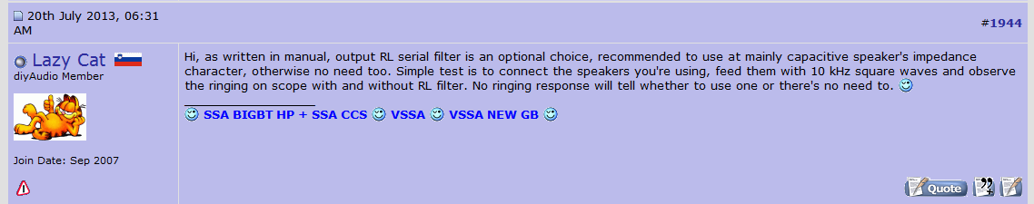

Sorry for the intrusion. I recently got a couple of LC VSSA. I run them with 36+36 volts. The ps are for use in CNC and I got two of 350watt each but I connected for two rails.
The questions are: Need a Zobel? Which value? Does need a coil in the output? The sound is a little ringer with my lowther of 15ohm. I want to connect in balanced input. Can I?

You don't need a Zobel filter at amp end of speaker cable, it's build in at PCB in form of R21/R22/C23/C24. You free to put Zobel filter other end of speaker cable (speaker terminals) to linearize the driver impedance but it's another story.
Does need a coil in the output? Don't think so, only if using exotic speaker cable. See page 4 manual and attached picture.

Hi. I removed all liitle blue caps, put OUTPUT GND wire to amp GND tab, made one grounding point, put very short wire from output to speaker.But it is still quite noisy. Maybe it is littlebit quieter. Also i haven't got scope (yet), but i think i gonna buy it in this week. Also I tried to put little coil (18 turn on 6mm drill bit in two layers) in to output, but it didn't change nothing.

Recommend oscilloscope and LC guide, but if not available now and you have time and patience here suggestions to try:
Concentrate on only one module getting up running perfect, and thereafter the other based on knowledge from first if succeeded.
Dismantle the module, inspect visual for errors and especial see if INPUT pair and VAS pair should by accident be turned around.
Pre calibrate TR1/TR2/TR3 by this guide http://www.diyaudio.com/forums/vend...lateral-mosfet-amplifier-157.html#post3532755.
Short input by soldering little wire, and don't take this off before amp first is calibrated and later running with speaker connected and no noice at all in speaker.
Many had little smoke from R21/R22 belonging to Zobel filter and then resistence go off spec so with DMM in ohm mode measure them they should be 20ohm.
Mount PCB again and if possible isolate screws for two VAS devices with isolated washers of some kind. But do only this if shure heatsink always have ground potential through box or wire.
Now calibrate as in manual + the amend for calibration that can be found here http://www.diyaudio.com/forums/vend...lateral-mosfet-amplifier-254.html#post3653117.
If now still sea sound noice try desolder C4/C5, those oversize green 10uF MKT's you used, amp can run without. If no good try another simple PSU for trials.
