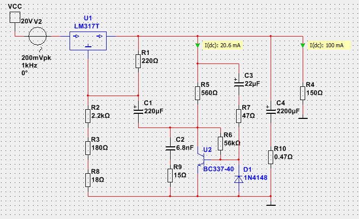

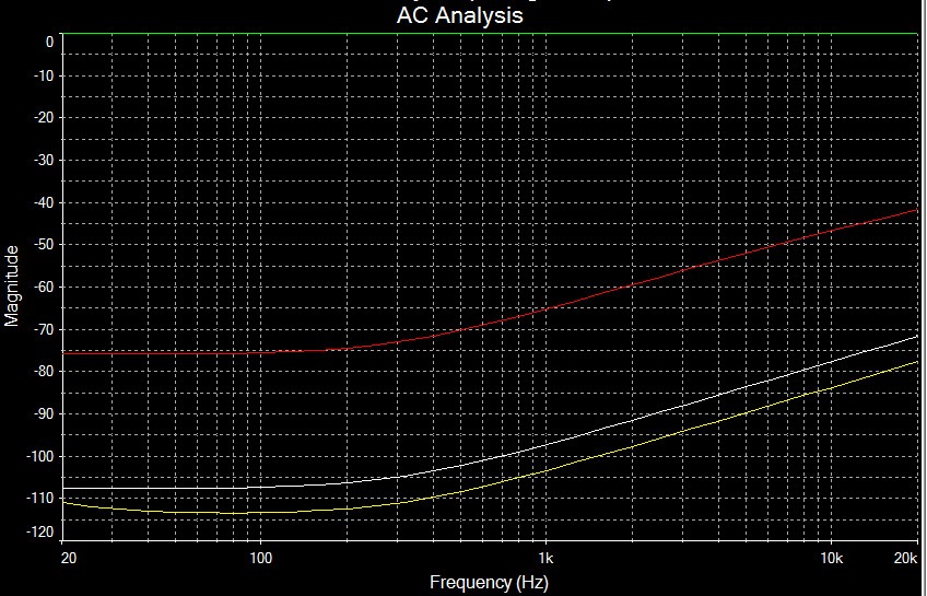

@Elvee has shown how it is possible to tweak D-Noizator further.
In this POST
I have done some test on that concept. Using submitted schematic.
By changing 2 resistors, 560ohm and 56kOhm.
The tradeoff is increased current from 6mA to 20mA.
On this graph
Red = De-Noiser disabled
White = VRDN Original
Yellow = VRDN Tweaked for ~6dB improvment
In this POST
On this graph
In order to fully benefit from the mod, it would also be necessary to reduce the 47 ohm protection resistor to minimize its noise.
The compensation components should probably be adapted too
