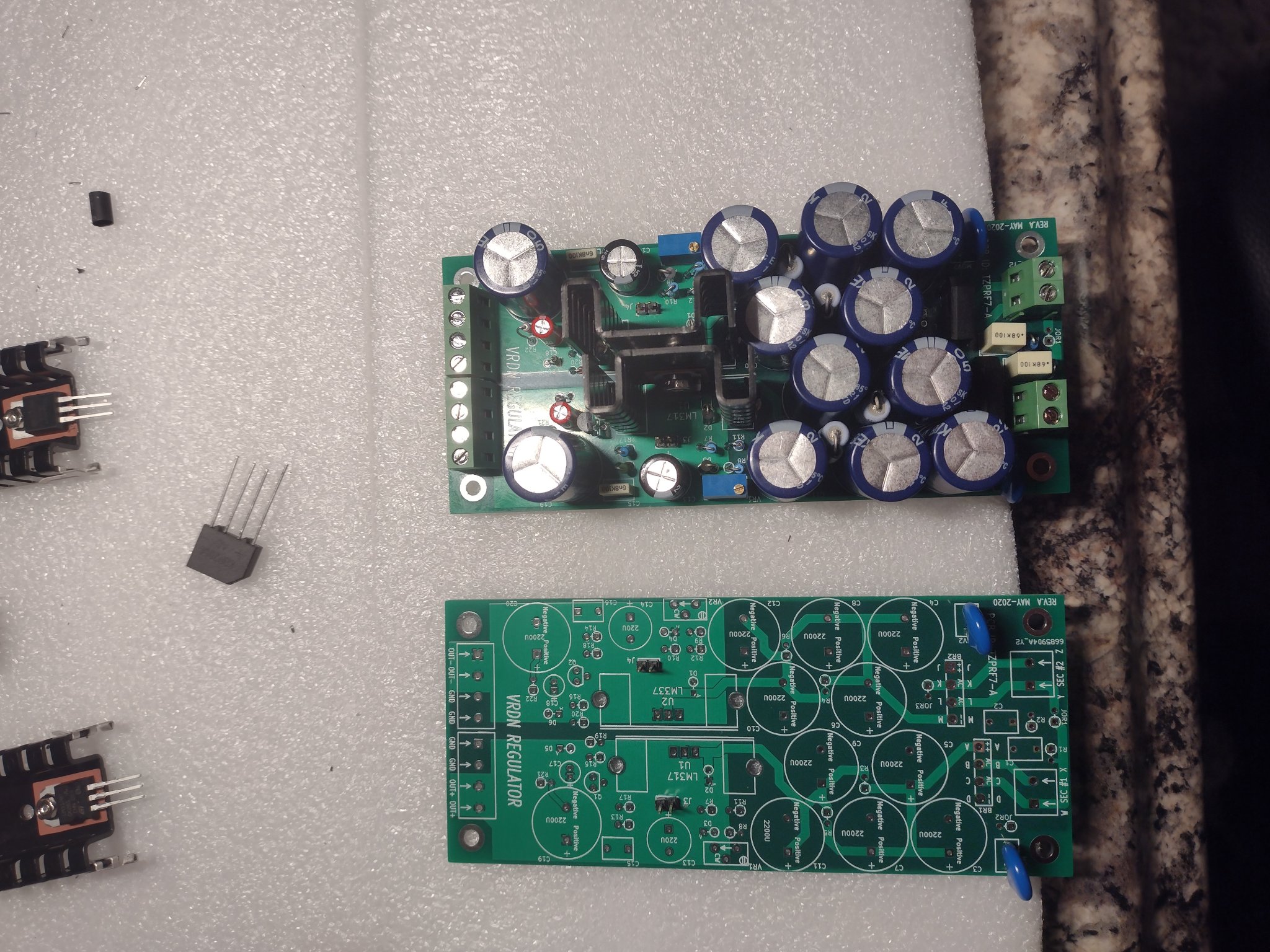

V+ I can lock into my desired voltage but the V- dances around and ranges between about 30mv.
is this more of a concern than Namgihinook’s experience?
Update on some things I tried this morning.
Still no luck getting the V- to stabilize. However, after adding the jumpers to bypass the denoiser, the V- stabilized... Hopefully that helps trying to troubleshoot my issue.
- Re soldered all joints on the V- side of the board
- cleaned all the flux off the whole board
- checked orientation of my diodes

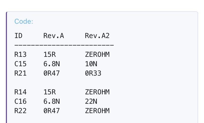

- I am using TI regulators, so made sure I had the correct resistor and cap changes
This means that the regulator/denoiser combo oscillates.However, after adding the jumpers to bypass the denoiser, the V- stabilized.
Check the output bypass capacitor, its esr (not too large or too small), and tweak the values of the compensation network: capacitor and resistor if it is non-zero
I pulled a 22N Wima off another project and that worked. The V- is solid.
