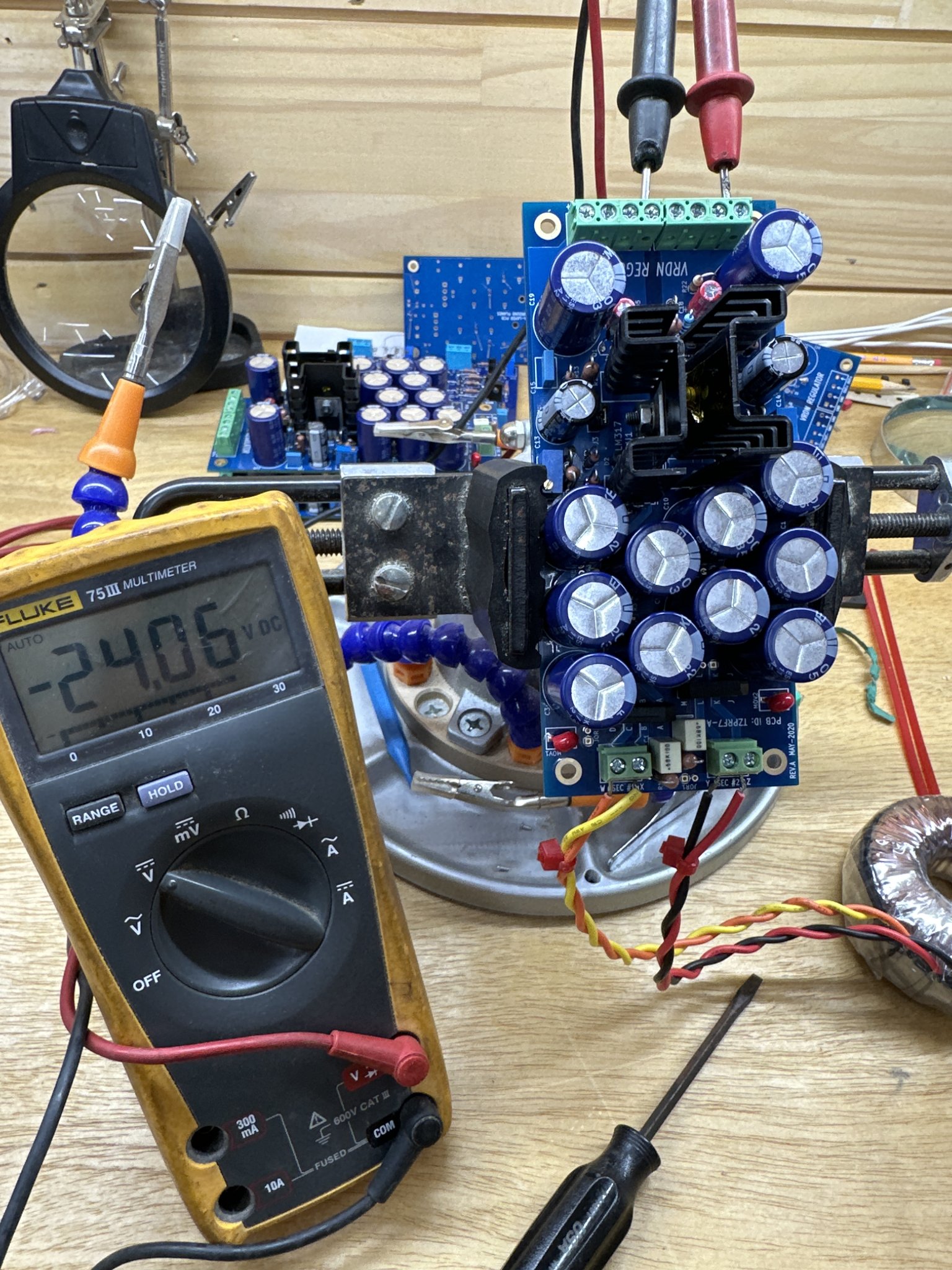

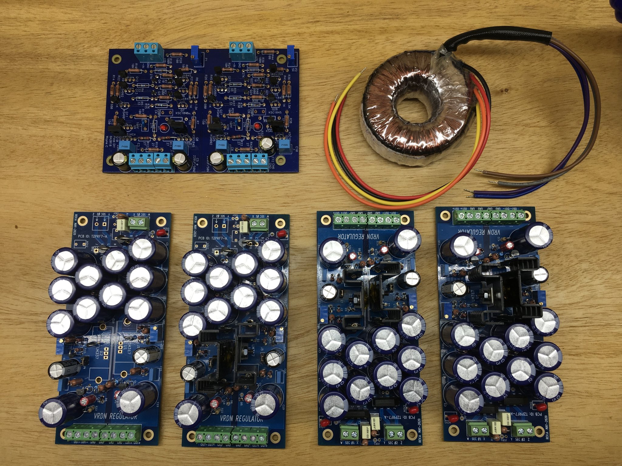

A bit of help please on one of my VRDN regulators, the negative voltage rail is not adjustable. It’s giving me -23 VDC. Do you think the trim pot has shorted out? or the LM337 is faulty in someway. This beyond the scope of my paint by colors and not sure even how to check either one or test them. I have the parts to throw at it and see if it fixes it. But would rather learn something! If someone has the patience for that task. 😄

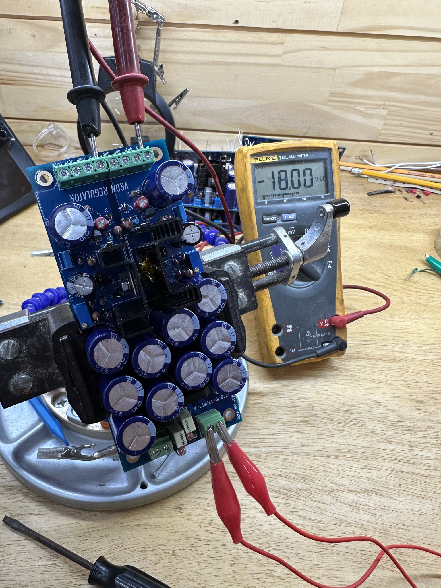

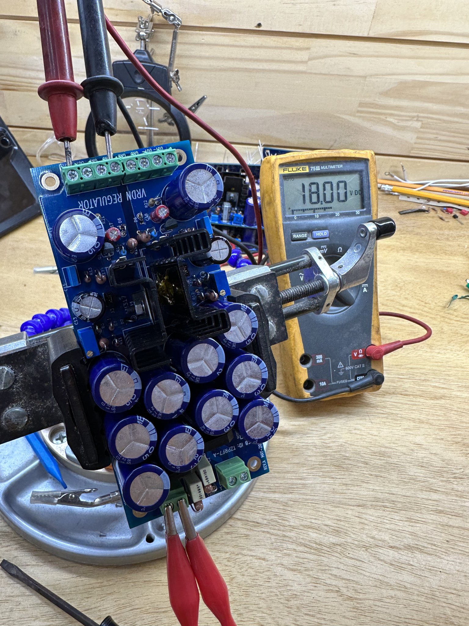

Yes, the first one both left and right sides positive or negative fully adjustable to +18-18 Vdc.
The second one just the positive side is adjustable to +18 V and the negative side is nonadjustable at all. Just sits at -23 Vdc. And no heat or magic white smoke 💨
Well I can’t find the problem. I changed the rectifier and the trim pot and resoldered about eight connections.
OK I decided to go ahead and to replace the LM337. Well that was hard to get out. Put the new one in still have the same problem. This is well above my pay grade. Any ideas?
This is the usual way forward - to expand: print out the schematic, probe every voltage of the non-working board and annotate on the schematic, post here! Then we have something concrete to work fromCompare circuit voltages from the working board to the faulty board

Just sits at -23V.The second one just the positive side is adjustable to +18 V and the negative side is nonadjustable at all. Just sits at -23 Vdc. And no heat or magic white smoke 💨
Because it is working as if the trim pot was set at maximum, I think the trouble is there.
At the trim pot PCB tracks, a short or an open circuit.
