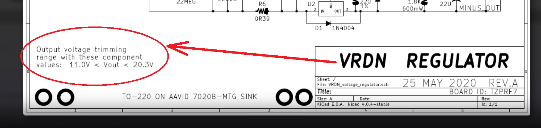

I finished building my VRDN but only have 9 and 12 volt transformers handy to try it out with. It seems to be working well but I notice that the potentiometers don't seem to have any effect on the output voltage. Could that be because I am running the power supply at a lower voltage than it was designed for?
Okay and thanks Rick, I was afraid I had screwed something up in the build. Will try to lay my hands on a higher voltage transformer. I had hoped when I built this that I could use it's adjustability to use it as a multi-purpose power supply to power devices in the 5-15 volt range with an appropriate transformer but that won't work if the adjustibility goes away at lower voltages.
Check the schematic attached to post #1 of this thread. Also check the thread title, VRDN: bipolar regulator PCB for line level ckts: ±11V to ±20V @ 1.5A with "De-Noiser"

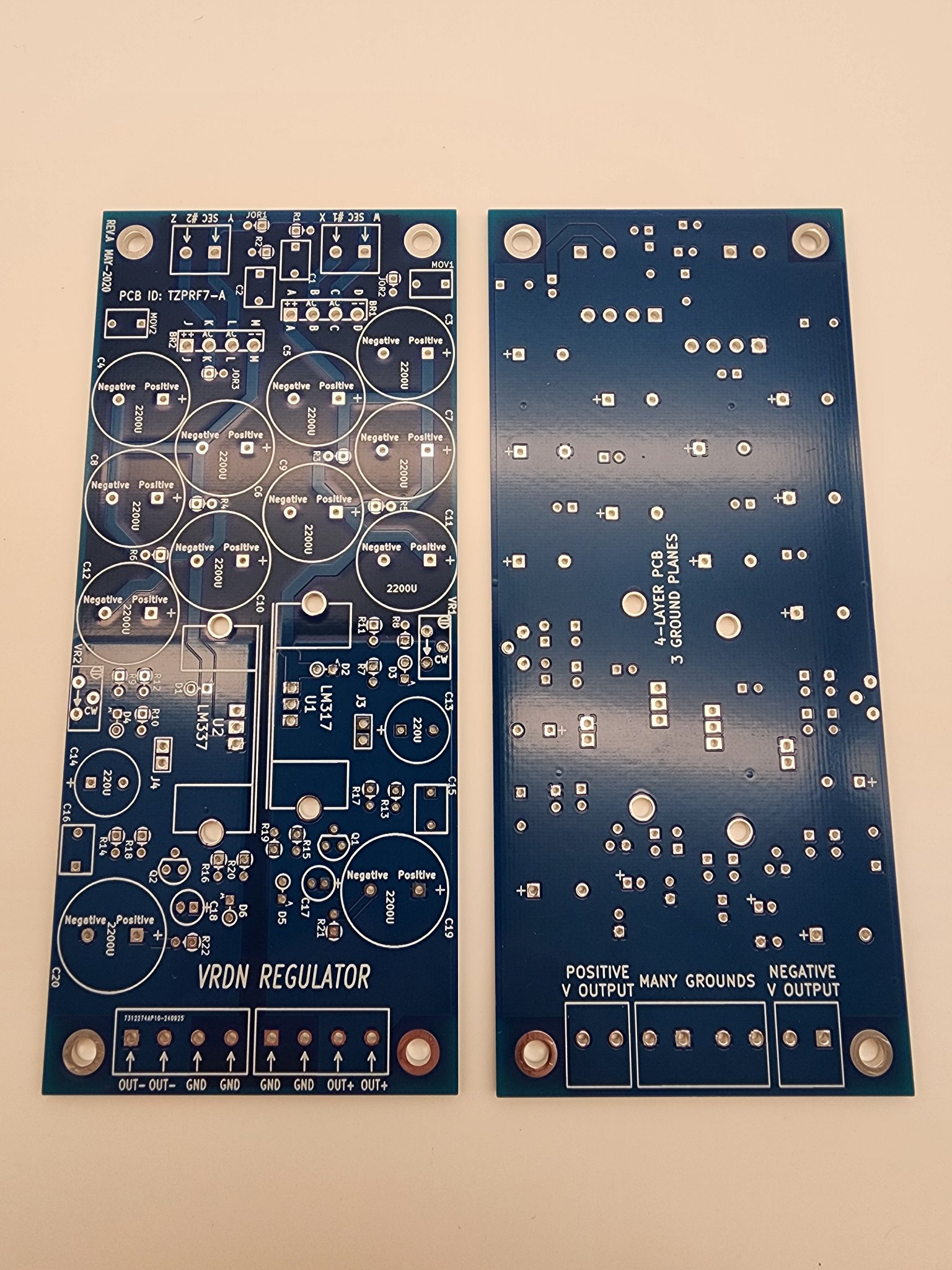

If anyone is interested, I have a bunch of VRDN boards in the swap meet for very cheap as I ordered a lot.
- Blue PCB
- HASL Finish
- 2 oz outer copper
- 1.6mm board thickness

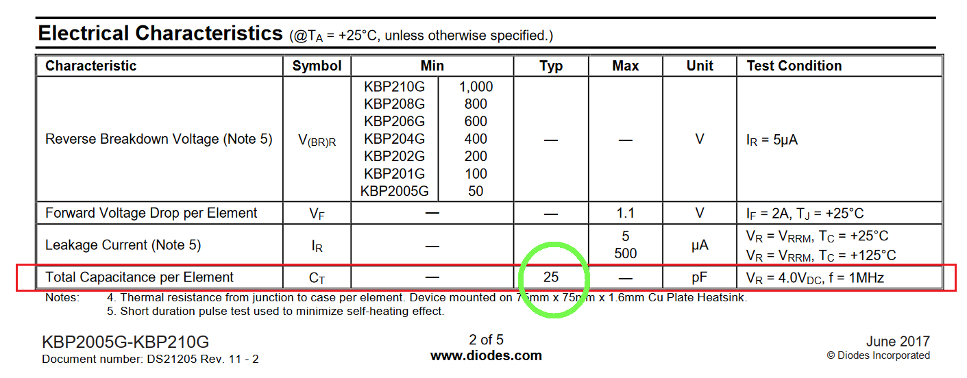

I am using three VRDNs for my BA2018. (One for each channel and one for a Muses setup.) All three will be hanging off of a single Antek AS-0518 transformer. Each VRDN contains secondary snubbers: (MOV1, C1, R1) and (MOV2, C2, R2). Built with the recommended parts, C1 is 0.68uF and R1 is 39R. C1 and R1 are the same as C2 and R2, respectively. The MOV parts are 400pF or 500pF (0.0004uF or 0.0005uF) depending on the spec sheet you find.
I started wondering about the effect three VRDNs would have since they were all going to be hanging off of one transformer, and what the total combined snubber values might be. In the "Quasimodo results (ONLY)" thread, the posted values for the AS-0518 transformer are:

The three VRDNs seem to me to be in parallel to each other in my system. If that is the case, then the snubber circuits are as well. So for one secondary from the transformer, the combined stock snubbers would give these values:
Cx = 0.00167uF
Cs = 0.227uF
Rs = 13Ω
...which to me looks haphazard. Cx is 1/10th of the size of the recommended value, Cs is too large, and Rs is 1/3 of the size of the recommended value.
To me, the simplest and most logical approach is to chant the mantra "Snub the TRANSFORMER . . . . Snub the TRANSFORMER . . . . Snub the TRANSFORMER . . . . Snub the TRANSFORMER" as the gol-durned title of the Quasimodo thread recommends
- Simple, no-math transformer snubber using Quasimodo test-jig
Looking at the datasheet for the bridge rectifier called out in the VRDN parts list, see attachment below, I note that the rectifier capacitance is 25pF x 4 diodes per bridge = 100 pF per bridge. Connecting three bridges to a single transformer secondary means the secondary sees 300pF of total diode capacitance. Fortunately, the "Starting Point" recommendation in the Quasimodo Design Note, suggests trying Cx = 10,000 pF (i.e. 10 nF ; i.e. 0.01 uF) across the secondary. The Design Note explains that Cx's purpose is to totally swamp out the rectifier capacitance, wiring capacitance, and transformer secondary self-capacitance. It replaces an unknown variable by a known constant. Since 10,000 pF is much greater than 300 pF, I would feel quite comfortable using the Starting Point value unmodified: Cx_with_3_VRDN = 10,000 pF. Or if you worry that the MOV's capacitance is much much much less than 10,000 pF: bodge-wire in a 4,700 pF capacitor in parallel with the MOV.
Then I'd just perform a plain old ordinary Quasimodo measurement on the transformer secondary, with Cx= 0.01 uF and with Cs = 0.15 uF and with Rs = 25 turn trimpot. Twirl the knob until the waveform is damped and the 2nd lumpity bumpity juuuuust disappears: done.
