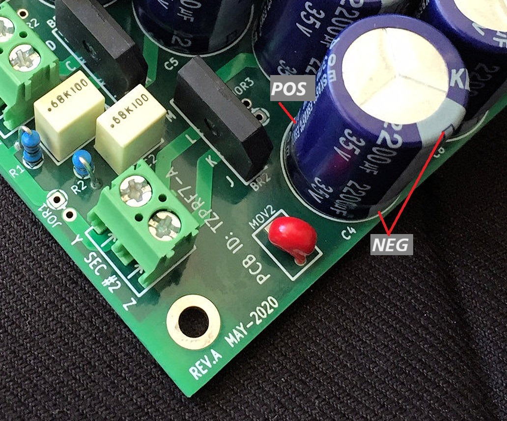

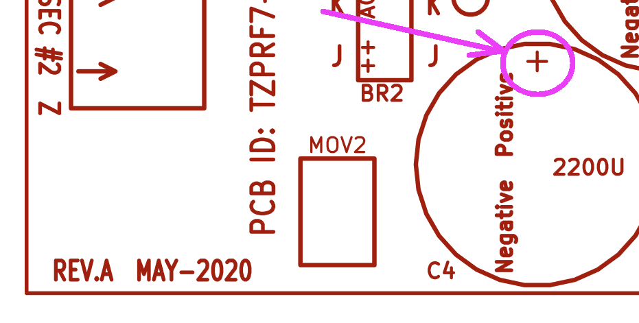

I mark the positive terminals of electrolytic capacitors with a "+" sign on the bottom silkscreen layer, just to give builders a way to double-check the polarity AFTER the board has been stuffed and soldered.
If the components are densely packed on the PCB, markings on the top side can become difficult or impossible to read. But you can still read the polarity band on the cap itself, then flip the board upside down and verify that it matches the polarity marked on the bottom side. Granted, this can be a little clumsy-- but it's a whole lot better than no possibility of double-checking at all. You get a little extra reassurance that you didn't stuff the capacitor backwards, and it doesn't impact board size or cost. Cost = zero, Benefit > zero, easy decision.
