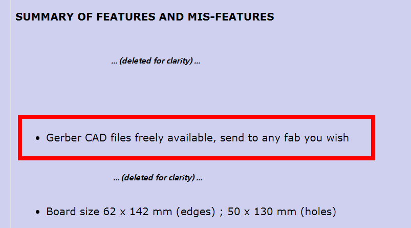

From post #1 of this thread:

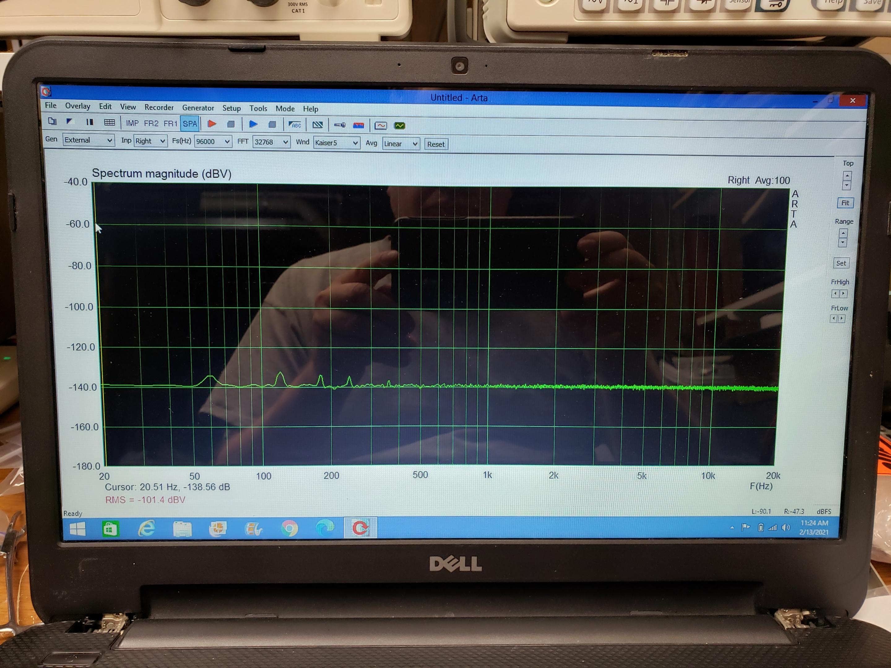

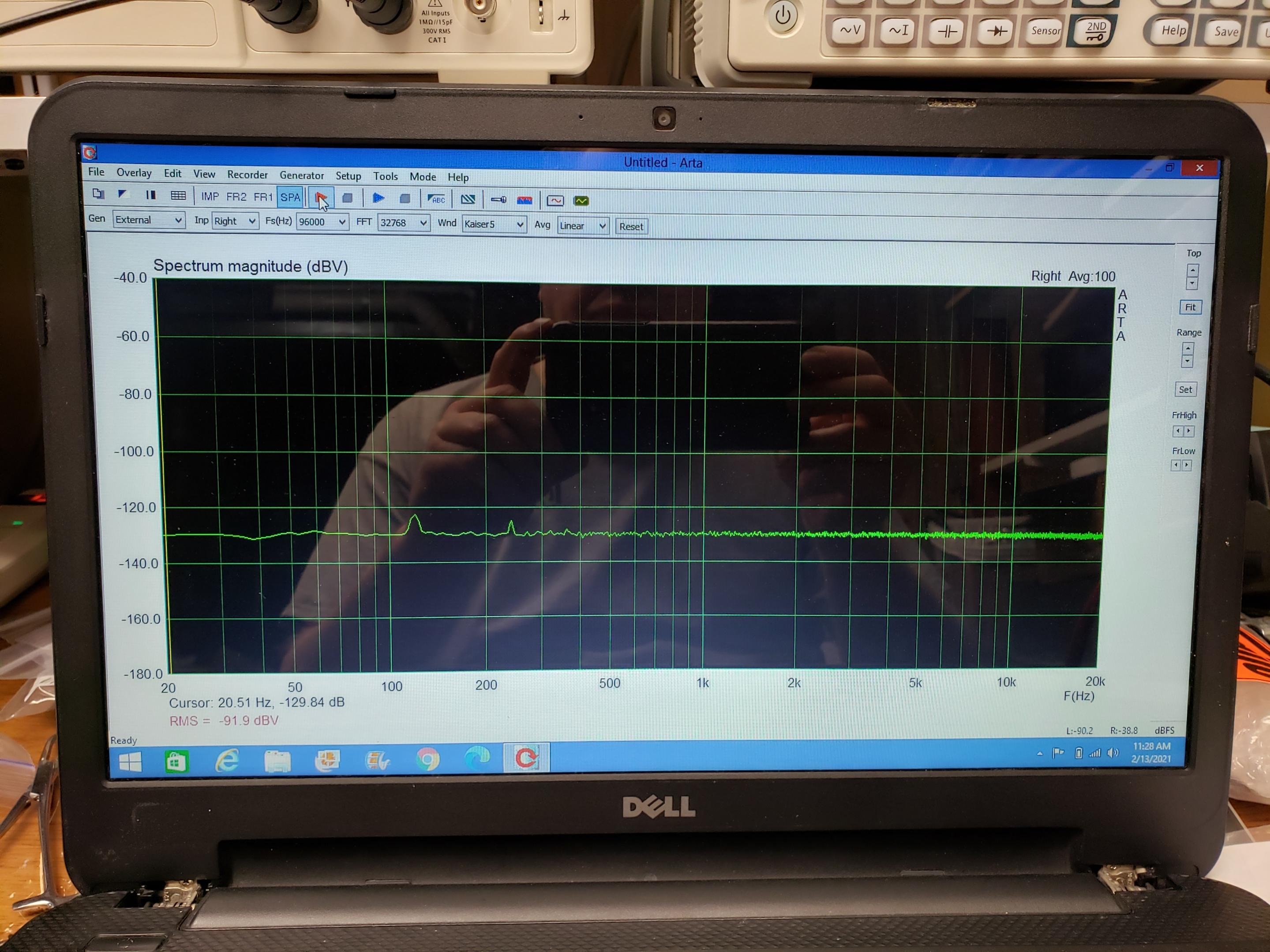

VRDN Measuements
Since no one else has posted any measurements of the VRDN, I figured I would have a go at it. I measured both rails set at 12 volts with 180 ohm resistors on the outputs for a 66mA load. I did parallel the resistors on the positive rail for a 132mA load and it raise the noise level about 2dB is all, statistically insignificant.
The 0dB level is set to 9,238.9 mVpeak or 12.5dBu.
Positive Rail
Negative Rail
