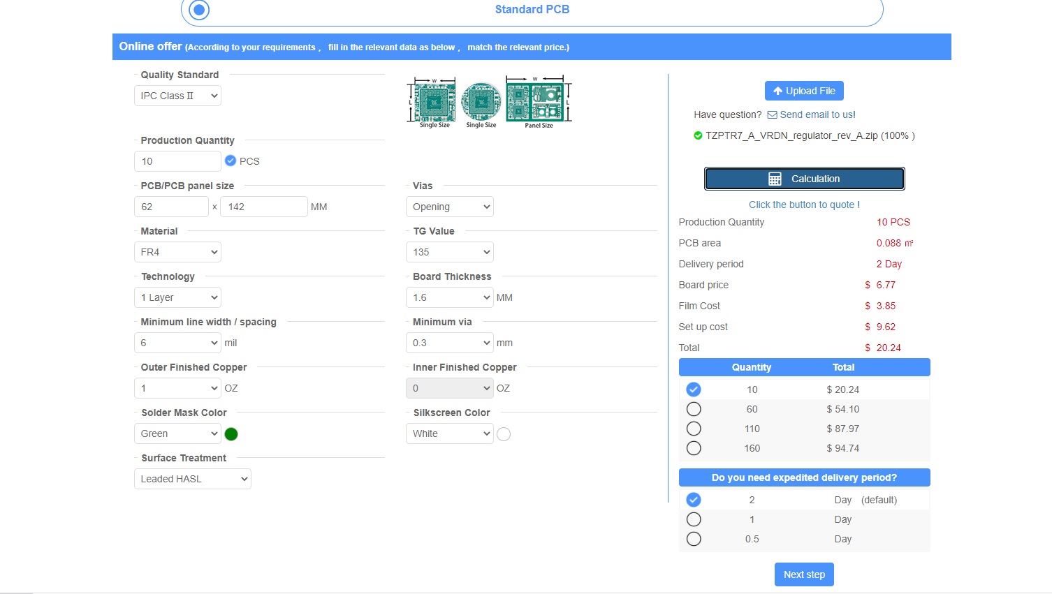

Board Order Help
Does this look correct?
Mark’s thoroughful comments/manual says:
„This is a four layer PCB, three of which are ground planes“
On your screenshot, I read „single layer“...
not sure what to think of it. When I got my PCBs made, I just pulled the zip-file and ordered it as it came out (@jlcpcb, though)

That is what I did
I upped the zip file.
But not all the options were available, different pcb maker.
I can't get in to jlcpcb, everytime I try I get captcha error, any browser, old or new account. I emailed them and I was told IT was working on it.
I just wanted to know if what I posted was correct.
jlcpcb added a $30.00 engineering fee.
So I don't know what to do.

Concerning jlcpcb, I'd advice to be patient a little bit, and just try again.
(I just did so and almost clicked the order-now- button: it is working for me...)
I‘m not sure if my observation was correct but I had the impression that prices for "gadgets" (blue instead of standard green in my case) dropped when I went back and repeated the whole order-process (inclusive file-upload) shortly after my first attempt, so it could be interesting for a fancy build (all pcbs blue/black/red etc)
If it works this time, you could do as many others and order a few more, to resell among other builders here. Thus, you split the engineering- and shipping-costs...

https://www.seeedstudio.com/fusion.html
I found Fusion PCB & PCB Assembly & Flexible PCB - Seeed Studio
Thank you.
