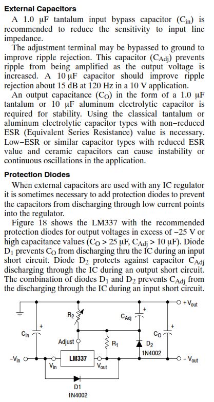

LM337
Found this in the datasheet for the LM337.

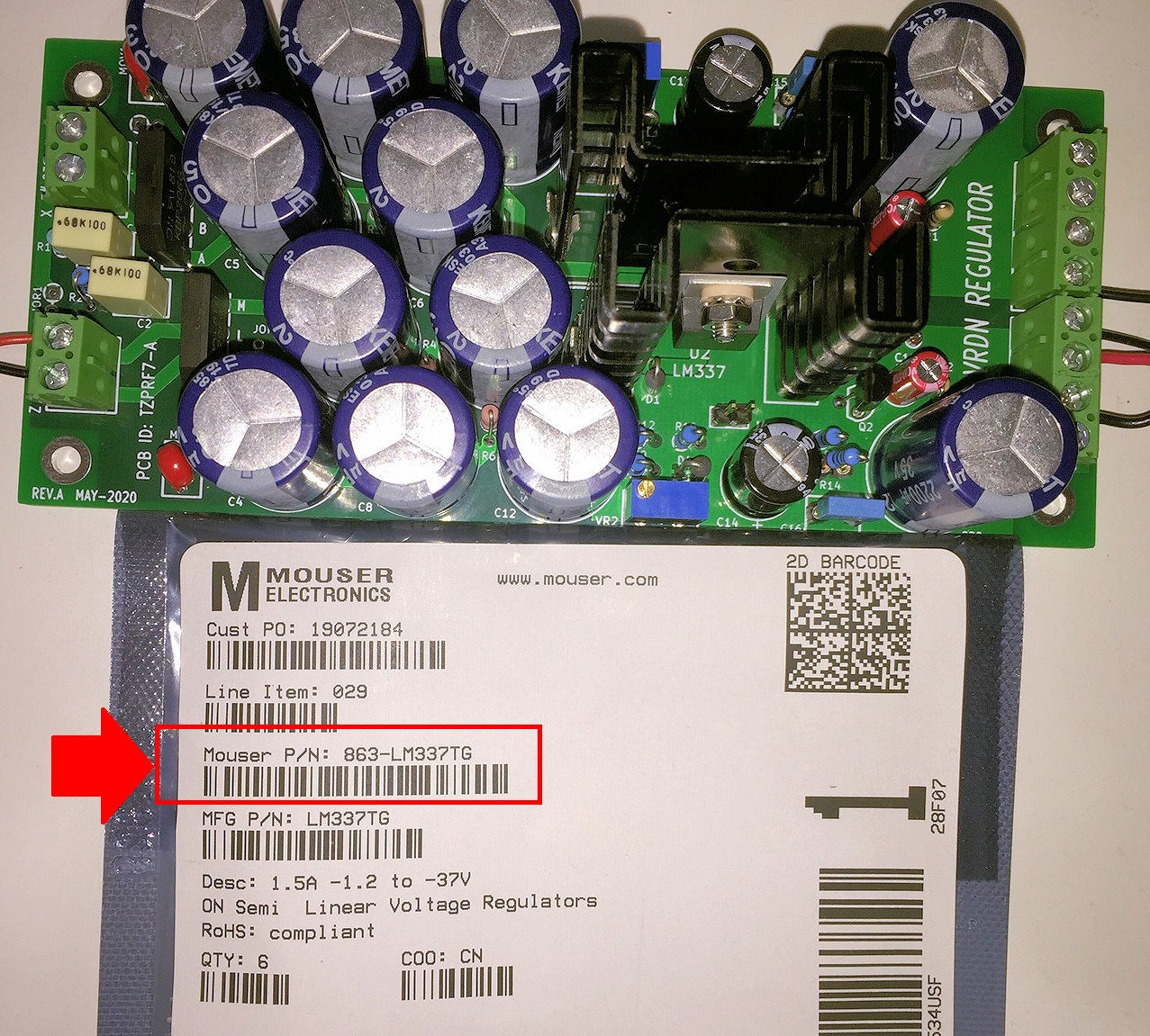

They didn't have the 863-LM337TG regulator, so I used LM337KCSE3
I am starting to think: that might be significant. All of the VRDN boards I have built and tested, used LM317s pulled from the bag shown below. None of those boards oscillated, not even with the unmodified (6.8nF SERIES 15R) compensation network. I just tested the one I still have, and it doesn't oscillate with (6.8nF SERIES 15R). Not when load current = zero , also not when load current = 50 milliamps.
Although LM337KSCE3 is out of stock at Mouser, I found some at DigiKey and ordered them immediately. I also ordered some of the KSCE3 positive regulators, at the same time. When they arrive I'll build another VRDN and see whether I can get it to oscillate.

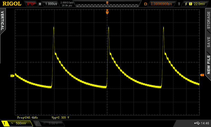

Following up on the observation made in post #188, I stuffed and soldered two more VRDN boards. Both of them used the exact same components, pulled from the same Mouser bags, that are called for in the VRDN Detailed Parts List.
EXCEPT: board #2 used TI (not ON Semiconductor) voltage regulator ICs.
Board #2 used the TI LM317KCSE3 (positive voltage regulator) chip, and the TI LM337KCSE3 (negative voltage regulator) chip.
Otherwise the two boards were identical.
Board #1, with ON Semiconductor chips, did not oscillate when Vout= +20V (positive regulator), and it also did not oscillate when VOUT= -20V (negative regulator).
Board #2, with TI chips, did not oscillate when Vout= +20V (positive regulator) however it DID oscillate when VOUT= -20V (negative regulator).
The oscillation I saw (probe on the ADJ pin of the LM337 negative regulator chip) is shown in Figure 1 below. It resembles the oscillation that other members reported. The exact chip used is shown in Figure 2 below.
I will do some investigation, comparing the two boards, hoping to learn why this happens and how to make it stop happening. Meanwhile, I strongly suggest that builders ONLY buy and use the ON Semiconductor LM317 and LM337 part numbers, listed in the Detailed Parts List. Every board I've tested with ON Semi parts, did not oscillate. Similarly, every board I've tested with TI parts (admittedly only one!!) DID oscillate. The prudent thing to do is embrace ON Semi LM337/317 for VRDN, and avoid TI LM337/317 for VRDN, at least until more is known.

I've been doing a lot of experiments with the two almost-identical VRDN PCBs, one has ON Semiconductor voltage regulator ICs (LM317, LM337), and the other has Texas Instruments ICs. As noted above, one of the boards oscillated and the other did not, when the trimpots were set for maximum output voltage.
I've received advice and suggestions from member Elvee, who created the De-Noiser, and also from quite a few other diyAudio members, and I'm very thankful for their advice. I tried what people recommended, I tried the opposite of what people recommended, I tried Latin-Square Design Of Experiments protocols, and in fact I even tried mass quantities of circuit simulation runs. Plus ordinary trial and error of course.
Eventually I settled upon the values shown below. Only component VALUES are changing; the circuit topology remains the same and the PCB layout remains the same. A few resistor values change, and a few capacitor values change. I'll work with diyAudio Moderators to update the Schematic and the Detailed Parts List in Post #1 of this thread. The Gerber CAD files do not change and all PCBs made with those Gerber CAD files, can use this update.
I'm calling it "Revision A.2" because the Rev A PCB Gerbers are still good and so are the boards made from those Gerbers.
