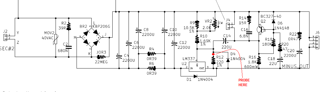

JT you'll want to find out whether the denoiser is injecting any AC waveform(s) onto the LM337's adjustment pin. In a correctly working regulator, there should be no AC waveform at all ... but your regulator might not be working correctly.

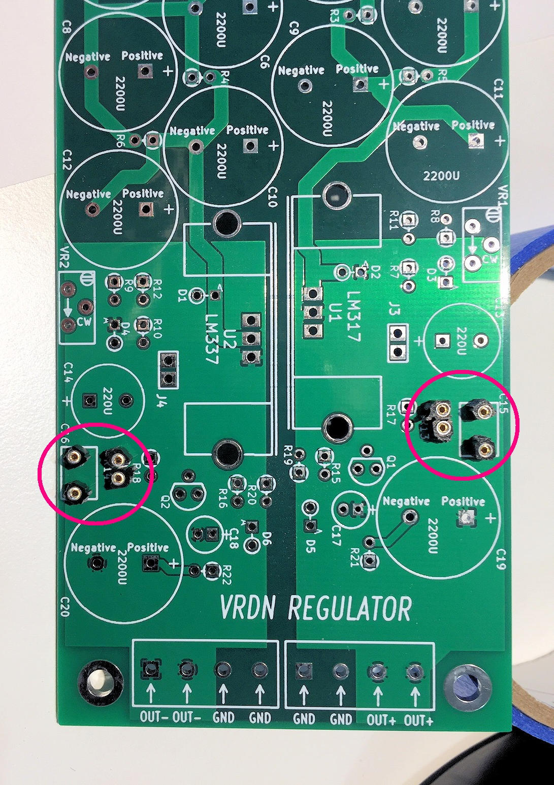

If you bent the leads of resistor R12 following the PCB silkscreen drawing, and then stuffed R12 as the silkscreen shows, then the long loopy end of the resistor (the top end, farthest from the PCB) will be connected to the LM337's adjustment pin. That provides a very convenient place to clip the tip of your scope probe, to display the waveform.
While you have the probe there, snap a picture of the waveshape when (A) the denoiser jumper is removed; (B) the denoiser jumper is added.

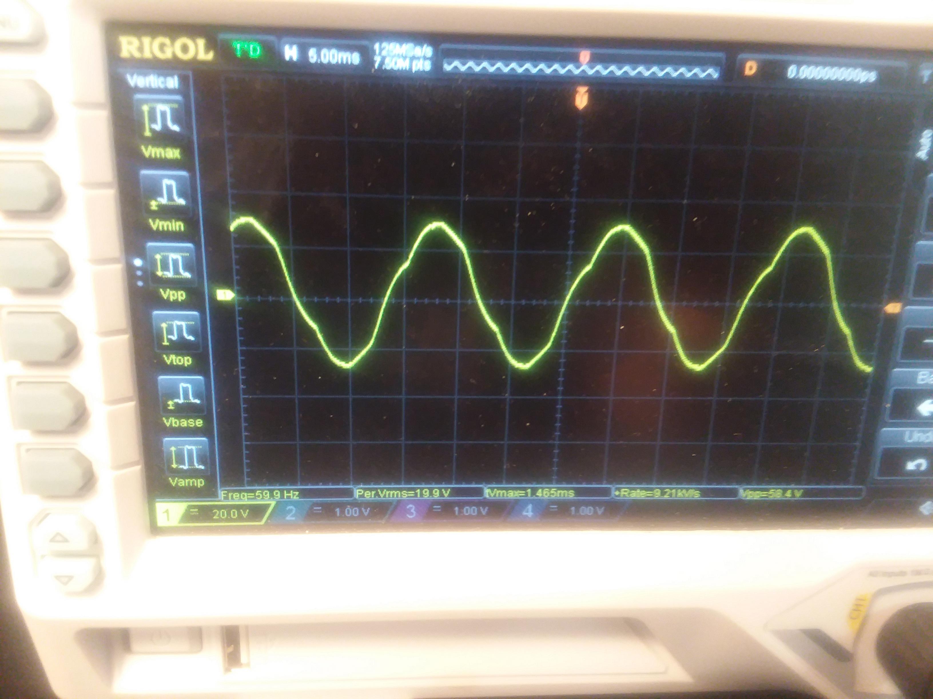

Edit above:
The above was with the ground floating. My scope skills are very limited. I grounded the scope to the audio ground and I get no AC form at all. R11-R12

Do you see why this is suspicious? The only interaction between jumper J4 and the RED PROBE HERE NODE, is through a capacitor: C14 . How is it possible that J4 affects the DC value of RED PROBE HERE NODE ?

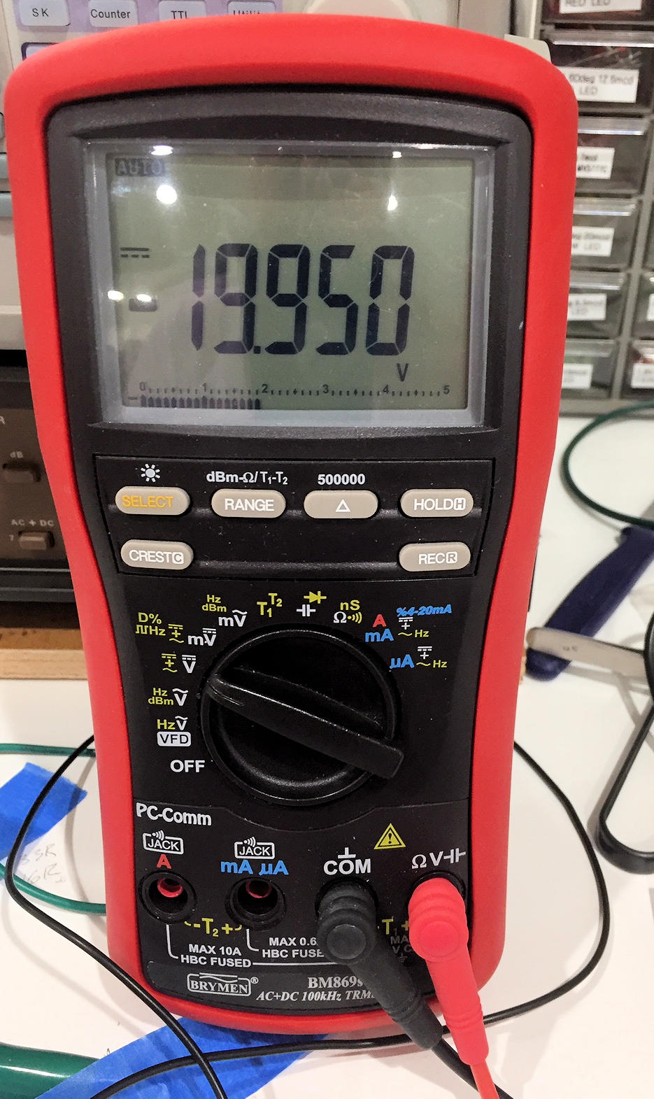

1. When you attach your DVM probes to "RED PROBE HERE NODE" and ground,
2. And jumper J4 is not installed,
3. The DVM reads 14.45 volts
However,
4. When you attach your DVM probes to "RED PROBE HERE NODE" and ground,
5. And jumper J4 is installed,
6. The DVM reads 18.75 volts

I'm surprised, I didn't see this on any of the boards I built and tested. Unfortunately, I gave them all away, so I can't run a quick re-test this morning. I've got a couple blank boards and most of the parts to quickly build-up another board for testing. I'll be using the exact Mouser part-numbers provided in the Detailed Parts List, with no substitutions or hey-this-is-what-I-happen-to-have-lying-around.
I assume both of you (@ZUM911 and @thompsontechs) have configured your board for a dual secondary transformer?
Please think very carefully about this: connecting a capacitor to ground (via jumper J4), appears to make the DC output voltage change. A capacitor. Makes the DC voltage change. What could that possibly mean? Please think about it.

JT - do the same test but with your DMM reading AC volts... it should read zero, but does it? That will be useful information.
@6 I get an initial small reading and it goes back to zero.

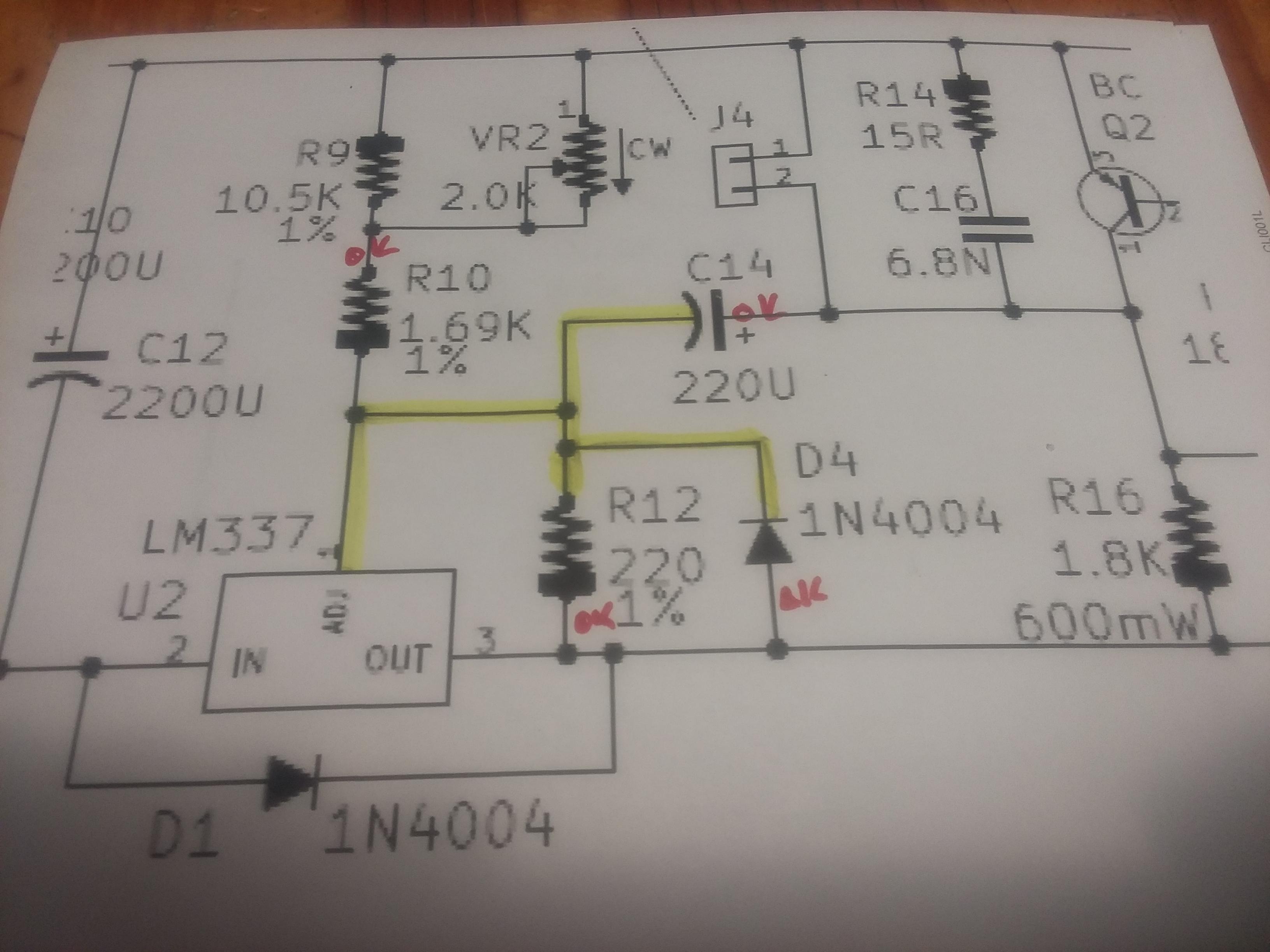

@ALL
I got the data... and am attaching pics. You can see the Vpp is just under 2v.
A pic of the waveform and also the schematic with the yellow being where the AC is and the red OK designating that there is no AC. The IN of regulator is also clean.

Hi Mark, thanks for you help with this.
The waveform JT shows is the same shape I see on either side of C14 with the denoiser enabled. I do see a different amplitude of AC on either side though. I see JT has his oscillating at about 241kH, mine oscillates at about 250kH.
Your question about the capacitor to ground. All I can offer is that a capacitor to ground will need a period of time to charge and come to the voltage presented. I suppose if the cap is faulty and has too much ESR it would behave like a resistor. I'm not sure what you mean by "appears to make the DC output voltage change"? I'm assuming you mean the output of the device. It does, in fact, change. It does not appear to change.

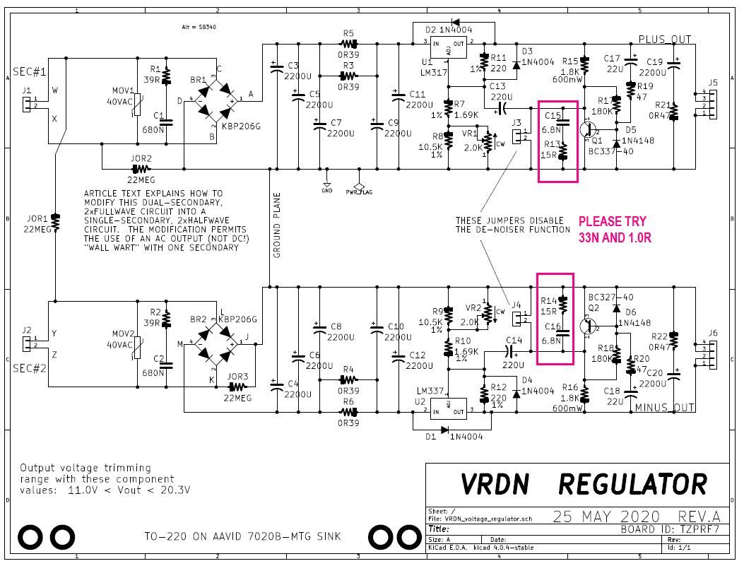

If a HF oscillation is present, it will shift the DC operating point of the regulator, this is not abnormal in itself, it is a consequence of the instability.
Checking/increasing C16 would be the first troubleshooting step (try 10 or 22nF).
Check that R14 is actually 15ohm. You can try to short it, or modify its value.
C22 could also be problematic if it has an excessive ESR, but that's unlikely for a new cap.
Make sure that R22 is actually 0.47ohm, not 4.7 or 47 ohm for example.
The combination of R22 and the ESR of the cap could be excessive, even if R22 has the correct value. You can try to short it, or parallel it with another 0.47 resistor

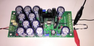

Because I had given away every one of the complete VRDN boards I had built, I didn't have one to run tests upon. So, yesterday afternoon and this morning, I built a new one. Figure 1 shows the new board; I added sockets to make it easy to swap out some of the compensation components. These sockets are circled in pink.

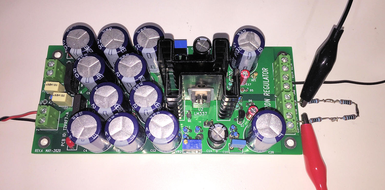

The finished board is shown in Figure 2. I've attached a load resistor which is simply four 100 ohm, 0.5W resistors in series. At 20V output, the current will be (20V / 400R) = 50 milliamps, and the power dissipated in each of the four resistors will be (5V * 50mA) = 250 milliwatts.
I turned the trimpot VR2 to max clockwise and got -20 volts output, see Figure 3. There was no oscillation visible on the scope, and the output voltage didn't misbehave as I was turning the trimmer potentiometer. There was no instance where turning the pot "up" made the output voltage go "down".
This is the same thing I saw on all the other VRDN boards I've built (and given away). They are all able to output the design max value of 20V, (on both the OUT+ and OUT- halves of the regulator), and none of them oscillate.
So the next thing I did was perform some simulations. I found that the circuit became EVEN MORE STABLE in simulation, if the series RC compensation network was changed. Instead of (6.8 nanofarads SERIES 15 ohms), I found that (33 nanofarads SERIES 1 ohm) was even more stable.
So I removed those components from their sockets and replaced them with 33nF and 1.0R. The VRDN continued to not-oscillate, the output continued to be +20V and -20V. But we have backed up and put even more distance between ourselves and "the cliff of death", therefore we now have greater safety. And that's what I suggest that members @ZUM911 and @thompsontechs try on their boards. For some unknown reason, your stock, unmodified, plain ordinary VRDN boards are less stable than mine. Let's make them MORE STABLE and see whether your issues disappear.
