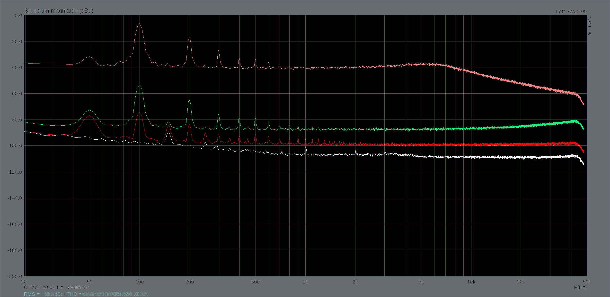

The main scope of making this LNA was for differential measurements so I know if the denoiser works or not. Been very helpful this way so far. I don't really trust the absolute values as they are not really of much use to me. I get more use out of seeing if the denoiser is working or not, and testing enough different applications of the denoiser, I got a sense of where the levels should be. That is good enough for implementing, but clearly not good enough to have an absolute value battle with other calibrated devices.

Here's measurements for simple LM317 without Cadj, LM317 with denoiser, with dienoiser, and last trace is my LNA's input shorted at the cable end where I sense the output of the LM317 pcb. This is enough to tell what's happening, without needing absolute values.
Also as you notice the noisefloor is reduced the same as the ripple. That is good, that is what you want when you add the denoiser. When the ripple is not being attenuated the same as the noisefloor then there's something that's not optimal.
edit: the 60dB gain of the LNA is not included on the ARTA scale, so add -60dB to it.

These types of measurements maybe useful to you but useless for most of us as they are not comparable to measurements made by others or to datasheets. Also regarding ripple the 2 topmost graphs have almost the same ripple so where is the 30db ripple reduction?
Exactly! They look almost the same. The ripple reduction is the difference in value on the left for each 100Hz signal. That is the denoiser vs simple LM317 reduction, in ripple and also in noisefloor. That is the idea. See how relative measurements help? We don't need the absolute value, we need to trust that the ADC can reliably measure a 30dB span. Even if its off by 1-2dB, still good enough to tell if the denoiser works as it should.
A working denoiser, if you measure at the denoiser's point of sensing, should give the full 30dB of noisefloor reduction vs Cadj, or around 50dB noisefloor reduction vs simple LM317.
If there's anything not optimal with the implementation, and the denoiser is working, the noisefloor is 30dB (vs Cadj) or 50dB (vs simple LM317) lower, but PSRR suffers. At least that's what I observed so far.
The idea is that when the denoiser or dienoiser are working, they reduce the ripple (through increased PSRR) and also the LM317 own self-noise which is the noisefloor you see, by the same amount at the same time. Namely around 50dB for denoiser vs simple LM317. Both traces look almost the same, just that the denoiser one is 47dB or so lower. The traces have two components in them, the noisefloor, and the 100Hz ripple signal (and harmonics of that). When both go down the same amount (namely around 50dB for denoiser vs simple LM317) then you know the denoiser is working fine and offering the full performance.
Knowing that the denoiser should lower everything by around 50dB is enough in a relative measurement. No need for accurately calibrated devices. With a LNA you only need your average soundcard that can tell the difference between two signals 50dB apart, in its own dynamic range window. You measure before, and after, and if you see everything 50dB lower (for simple LM317 with denoiser added to it), then the denoiser is working fine. If only the noisefloor goes 50dB lower, but the ripple signal goes 25dB lower only (for example) then there's things that are not optimal in the circuit.
Your measurements may have some value as relative measurements between your DUTs. But they have little value outside your tests especially regarding noise measurements. Noisefloor on your graphs can simply be lowered by increasing FFT length.
It is also easy to see that your noise calculations are way off. Your LNA probably has a noise floor of 0.6 nV/rtHz based on measurements of the same LNA in another thread. So the total noise of that is about 100nV over audio range. Based on your graphs dienoiser is clearly above your LNA so it most definately does not have noise below 100nV. So Tombo56's comment about your measurements being -20dB off is quite accurate.
