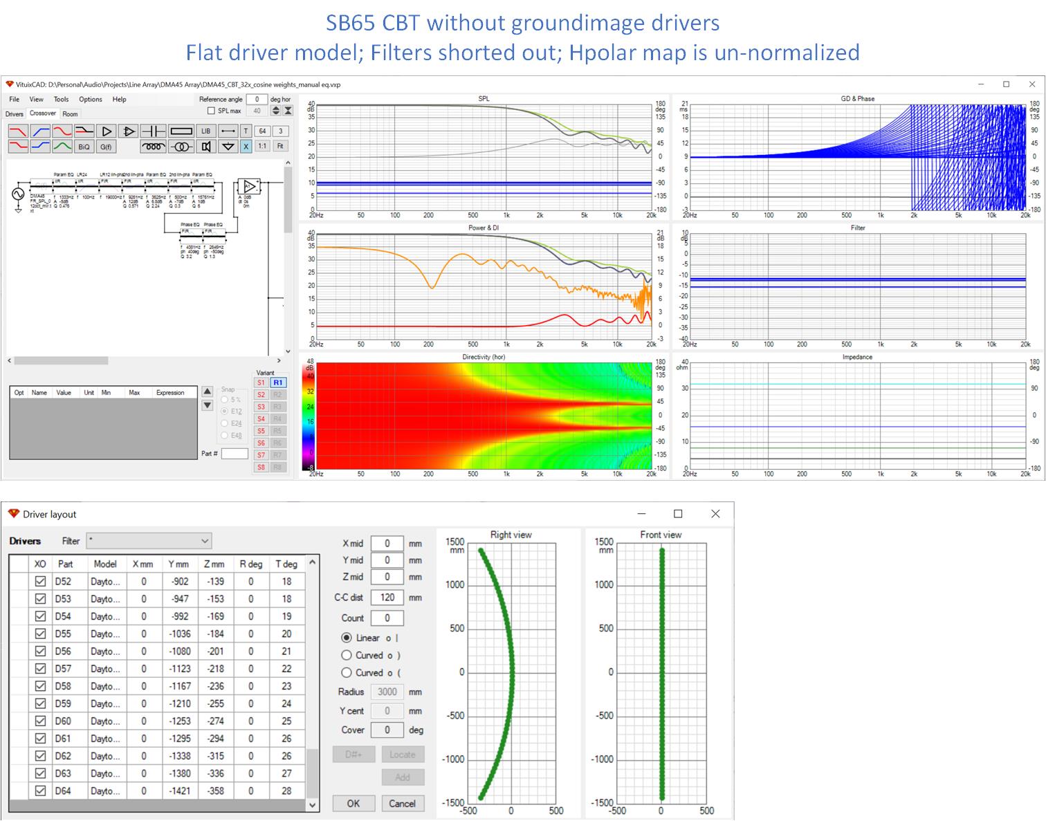

Hi Kimmosto:

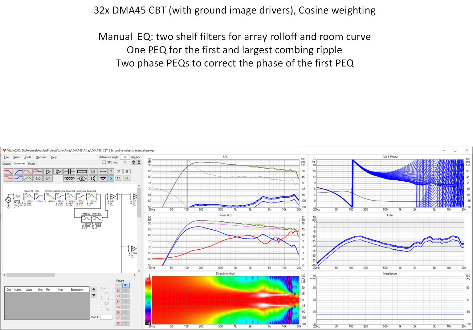

I am using Vituix to model a CBT line array. Its showing some "blooming" (white regions) in the upper midrange-lower treble of the horizontal polar map independent of whatever I use for driver directivity data. This phenomenon doesn't show up in any of Don Keele's graphs so I wonder if its some kind of simulation artifact. I'll attach a screenshot for you to look at. Further discussion is at the end of this thread

I used the driver layout screen to place the 64 drivers on the baffle. For that many drivers it constrains the arch angle. I wanted 60 degrees, it gave me 56.x which I guess is close enough. It would be great if I could specify a larger arc so I could do more virtual experiments.

^I can't repeat that clear and constant off-axis peak to lower treble here with standard CBT, without crossover and added mirror sources. Circular baffle and line array with centered driver(s) have some systematic diffraction behavior i.e. humps and dips are not much diffused, but it's not that clear - as you said that peaks are there with any off-axis data.
VCAD calculates in frequency domain with 1/48 octs frequency steps which can't handle e.g. group delay calculation properly with long distance differences between drivers. But pressure summing should work okay so that does not explain. Coordinate system of mic and driver movement were not compatible for boundary reflection calculation in earlier versions, but errors should not occur if Microphone offset was X,Y=0,0.
It looks some artifact or coincidence related to combination of crossover and geometry, but difficult to figure out without revealing project and settings.

Thanks for a thoughtful response. Removing the ground image drivers is something I should have tried myself but I still see the problem there. I simply disconnected D33-D64 in the schematic and configured the flat driver model. But showing Hpolar map unnormalized made for an interesting and suspicious picture. That picture didn't change when I re-connected the image drivers.
Room response curve has only floor reflection checked
^^That design is not normal CBT because listener is close to focal point. Distance from listener/mic to top driver should be the longest with CBT i.e. driver layout should be created with the lowest option o ( where small o is round head and parenthesis/arc is driver array. More positive Z is longer distance from mic to driver, and more negative Z is closer to mic/listener.

That would explain a lot! So negative Z is towards the mic?
That can explain no less than everything
Yes, negative Z towards the mic. Also this is heritage from LspCAD.

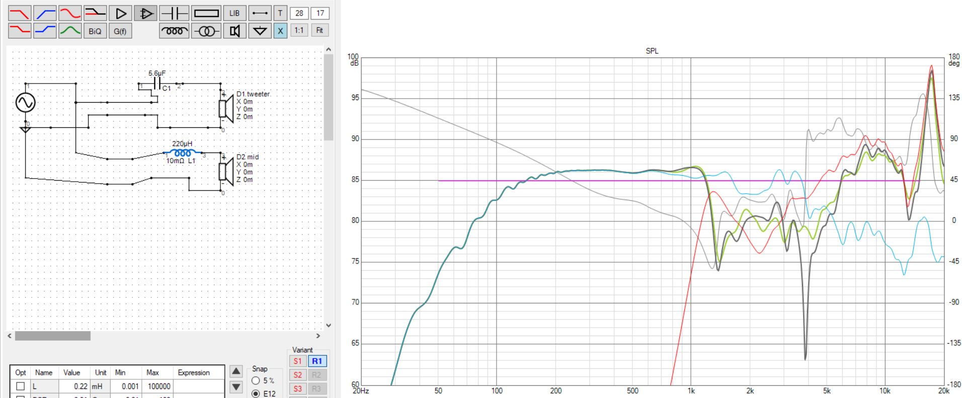

help with cross over design
Hello I am a novice speaker builder and this is the first crossover I have designed. Does anyone have advice for me? Any help is welcome. I have large dips and peaks in my SPL graph. How do I straighten them out? I have added a screenshot of what I have designed so far. Thanks in advance!
