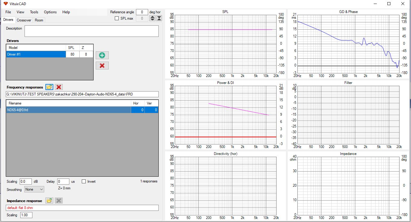

Hi. I'm new bee with this program.Downloaded new version and stuck.
Simply can't upload any spl data.
Only one window "GD&Phase" is showing graph.Rest 3 is remain empty.
gdf and zma files been downloaded from parts-express. Tried create via SPL trase - no luck either.
Uninstall/reinstall.... Using Windows 10
Anyone have any thoughts? Maybe I missed one tiny tick somewhere?

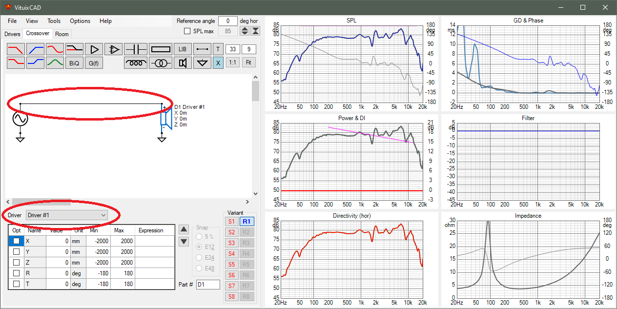

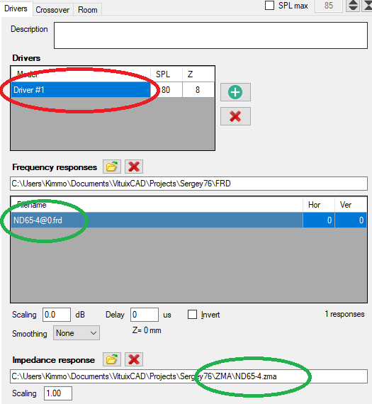

See "How to start working with VituixCAD", Tip 2 in the end. Then follow all items before that one before asking next question.
Thank you. Downloaded projects. Managed open both projects. All windows automatically opened.
Once I added new driver and tried to add new frd file for SPL graph - nothing happened 🙂

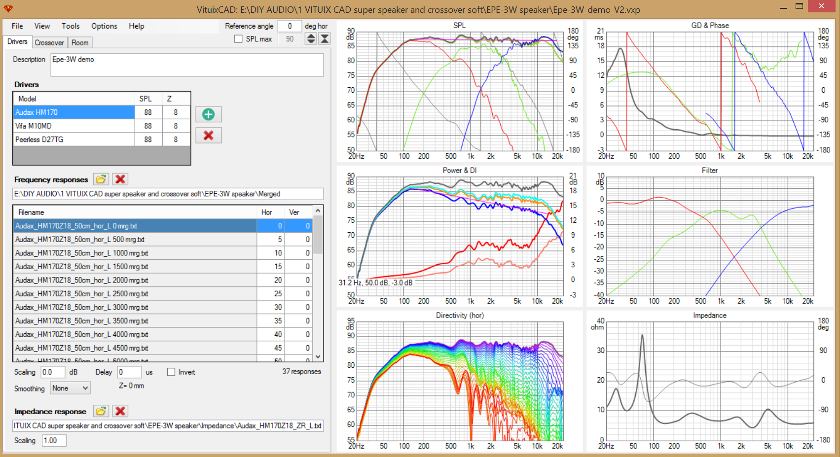

Incredible soft - Thanks
After many years out from the DIY audio . I am have a new house with more space and that will allow me to experiment. I was using BassBox when I stopped my speaker building and whenI tryed to upodate my soft I was told I had to buy a new license.
You freesoft has given me the oppportunity to start experiementing again with a free soft with awesome capabilities.

Trying again to say thanks with pictures - thanks!!
After many years out from the DIY audio . I am have a new house with more space and that will allow me to experiment. I was using BassBox when I stopped my speaker building and when I tried to update my BB, I was told I had to buy a new license.
Your free soft has given me the opportunity to start experimenting again with a free soft with awesome capabilities.
