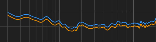

Hey Kimmosto, first of all, thank you - I often use VituixCAD for my speaker research and reviews.
Second I wanted to make you aware of a potential issue with how VituixCAD calculates the Early Reflections curve from CTA-2034A
Recently over on ASR we've been having a discussion about some ambiguities and apparent typos in the CTA-2034A standard, as spotted by member Dave Zan. Of particular note is the process for calculating the Early Reflections (and by extension, ERDI) curve. You can read my breakdown of the issues here, but long story short the questions were:
1) Does the rear portion of the ER curve only include 3 angles (180, +90, -90), or 19 angles (everything from 90 to -90).
2) Is the standard calculated as a single average of the listed measurements, or do you average each "portion" of the ER curve first (ceiling, floor, front, side, rear) and then average the 5 averages.
I noticed VituixCAD appears to only use 3 rear angles and performs a single average of all the angles (26 angles total) . We eventually got Todd Welti of Harman to [chime in](Spinorama! (also known as CTA/CEA 2034 but that sounds dull, apparently) | Page 3 | Audio Science Review (ASR) Forum) and clarify that Harman calculates the ER curve using all 19 rear angles, and does indeed performs an average of the 5 averages. This has the effect of weighing vertical measurements and rear measurements significantly more heavily than in a simple average using 3 rear curves.
For an example of how this may play out in practice, here is the Dutch & Dutch 8C I recently measured. In white are the VituixCAD-produced curves vs doing it as Welti clarified in blue:
You can see there is a small but significant effect on the curves around the crossover region due to the greater weighting of the vertical measurements. Given Welti's clarification, you might want to process the curves using this method instead for consistency with other measurements. I hope the procedure is clarified in the upcoming CTA-2034B because it's quite ambiguous as written.
Thanks for hearing me out!

napilopez, could you make new comparison with ER+ERDI? Need to verify that RMS is okay for both averaging steps because RMS and simple pressure average give different results.

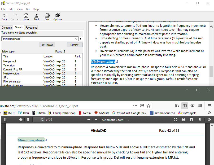

^Help files could have something useful
***Thanks!
That is ... Step by step!
1. Download the measured data to the calculator!
2. Click on Minimum phase A.
3. Save the file with a minimum phase!
Right!?

Thanks a ton for the swift update! It now matches exactly to what I get computing the average in REW.
I think RMS is fine. CTA-2034A does specify a power average for all of the averages. I'll inquire to be sure though.
