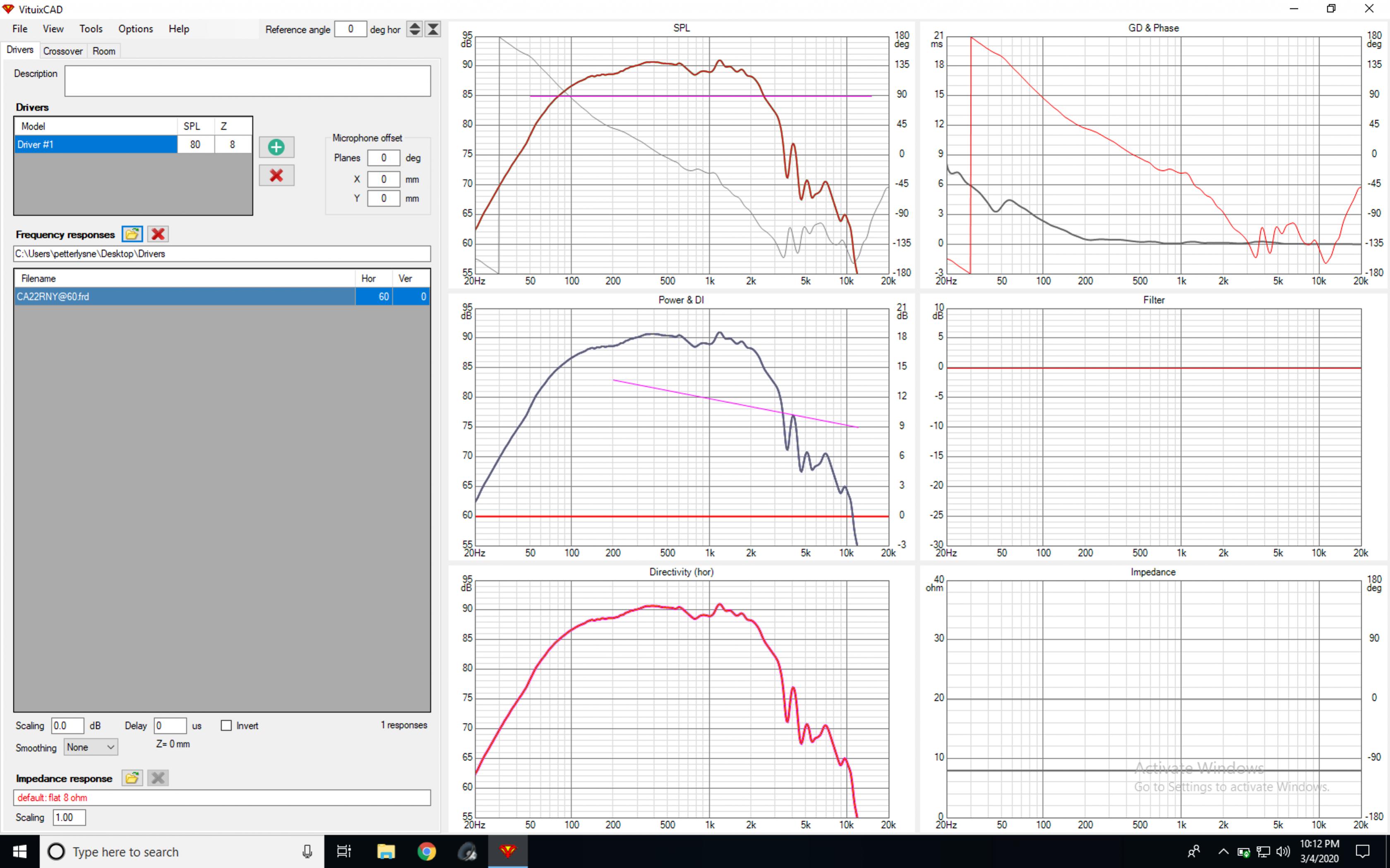

For that situation to look for clues myself would be curios see how those three txt-files 0/30/60 deg look on their own especially if that 30 deg one differ from the two others in for example its SPL number and how curve tendency look, we can read them three txt-files many ways by their own or overlaid, on their own rightclick on VC in processline and open VC one more time and load 0 deg, then repeat the same for 30 and 60 deg so now you have four times VC running hover mouse over them down on process line and one can look for any differences between 0/30/60 deg files. Also they can be overlaid if you rightclick in "Power & DI" window or use REW to look them overlaid in "All SPL" tab.
Hi Defo,

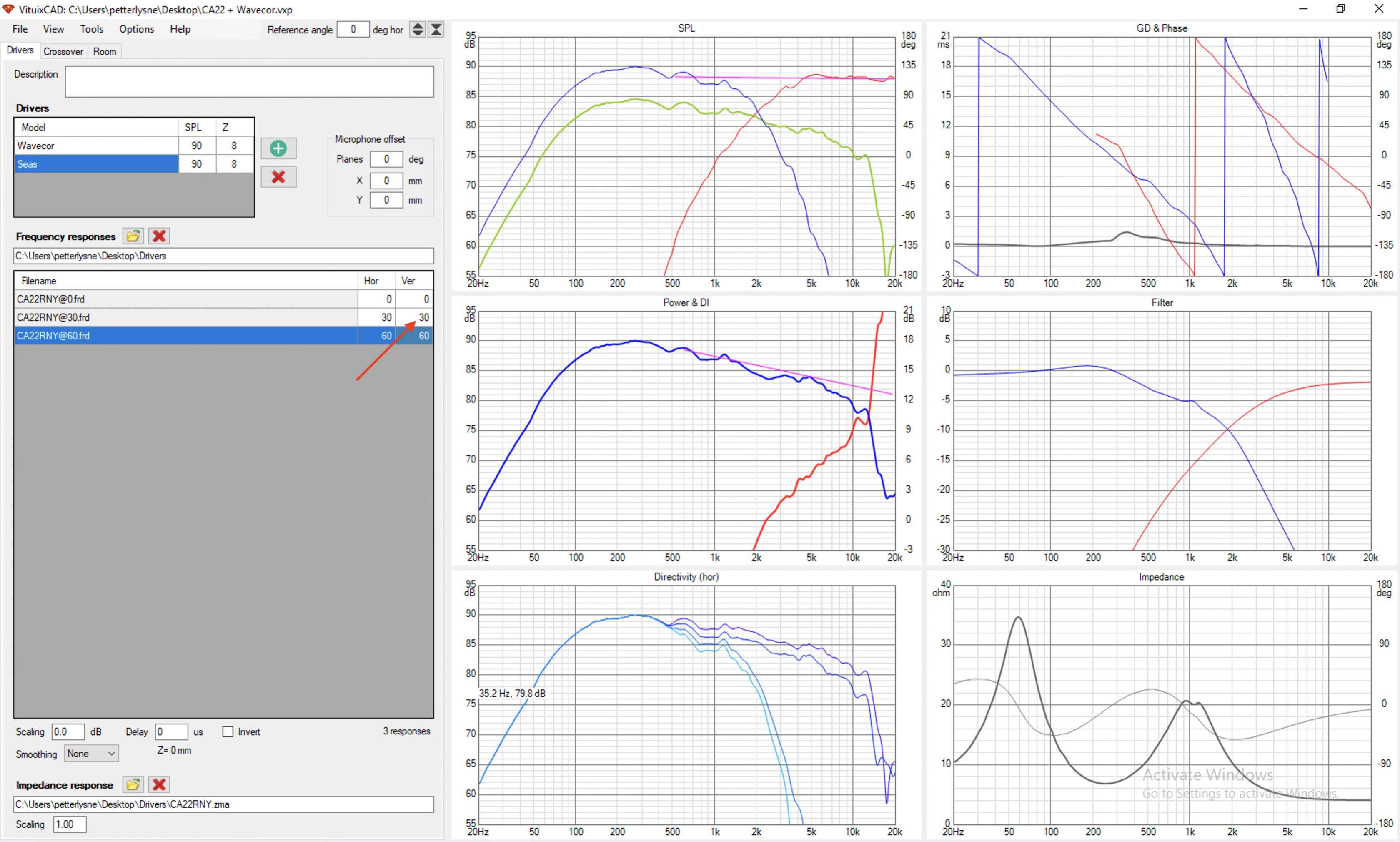

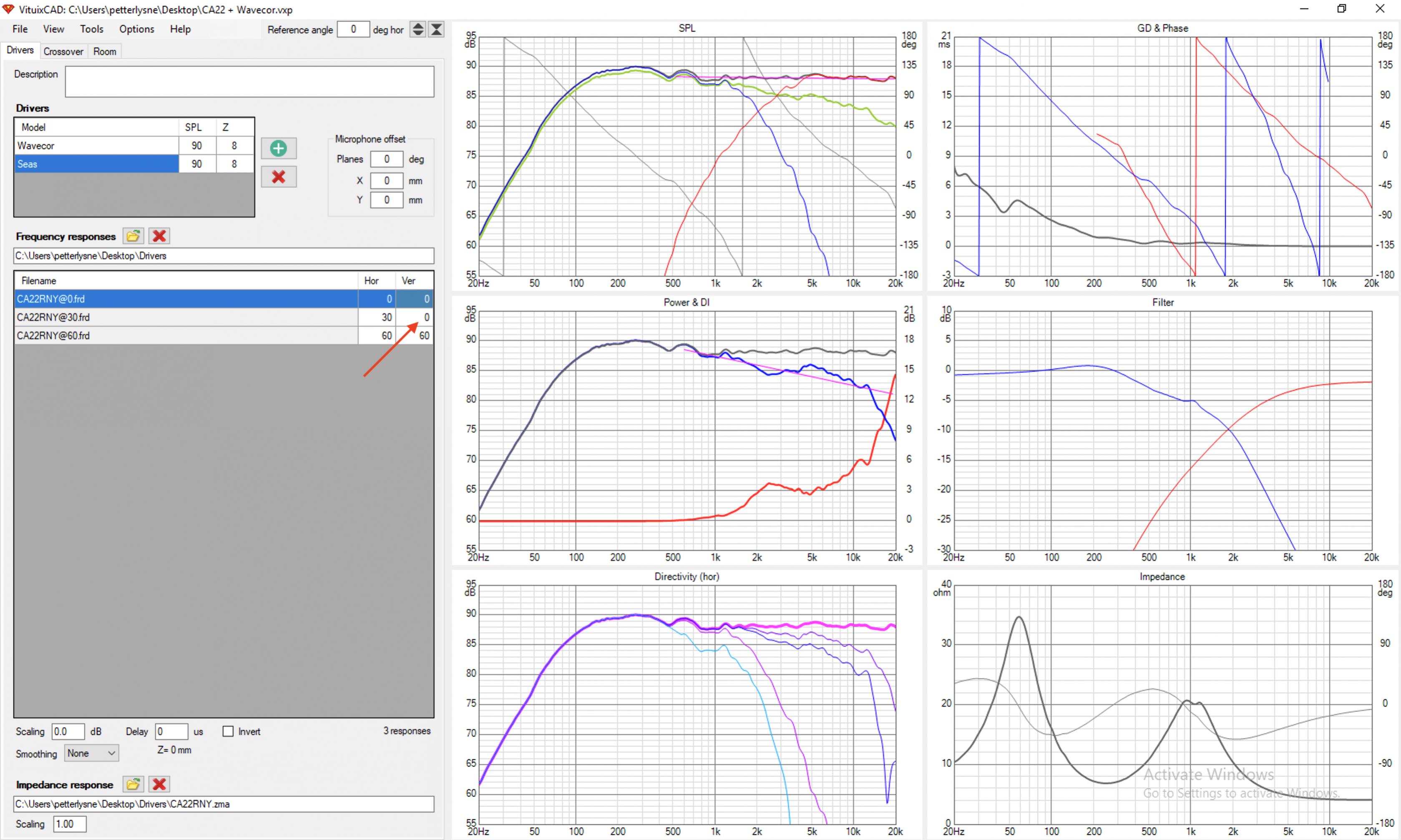

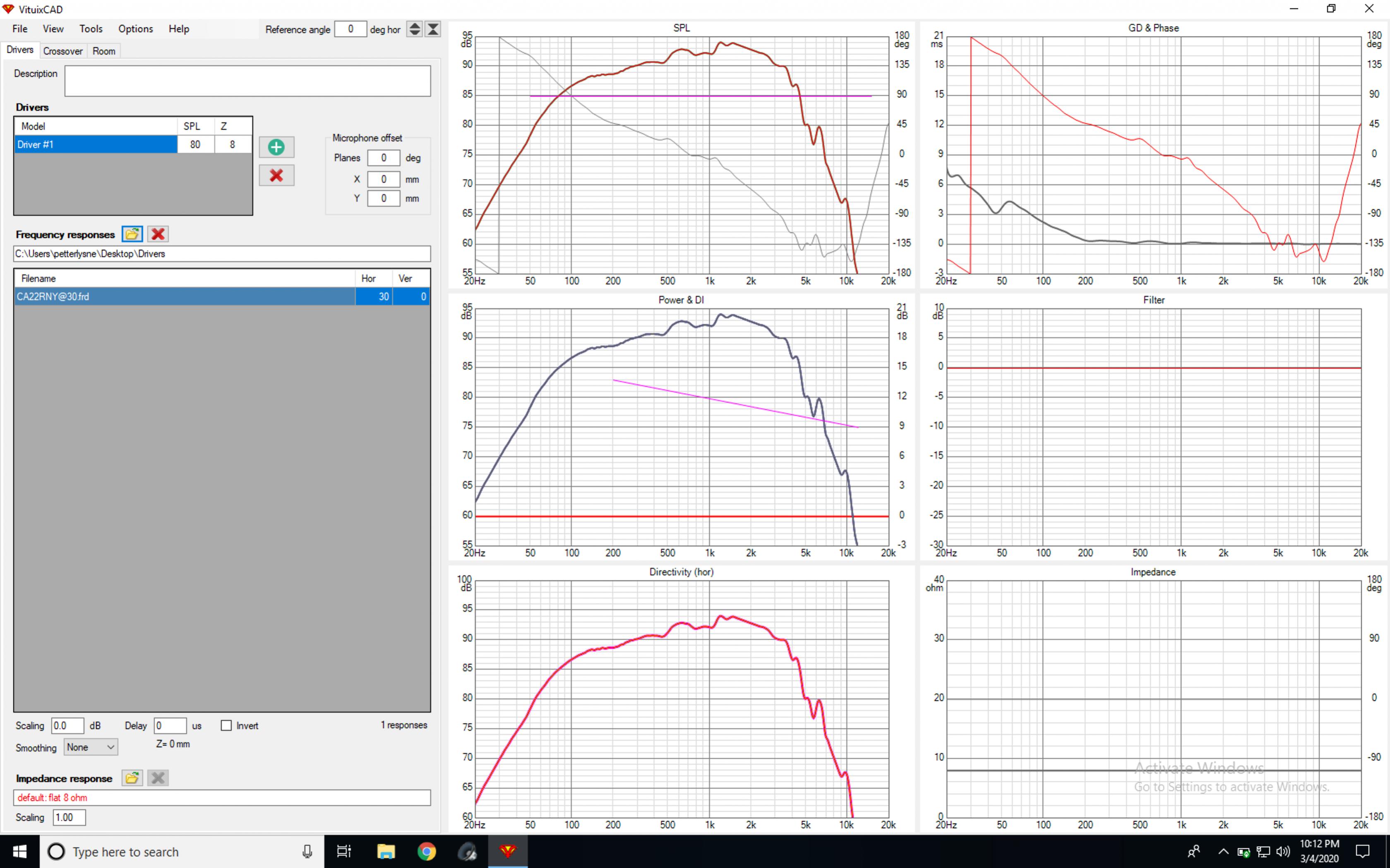

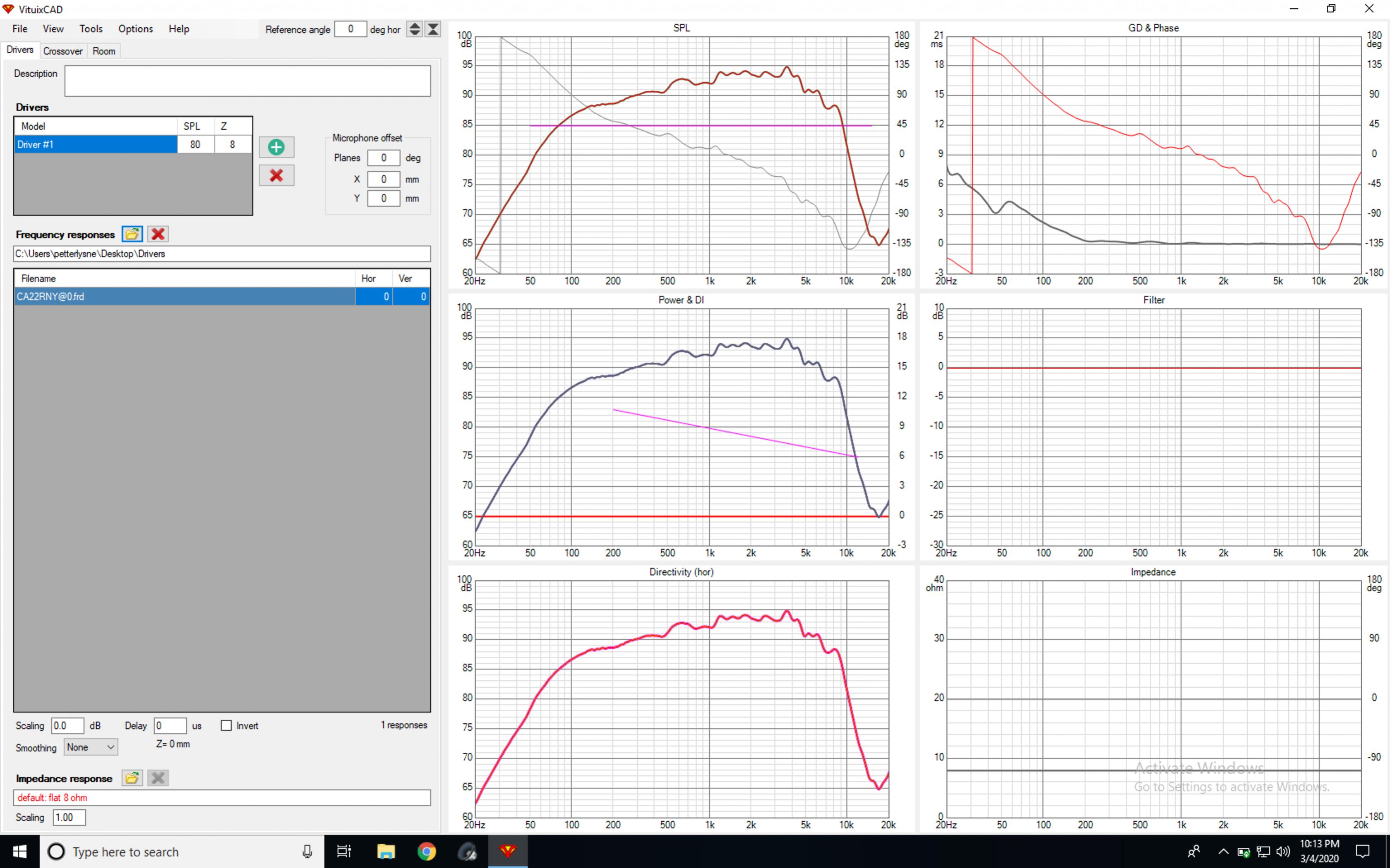

If I've understood you correctly, here's each of the responses imported into VC.

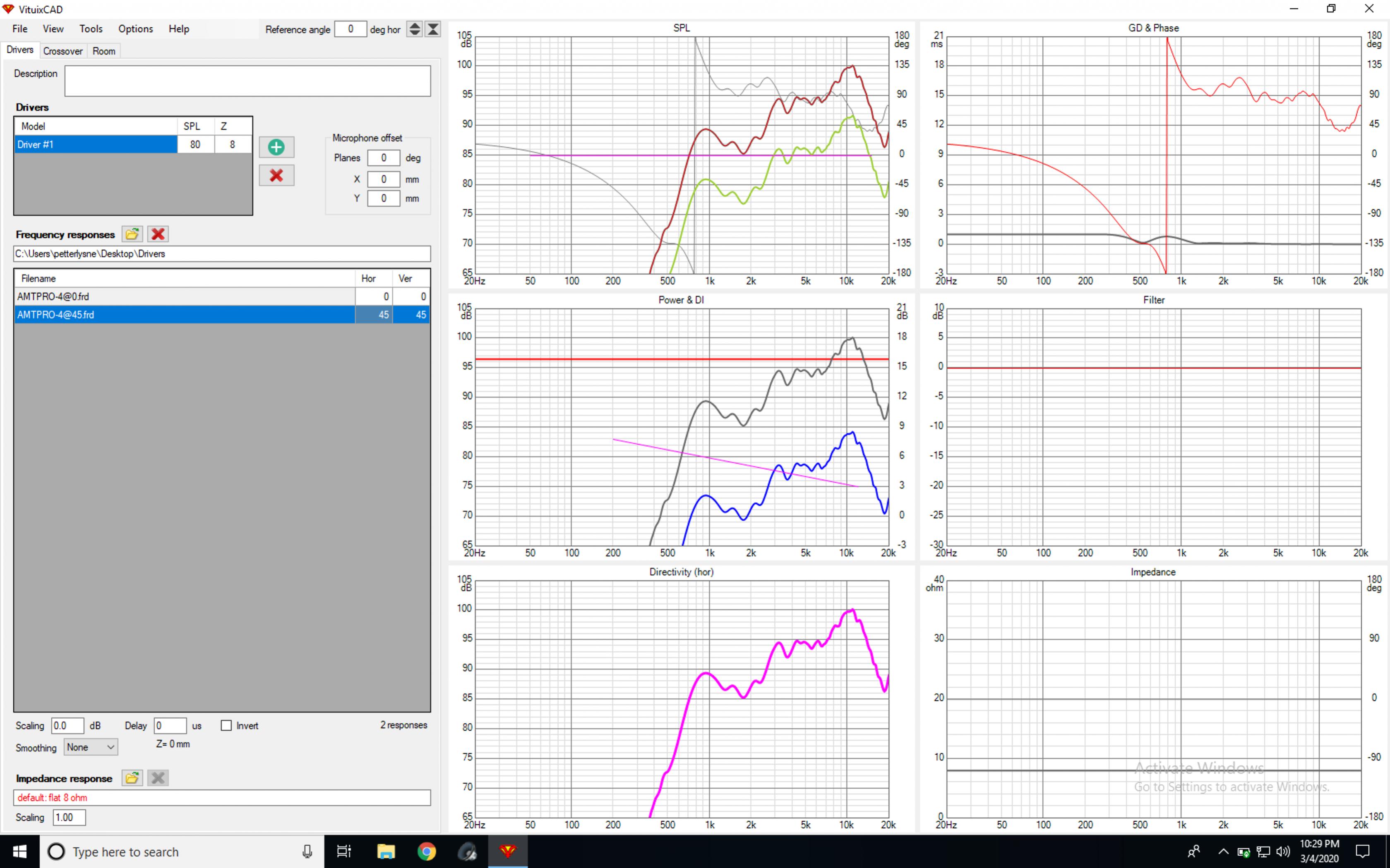

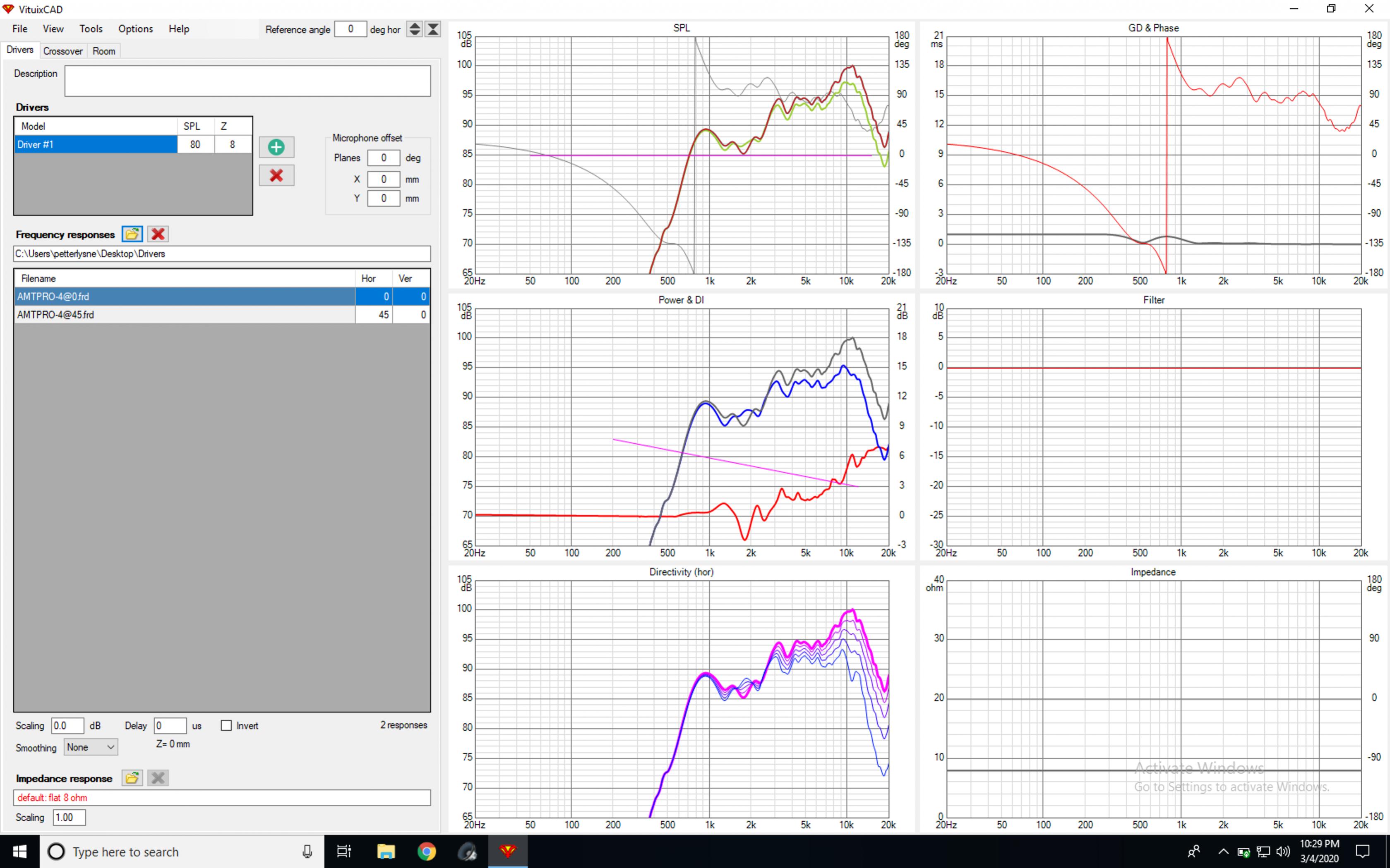

Happens with other measurements as well. Here's the AMTPRO with FRD files directly from Parts Express. When I specify the 45 measurement vertically, all goes wacky
Thanks publish result and i see they look normal in curve and same SPL scale so nothing there, myself don't no anything about code and what is the cause but i'm pretty sure you can manage this problem in a simple way, that is rename whatever hor directivity file you have so they end with below VC convention:

Single response can be either hor or ver - not both because program provides primarily dual plane acoustical simulation. Mirror missing in Options takes care of the rest. Optional rotation of planes can be done with Planes deg text box in Drivers tab.
Reading "How to start..", measurement instructions and user manual should help. File naming rules and angle coding+parsing explained more than once.

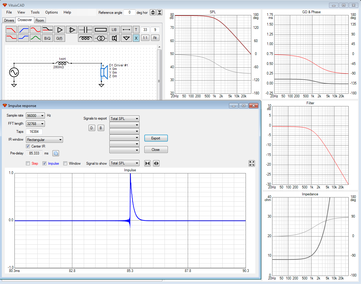

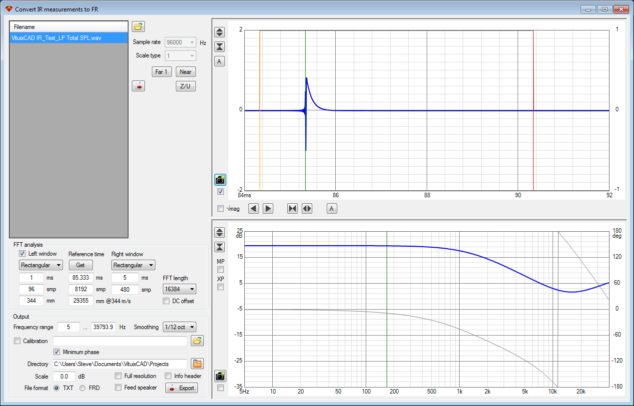

Recently noticed what I think is a bug with the IR export feature. See attached example of exporting an IR for a simple LP filter and then reading it back in with the IR to FR tool. Note that the single sample at peak value of 1 has been set to -1 in the exported file. The remainder of the impulse looks to be fine.
BTW, imported *.wav looks similar with ARTA and REW, so I believe it is the export that is the problem not the import.
Yes, there is some bug in both 24-bit PCM wav exports. Maybe some issue in byte order of truncated word. All 16-bit, 32-bit and 64-bit PCM exports seem to work okay.
24-bit mono+stereo wav IR export fixed to rev. 2.0.43.1.
Smallest possible reason: 0.00001% too high scaling factor caused one bit overflow -> sign error to peak sample. Error is still possible due to rounding. Please let me know if that happens and I will reduce gain to be compatible with 16-bit PCM wav (max value=32760).
