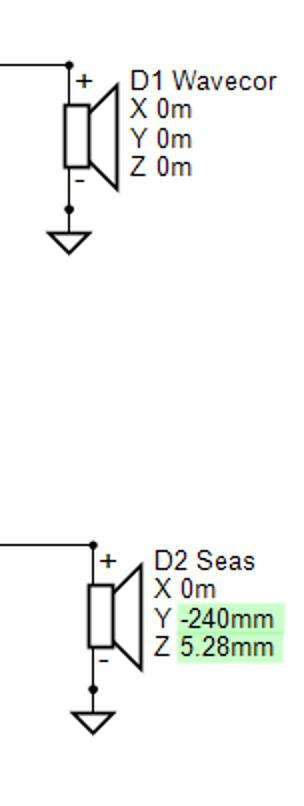

Just note that Z mm of driver instance in XO is 0 mm and Delay offset of driver's response data is 0 us if you work according measurement instructions with straight non-stepped and non-tilted baffles because mechanical rotation center while off-axis measurement sequence is at level of baffle surface and timing reference while converting impulse response (semi-dual channel) measurements to frequency response is equal to all drivers. So timing difference of drivers is included in measurement data only, and XYZ of driver instance equals to mechanical rotation center (relative to speakers origin) while off-axis measurement sequence.
In addition, Delay us parameter should be used instead of Z mm for drivers in boxed speakers with straight non-stepped and non-tilted baffles if measured or traced response data is normalized or processed with minimum phase extraction, because Delay works better than Z to high off-axis angles. This was not significant decades ago when speakers were designed with axial response only, but now situation is different with VCAD and others which calculate off-axis too.

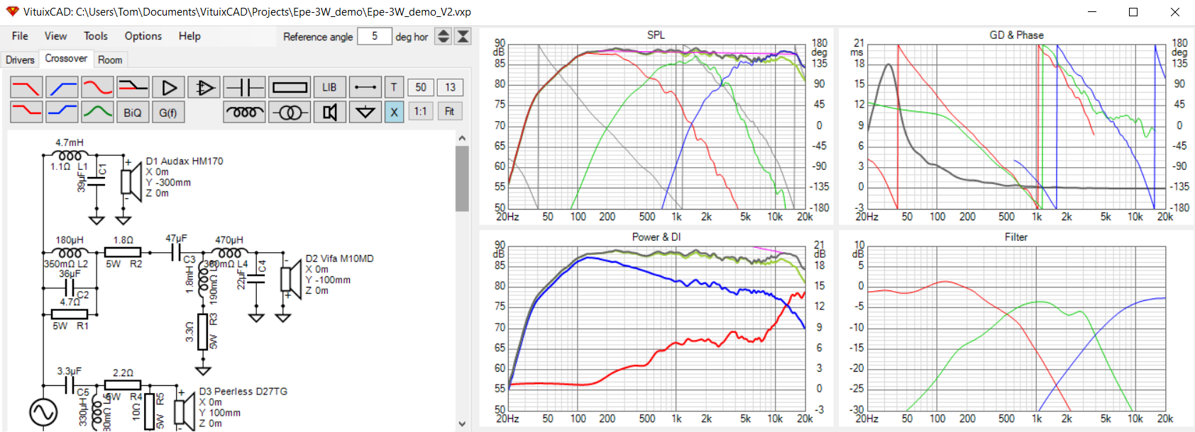

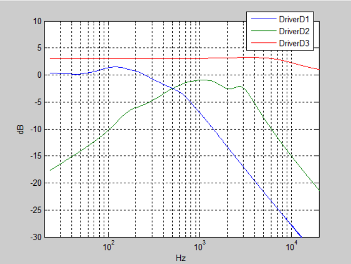

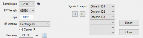

Hi Kimmosto,
While exporting the driver input impulse responses I noticed something odd in the high pass section. I have had the same issue with multiple projects now. To illustrate the issue I will use your "epe-3W_demo V2" project.
I exported the IR's of the 3 driver inputs with the settings shown in the first image. After that I plotted the frequency responses of the 3 IR's. The low pass and bandpass sections are equal to the filters shown in Vituixcad. However the high pass sections seems to be wrong.
Do you have any idea what is going wrong here? I have had the same problem with multiple projects. I am using the latest update of your software.
Thanks a lot.
Tom

^IR export should be quite okay with your settings, but converting from exported IR back to frequency response could be sensitive to time window and FFT settings. For example here is with ARTA; window start=0, FFT length=8k, win function=Uniform, PreDelay=21.333ms:
Start=0 and PreDelay=21.333ms just to make sure that FFT includes whole IR.
P.S. I would not export IIR XO with Center IR checked due to loss of taps and latency. Short start delay 0.5-1.0 ms is usually adequate for IIR. Linear phase FIR needs centering more often because ca. half of the data could be on the left side of the peak.
