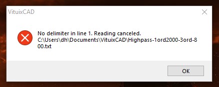

Hello people!
I am fairly new to Vituixcad, but I already love it!
However there is one thing that bothers me and I cannot find the answer in the manual or in here.
Before I learned of VituixCAD I used Rew. I took a measurement importet a curve I created in rephase, adjusted the filter, took a measurement and so on until the drivers response matched the target curve I created in Rephase.
The optimizer in VituixCAD gives the possibility to import a custom axial response target (I want to try something else than the few options provided). But it cannot open the .txt I export from Rephase. I get this error message:
Is it a setting thing in Rephase or are there other reasons?
Thanks!

^Probably the 1st row in response file exported from rePhase does not have legal header line (starts with other than 0-9 or dot or minus) or delimiter (space(s) or tab) is missing between frequency and magnitude values. Comma is not recommended separator character. Phase column is not mandatory, but gives single warning if missing with txt and frd files. Not even warning with cal and mic files.
P.S. I don't understand role of rePhase here. VituixCAD is only program you need in addition to measurement program in case you design XO with VituixCAD.
Kimmosto# Thanks for your reply!
The point of Rephase is for me to generate target curves that are not in the drop down menu of vituixcad, i.e a combination of different filters. This is just for experimental use.
I am not a crossover veteran, so for me to try out new things, I need a target curve to aim for, otherwise I am lost.
It may be because Vituixcad can do it somehow I do not know of.. Rephase may also not be the ideal tool to generate theese curves, but it is the only one I know of.
This is the first line of the generated .txt file:
"0.0000000000109293995860128"
So that should be okay I guess?

^That is impulse response file. External target response must be frequency response file.
Certain target curve of individual driver is not primary design parameter of multi-way speaker so special target curves are quite invaluable. As already told, rePhase does not play any role while designing speaker with VituixCAD.
