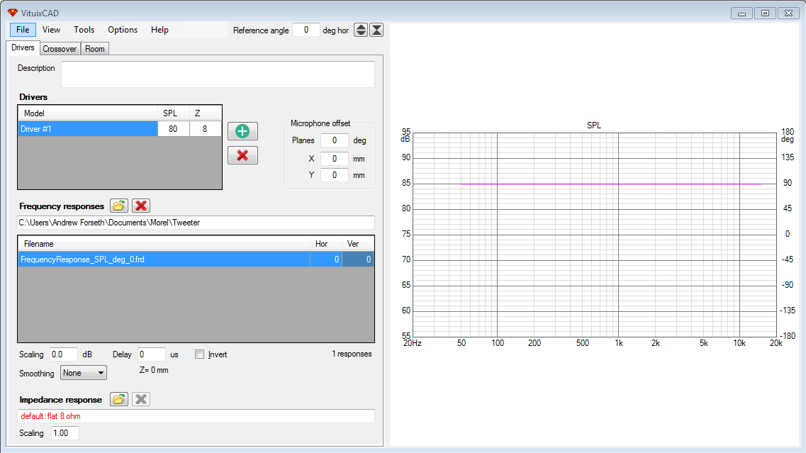

Direct me where to go if this isn't the correct thread for this, but it seems like it. I am running Vituix in a bootcamp environment on Windows 7 Pro. When I import an frd or zma file nothing happens. Files were created in Vituix with the tracing tool. I am at a loss as to what I am doing wrong. I don't have the "visible" checkboxes (see screenshot).
^I guess you have not added a wire from the generator to the driver?Tip 2
I pulled them into Xsim and they displayed. Its likely the issue is with my bootcamp implementation. I have issues similar to this with other programs in the past. My bootcamp environment is shakey at best.
Thanks for the tip. I just wanted to make sure I wasn't missing anything obvious.

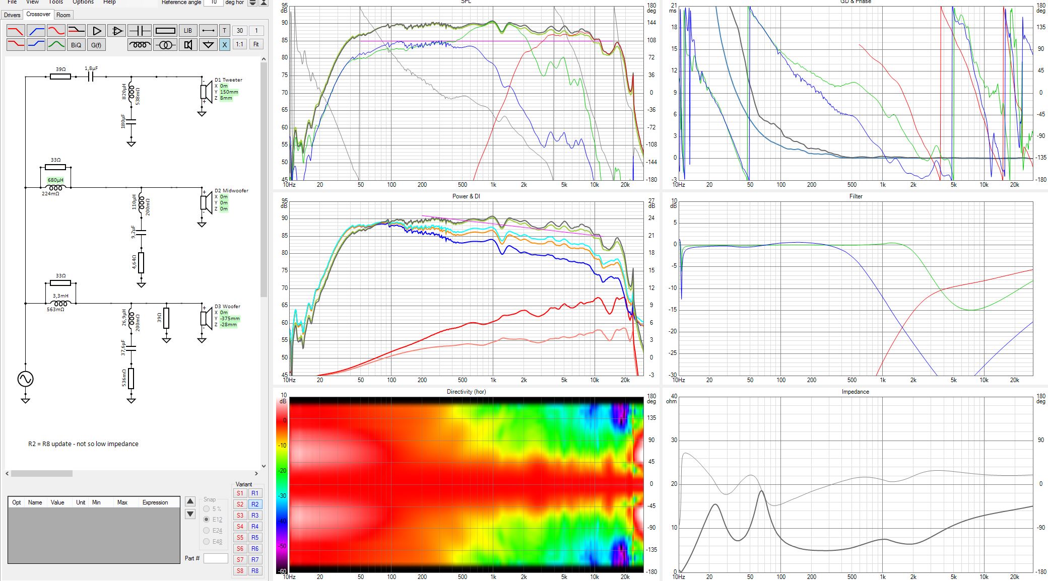

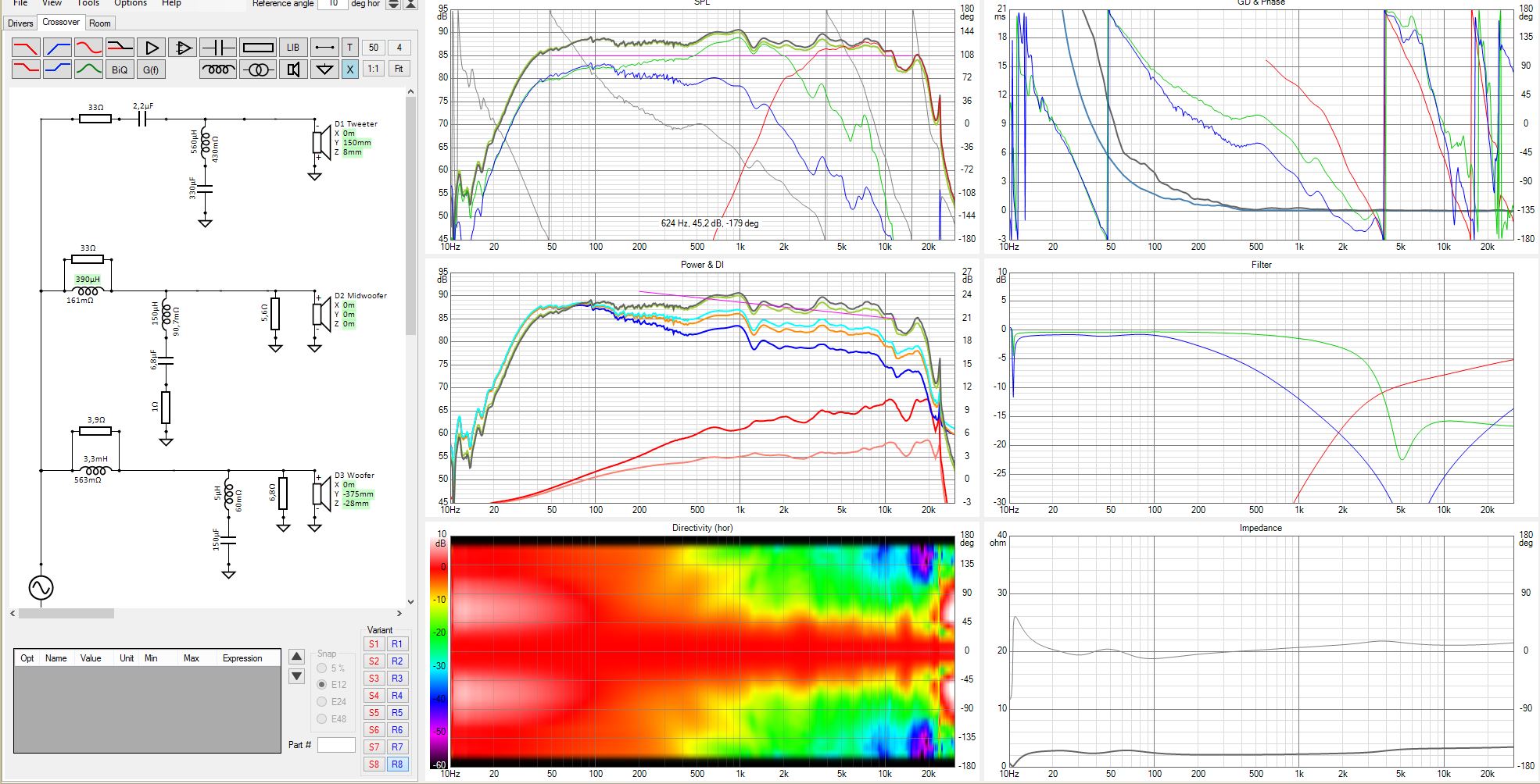

I designed simple 2,5way crossover. I wanted to achieve:
1. flat frequency response
2. flat directivity index
3. good impulse response
4. flat impedance and phase
It all ended up in very low impedance of 2,1 ohm. Do you think it is an issue if you use D-class Hypex amp that is capable of 2ohm load?
If you see sth wrong in the crossover please let me know. I just wanted to ask you for your opinion guys before I order components. Tweeter is mounted in a waveguide that is why I use little value of HP capacitor.

This is not worth stressing your amp over. Maybe it is good sometimes, but most amps do not need you to do this.4. flat impedance and phase
Your first problem is the 5.6 ohm and 6.8 ohm resistors. At low frequencies these are across the amp outputs. Together they are 3 ohms.

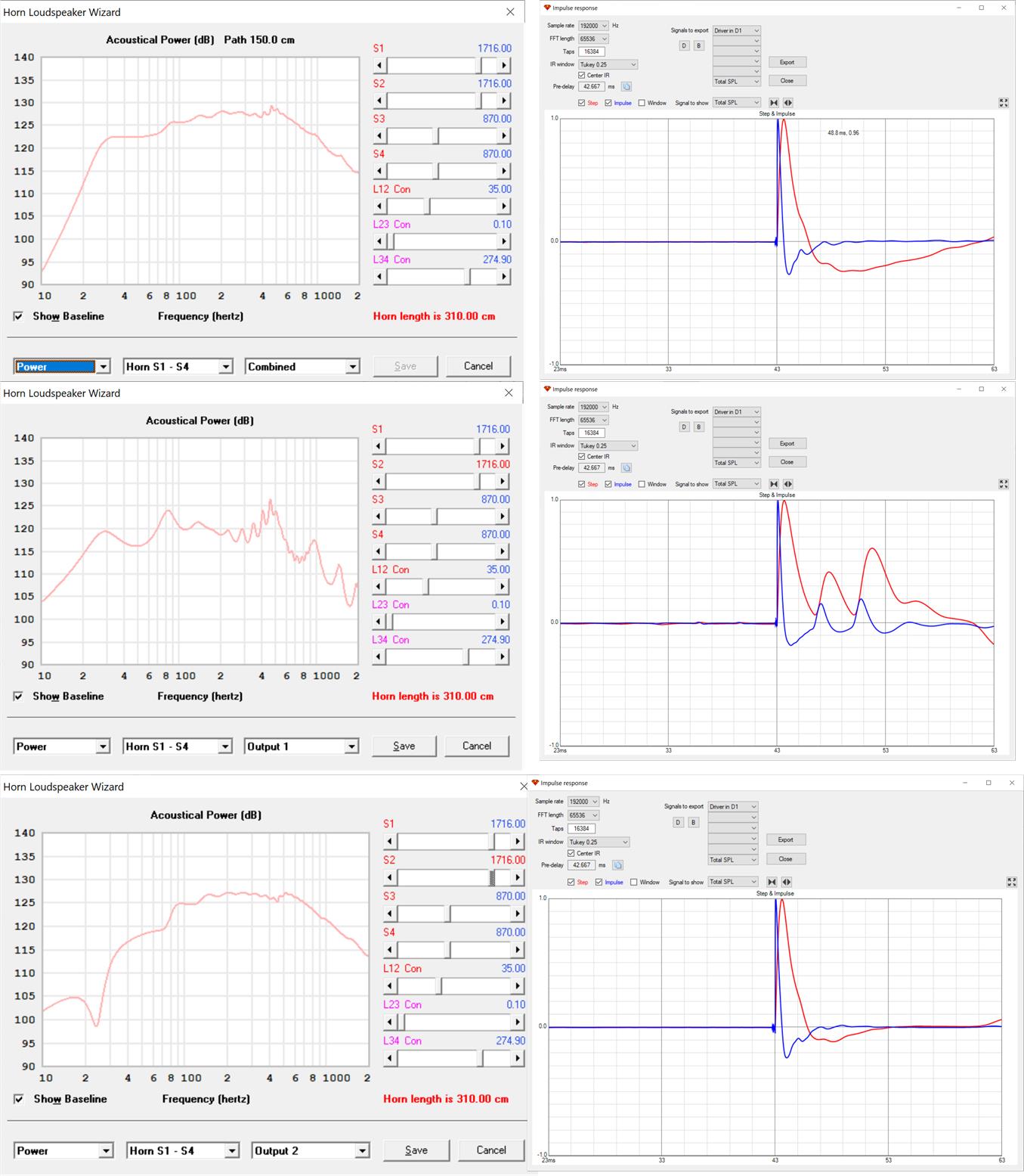

Hi Kimmosto:
Please help me understand what I've been doing with Vituix🙂
I've been modeling a transmission line subwoofer in HornResp. I needed to export from one of its screens that doesn't support export directly so I did a screen capture and then dropped the screen into your trace SPL tool. Trace gave me an SPL text file containing both amplitude and phase. Am I correct in assuming that Vituix derived minimum phase from the amplitude function that was traced? But I don't think the composite output of a Tline can be considered minimum phase...hence my question.
So I repeated this process for separate Tline and front of cone outputs separately. The output for the "optimally" damped Tline shows an IR with 3 peaks of decreasing amplitude as one might expect, given partially damped reflections from the ends of the Tline. So perhaps the minimum phase assumption isn't too far off?
The cone output looked like what one would expect from a direct radiator and clearly the simulated response of a direct radiator would be minimum phase.
I would love to be able to load both responses into a Vituix crossover-less model and add delay until they sum as in HR because I don't trust the IR derived from the screen capture of the HR model. I can point a single driver to each response separately and see its FR and IR in Vituix. But when added, the 2nd driver gets ignored. The crossover is just a piece of wire connecting both D1 and D2 to the source. I haven't created any directivity files. I'm guessing Vituix sees something wrong with or missing from the model that causes it to decline to include D2 in the response. Any idea what it might be?
Hi Jack,
Doesn't pressing the F9 function key or clicking the 'Export Data' command button give you what you want?
Kind regards,
David
