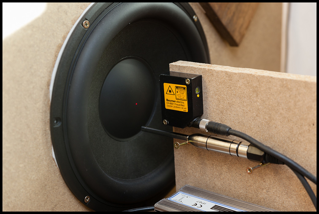

What if Vituix could import the real cone excursion data into the enclosure tool design alongside the box measurements ? ARTA has this feature, but it would be nice if Vituix also had it, that way VituixCAD would be a fully fledged platform. Its just a thought.
The image show the general method, but I do not recommend doing both measurements at the same time due to obvious reflection issues from the construction.

While I would be for a feature like that, as I have the laser needed. But I would think that this would be a very niche feature. I do not think it's very common to have this equipment among hobby users.

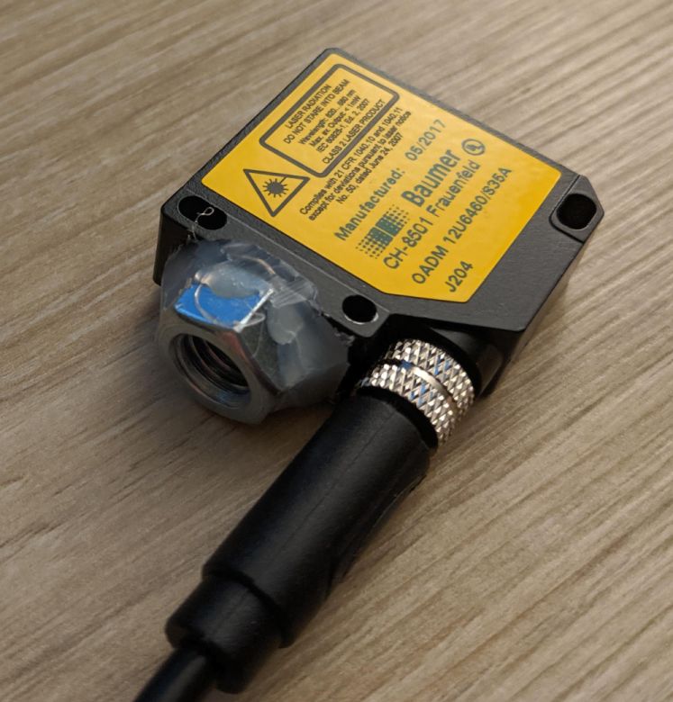

I searched Ebay every now and then for suitable laser for years and then in end got one for about 120EUR if I remember correct. That I thought was acceptable investment to satisfy the curiosity. As new these things go for >1kEUR and also as used they are usually much more expensive.
The setup issue I solved by hot gluing a nut to it, so I can attach it to the T beam of microphone stand directly.

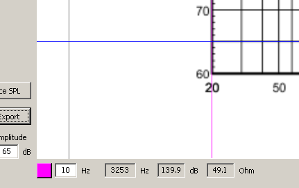

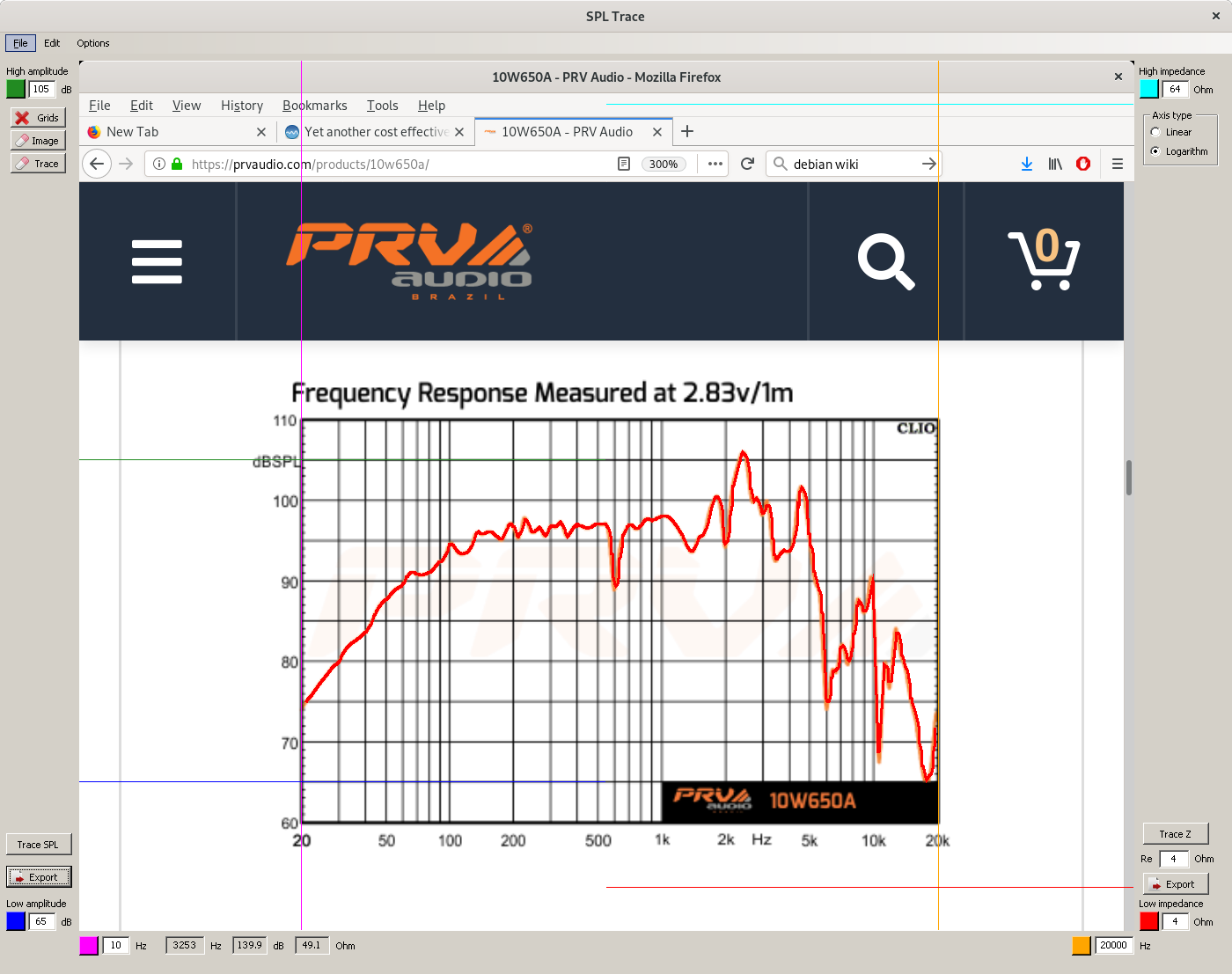

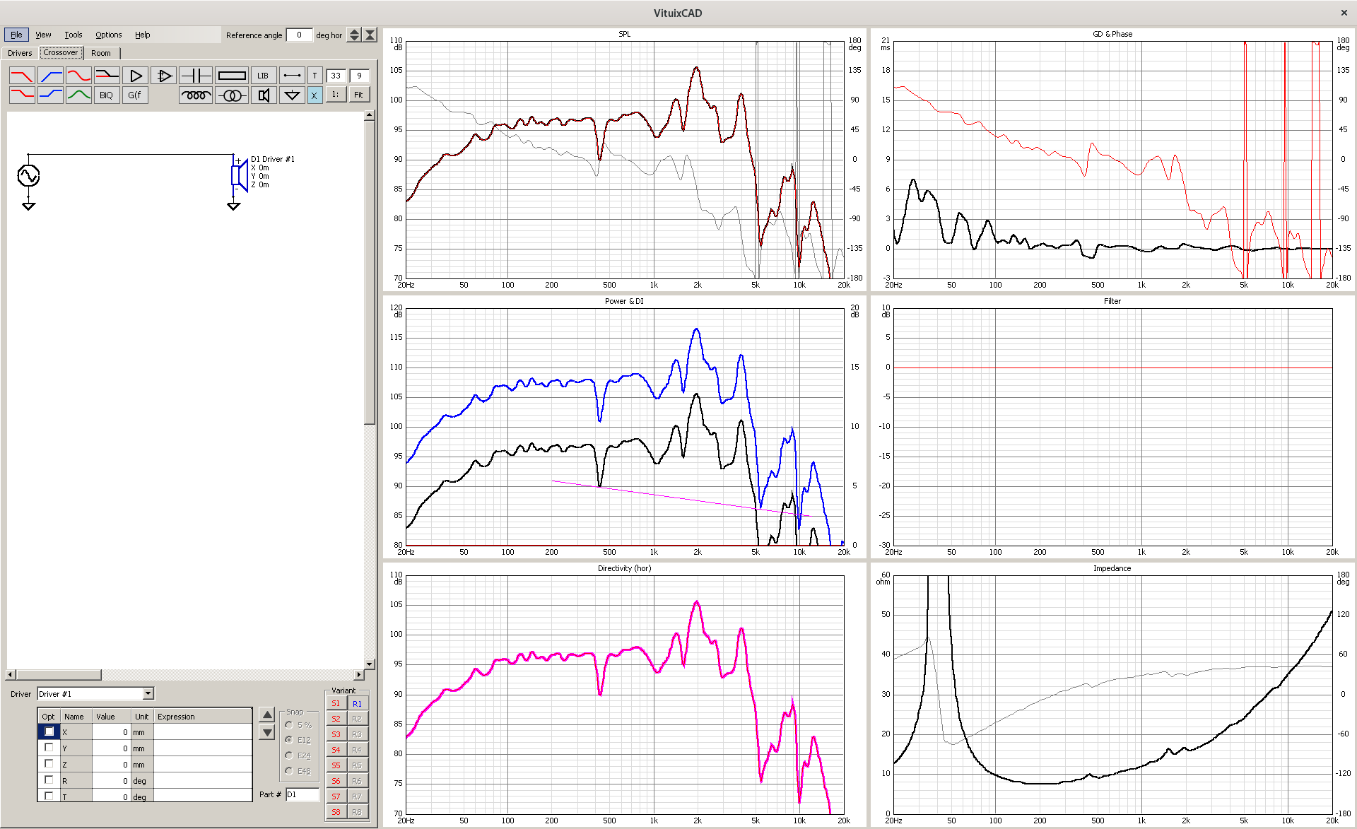

I used wine to run VC. I did some traces and the frequency looks to be off.
