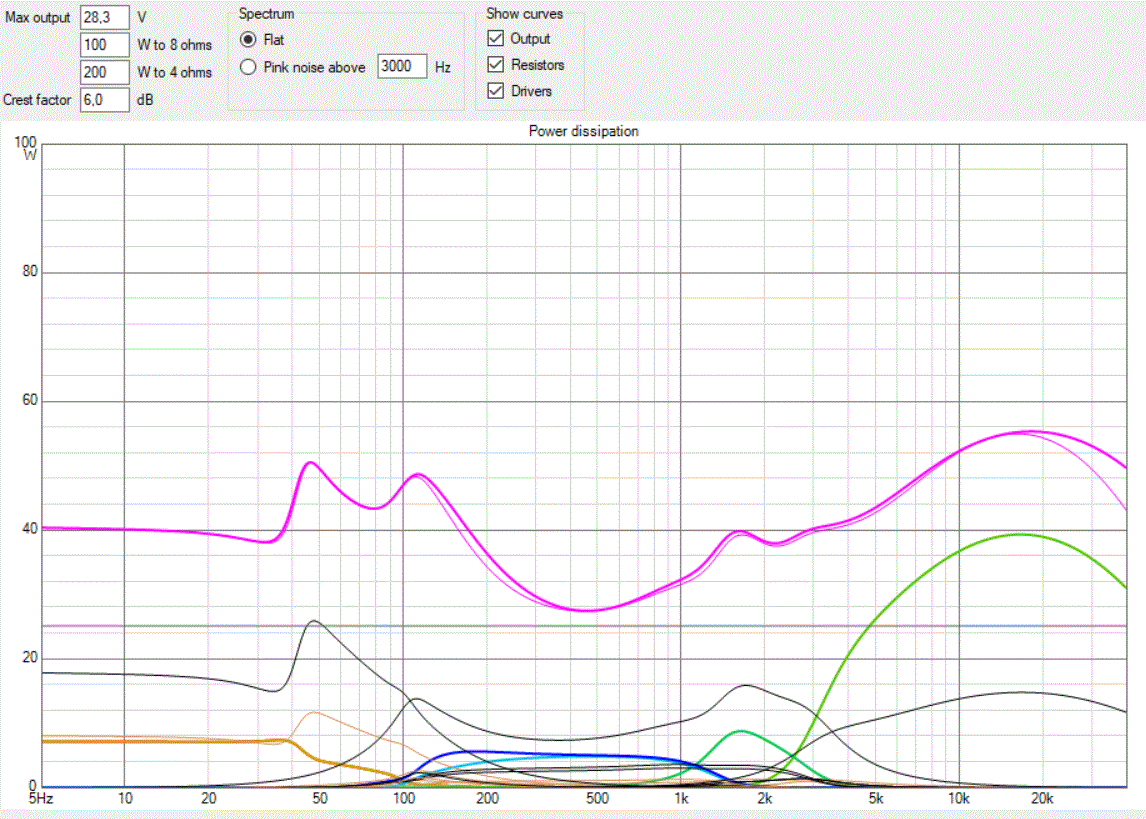

Hi kimmosto,
I need some help interpreting the power dissipation graph.🙂

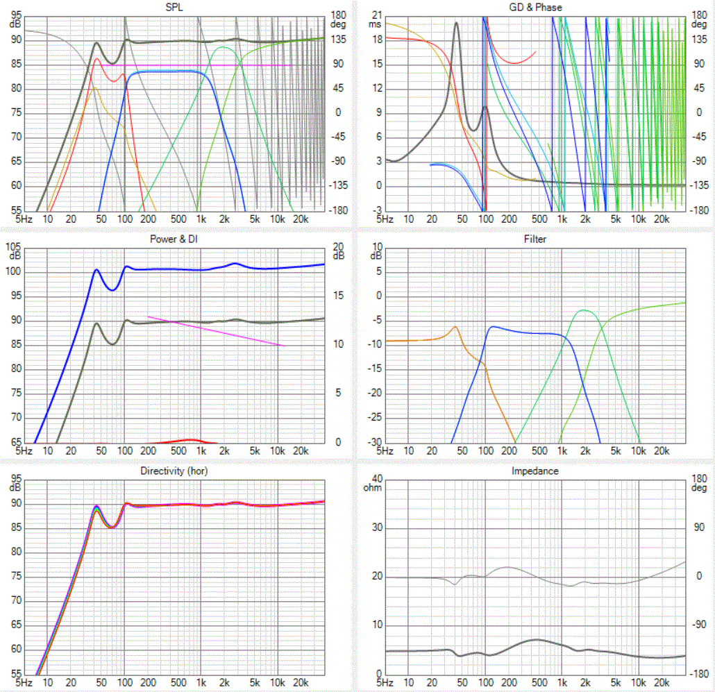

Playing with Vituix, I came a up with a design that looks like the following (no idea how many mistakes you can see here, see attachments).
1) Is it normal that there is a lot more power in the tweeter than in the other drivers ? With pink noise, this goes down a lot (the tweeter peak is reduced to 13.8W) but there is still a bit more power than in the other drivers.
2) the maximum power in each driver should never go above the maximum "programme" power rated by the manufacturer, am I right ?
3) same thing for the resistors ?
