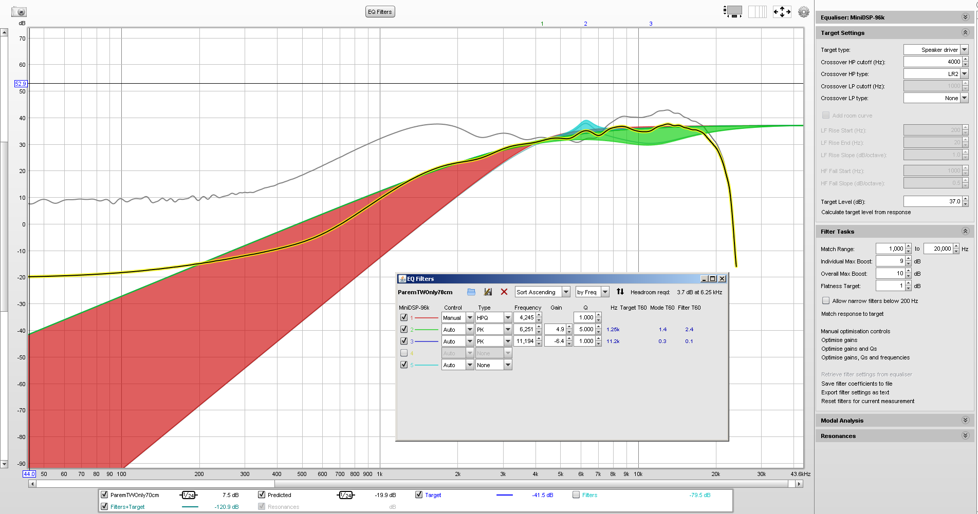

Actually biquad optimization is more complicated than measurement summing.
How is possible to define min and max limit for biquad coefficients in optimization? Usually coefficients cannot be bigger that +/-1 or +/-2 depending from coefficient.
I tested it on tweeter where I had 2 biquad sets for HP filter, 1 set for low shelf and 1 for peaking EQ, based all on MiniDSP Biquad calculation xls sheet.
Optimizing of all 4 biquad sets together make no sens, I get big mess. Also optimization of one biquad set make no things better. Only optimization of one coefficient in biquad set make some sense, but also difficult to get result.
Or this kind of optimization in real life is not possible, as type of filter represented by biquad can be changed during optimization. Opposite to passive component filter where type of filter or component (capacitor or inductance) is not changed, only component value is changed.
I have got some results with single biquad (all coefficients optimized), but as already mentioned, initial situation should be close to get any better than original. Also frequency range should be carefully set, not too wide or narrow.
Component/block parameters have internal constraints but they are not yet enabled and shown in the program because usually they just make working more difficult and slow. Manual adjustment becomes faster when number of configuration parameters increases. I agree that constraints would help with biquads, but I don't have enough faith to test it. Changes to get decent result quickly are close to zero, with or without constraints.
I trust more traditional methods; using and optimizing blocks with f, Q and gain parameters.
^Yes. Selected 1st-2nd order generic active block can be converted to single biquad block by clicking BiQ menu button with Ctrl-key pressed. 3rd...8th order generic active LP/HP blocks need 2...4 target biquad blocks. Select source block, Copy Biquad coefficients command from context menu, select target biquad blocks and Paste Biquad coefficients command from context menu. DSP system with correct sample rate should be selected before this operation to get correct coefficient values. Not so difficult imo.
If you have miniDSP, you can convert parameters of selected generic active blocks to biquad coefficients with Copy Biquad coeffs command in context menu, and paste from clipboard to Advanced filter view in miniDSP application. That is recommended procedure because allows keeping generic active blocks in your VituixCAD project, optimizer working and manual adjustments possible for human. Converting generic active blocks to biquads in VCAD schema is one-way procedure which can be reversed with Undo only.
This is good, little like REW, but it can not optimize 2 or more way DSP filters for speakers. I had no miniDSP, it is actually active speaker with STA350 amp using embedded DSP, but biquad mathematics behind is same.
Room response EQ and speakers designing are two different tasks no matter how many ways. Directivity features can be included in optimizing process also with single driver full range (should be included with multi-way). Designer should be at least aware of power & DI and other off-axis features before making decisions for room response EQ or let some application make decisions for him/her (which is modern but not so smart).

I mean similar is optimization with "blocks with f, Q and gain parameters". Sure speaker design and room correction are totally different things. Still, if not counting directivity, then for on-axis response only for speaker designe optimization also REW can be used with not bad results.Room response EQ and speakers designing are two different tasks no matter how many ways. Directivity features can be included in optimizing process also with single driver full range (should be included with multi-way). Designer should be at least aware of power & DI and other off-axis features before making decisions for room response EQ or let some application make decisions for him/her (which is modern but not so smart).
"If not counting directivity" is not proper design approach so any tool which cannot handle off-axis and total power in invalid for this job 😉

Only for some loudspeakers directivity information is not available, you can measure it after you had bought loudspeakers and cannot change its dierctivity after you get it on hands.
I add also image how I made optimization in REW. Grey line is measured tweeter on-axsis response (2 ms gated from 70 cm, Neo X2.0, little disappointment for me, on datasheet bump on 12 kHz is about 5 dB, in real it is about 12 dB), black with yellow is optimized result, filter blocks and target are described on image. I only defined my target response and HP filter manually, rest are all automatically generated by REW. It can also generate more blocks with f, Q and gain, depending from physical EQ device type selected and filter task parameters. "Save filter coefficients to file" in REW give biquads in text format.
