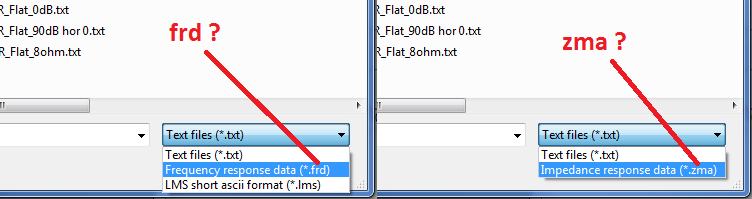

Hi...new VituixCAD user here. I use DATS to generate .ZMA files and Omnimic to generate .FRD files. In V2, those file don't seem to work. They did in V1.1. Are they supported in V2?

V2 reads and writes "standard" txt/frd/zma files so there's nothing specially for DATS and OmniMic. Only formats having something unique are LMS short ascii and Klippel.
Could you send few example files?

One could image real problem is you can't see them in browse window, if that's the case then shift button down in lower right corner to same format as expected : )

Just in case you missed these bits:
- To generate any signal, you must first connect the source with the driver in the crossover tab. The connecting line will go green;
- The frequency response files must be saved as "XXbass_hor_deg_00.txt" in Omni. This is in case of on-axis measurement, for other angles you will replace the 00 with the appropriate angle value.
- The impedance file should be good as it is (once the driver is activated...)
Hope this helps.
^Yes, missing XO was the problem already solved via e-mail.

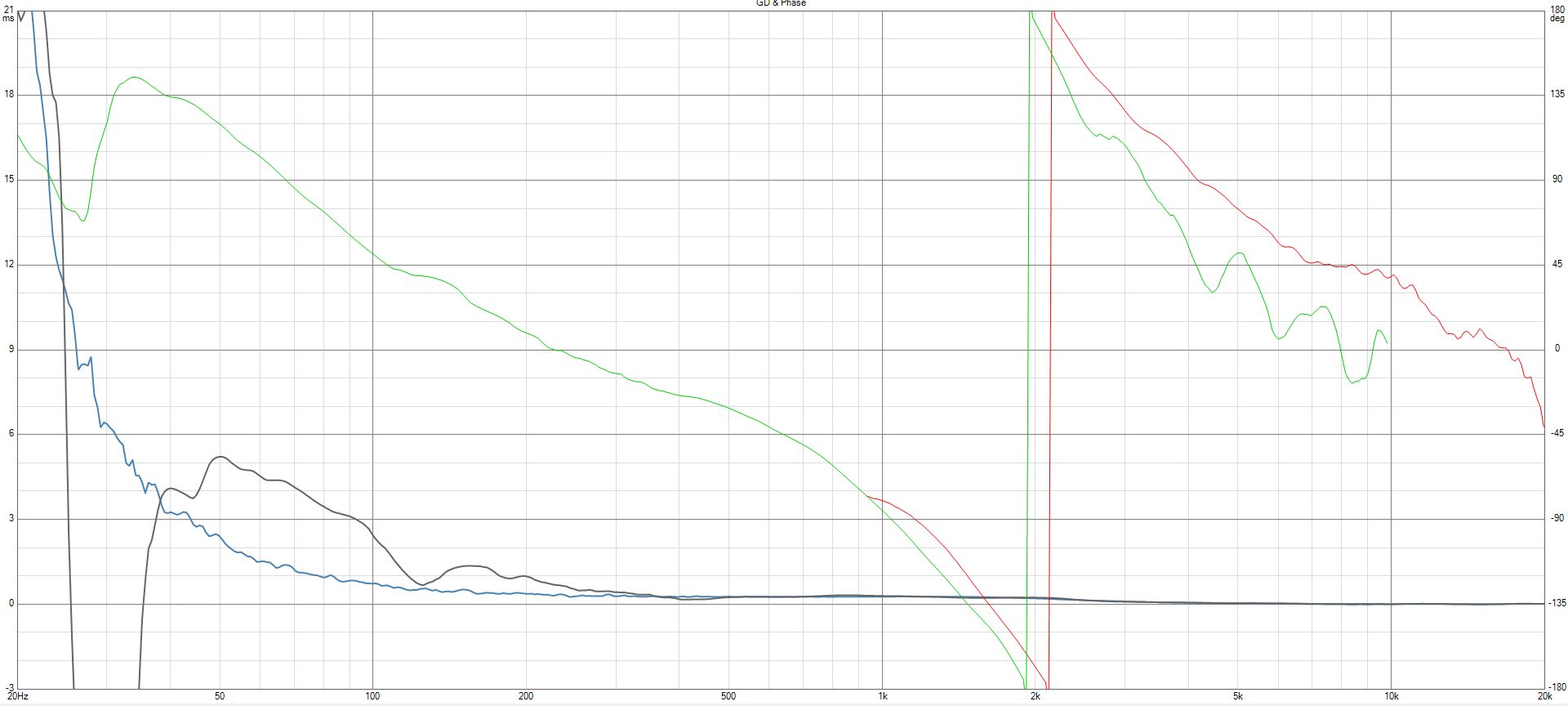

^Steel blue in GD & Phase chart is 'Excess group delay' of total response to reference angle. The same color in SPL chart is 'Excess phase'.
Hello kimmosto,
What does the lime green line "minimum phase" represent in a crossover design?
Thank you,
David.
Opps, asked about wrong colour...
