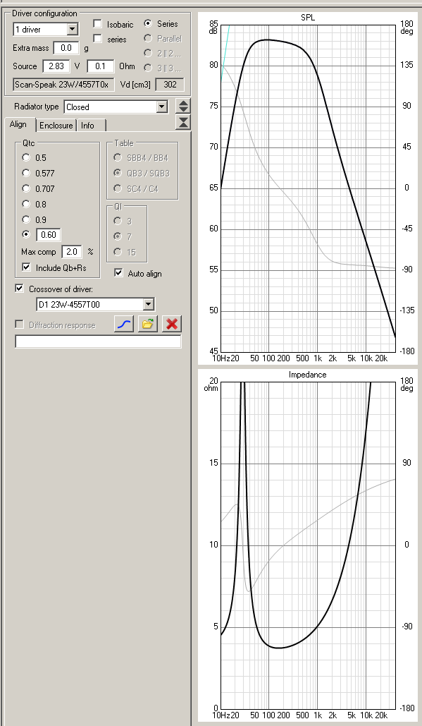

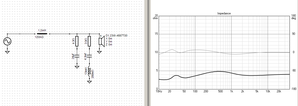

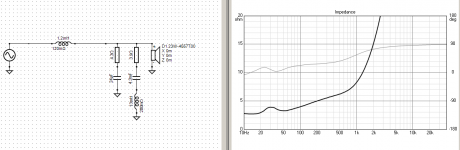

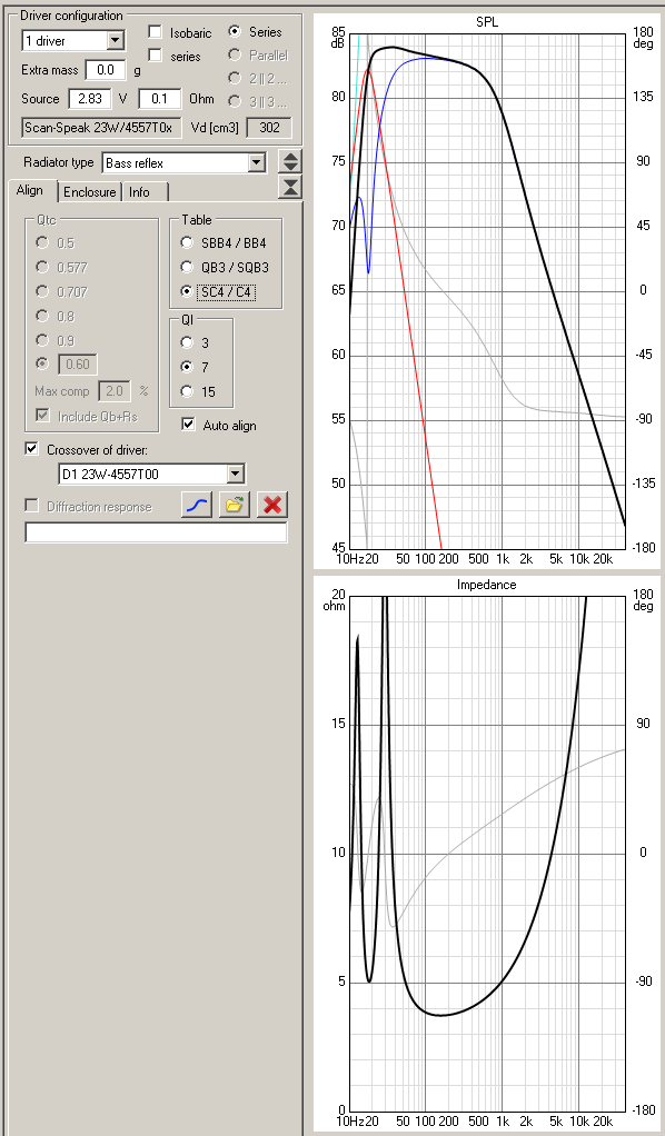

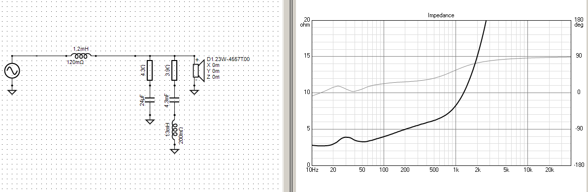

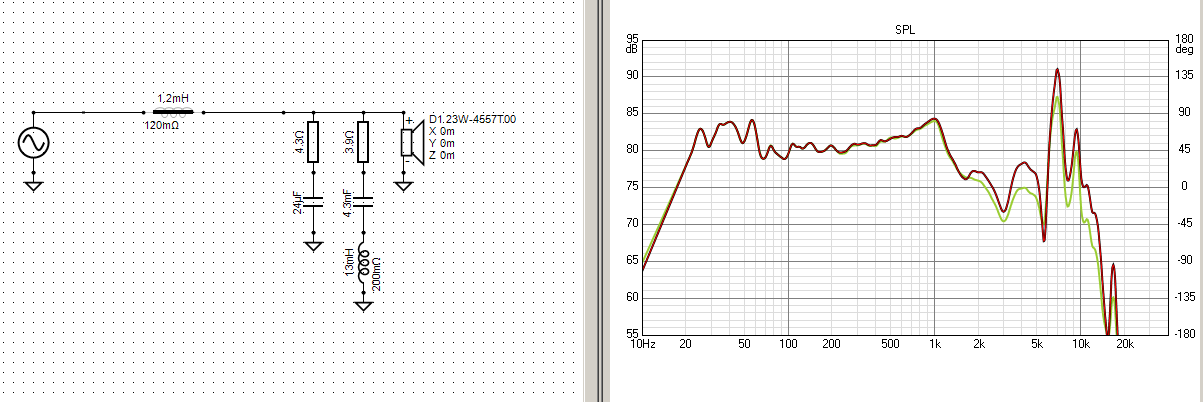

Hi, just a question on how the 'crossover of current driver' and 'feed speaker' boxes are meant to work.
Just for a test I've made a single-driver subwoofer and taken some screenshots (attached).
First I calculate my impedance-matching RC and RLC networks for the driver in free space in the main window, then add in a single coil for a first-order LPF (it ain't great nor realistic, but it's good enough for now).
So that's fine, the impedance, filter, and SPL plots change in realtime as I tweak values.
Now I open the Enclosure Tool, and select 'Crossover of Driver'. The SPL graph (in the Enclosure window) changes to account for my LPF coil, which is good.
The impedance graph (in the Enclosure window) changes depending on whether I choose closed or vented, but tweaking the values of my RC and RLC circuits does nothing.
Neither does the single-peak of closed, or double-peak of vented, impedance spikes translate back into the main window.

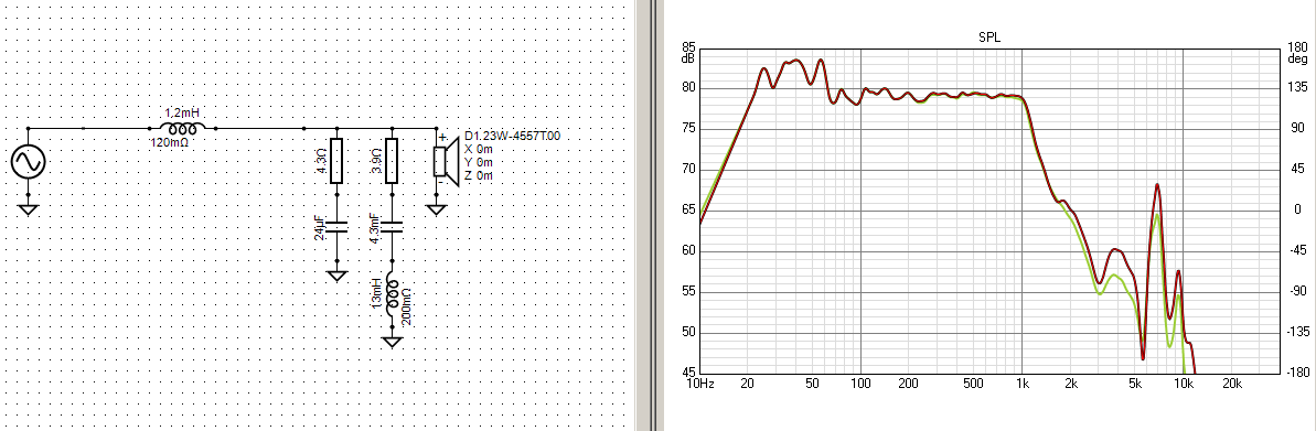

Changing the values of my LPF coil makes the SPL graph in the Enclosure Tool window to change, which is good.
Changing the enclosure type or tweaking box/vent sizes also makes the SPL graph in the Enclosure Tool window change.
But this doesn't then feed back into the SPL response in the Main Window (neither with 'feed speaker' checked nor unchecked).
In short, I want to do 2 things.
1: compensate impedance of the driver in the box, not just driver in free space.
2: see overall response of driver-in-box, not just response of driver in freespace and theoretical box-response separately.
How do I do these in real time? Do I have to do something like export and merge or something each time I make a change?
It is meant for checking excursion and power requirement with active crossover with some bass boost filtering such as Linkwitz Transform or Peaking EQ.
This feature is not so important with passive crossover because those parameters can be checked without crossover, and box dimensioning with Enclosure tool is done way before measurements and crossover designing with the main program. Recommended design procedure is visible in user manual, section "Checklist for designing a loudspeaker" beginning on page 4. Working with Enclosure tool is items #3...#4, and designing crossover with the main program is items #17...#24, probably few weeks later.
BUT if someone is willing to play with combination of simulated driver+enclosure system and passive crossover, impedance response should be fed from Enclosure tool to driver selected in Drivers tab of main program manually every time when impedance curve changes by checking Feed speaker, clicking Impedance button, and so on. So feeding impedance response back to main program is NOT yet automatic function such as feeding filter transfer function from crossover to Enclosure tool.
Workaround done for direct ZR link from Enclosure to main. This is probably just confusing cheap trick, but allows e.g. enclosure adjustment without repeated manual exporting of impedance response to main program as txt/zma file. Not recommended method for daily use, but available for some special needs.
Rev. 2.0.18.2 (2019-05-24)
Enclosure
* Impedance response is copied from Enclosure tool to selected driver in the main program if 'Crossover of driver' is checked in Align tab. Copied response is temporary in memory until impedance response is read from file again, for example due to scaling.
